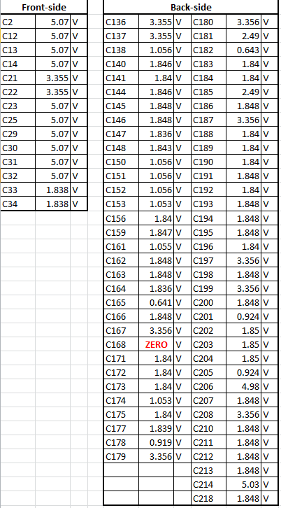

Ok,
I made the measurements according to the indications. It took me ONLY an hour and a half to finish the trick...
I hope I did not have a mishap, again :D ...
The second part, the one with the measurements on these small IC's, I hope to finish it tomorrow...
 Post subject: Re: SanDisk X100 256G no BIOS detection
PostPosted: June 13th, 2018, 17:55
Posts: 17101
That's a lot of work.
The three main supplies appear to be present -- 1.8V, 3.3V, 1.05V.
I don't know why C168 is measuring 0V. In fact I don't understand what it does.
ISTM that the problem is most likely in the firmware, not in the hardware.

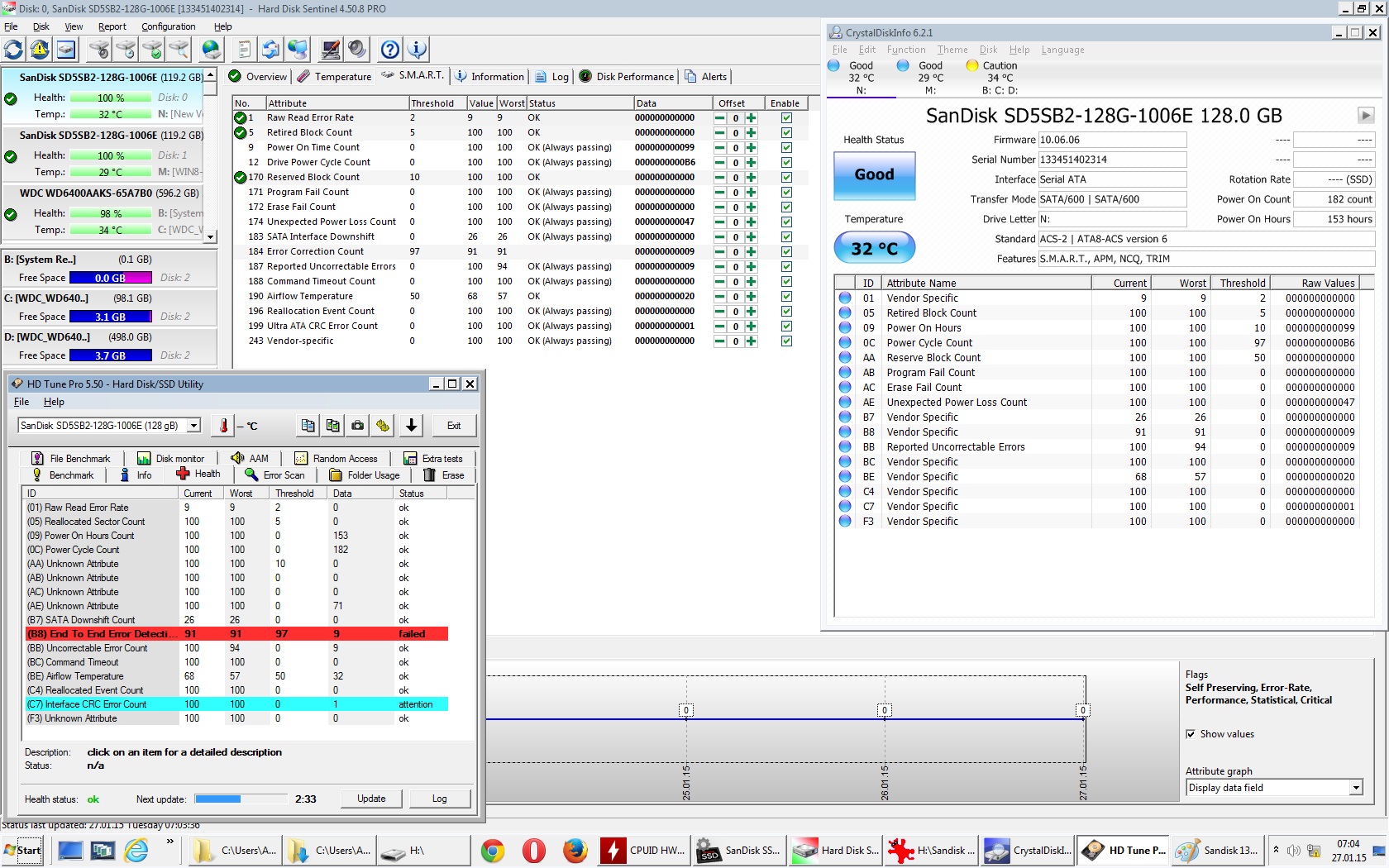

Interestingly, there are 788 views of the measurement table in less than 24h :shock: :). I'm curious how long I will take to measure all ICs :roll:
In other news, I made SMART captures to all SSD with the initial error I bought it and I'll post them as soon as I find them.
Perhaps someone can make a connection between the type of error and the apparent lack of voltage on this capacitor.

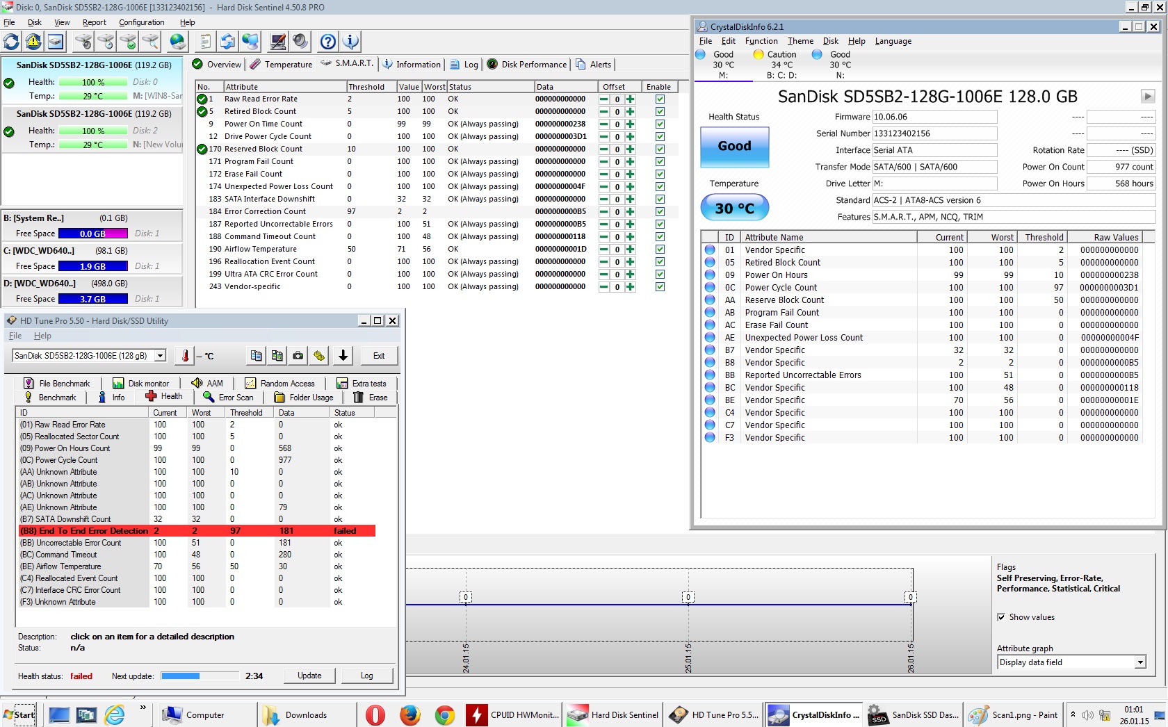

Wow, I remembered that I have some captures in the cloud :).
The SSD with SN 133123402156 is the subject.
PostPosted: June 14th, 2018, 17:09
Posts: 17101
ISTM that your SSD was already showing signs of problems with SMART attributes 184, 187 and 188. AFAICS, that would be consistent with your current firmware (?) problem.
