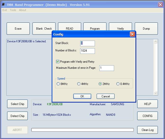

I appreciate all your willingness to help. Nevertheless i would prefer to do the dump myself as i no longer want to be dependant of other's equipment and to avoid further delays as well as to avoid possible courrier loss. What do you guys think about the TNM5000? Do you think this programmer is able to read this nand as required? What are the configurations that i need to be aware of (page size, volts, spare size, etc...)?

i'm not familiar with this programmer, but it says here that your chip is supported

i really hope your chip is been supported
because i don't know how 1024 blocks (c the pic. attached with original configurations) end up with the size of 16MB, if page size supposed to be 528
as written above
Instead it should be ...
512-bytes from page #0
16 ECC bytes from page #0
512-bytes from page #1
16 ECC bytes from page #1
512-bytes from page #2
etc
& i can't find where it (page size) can be changed
