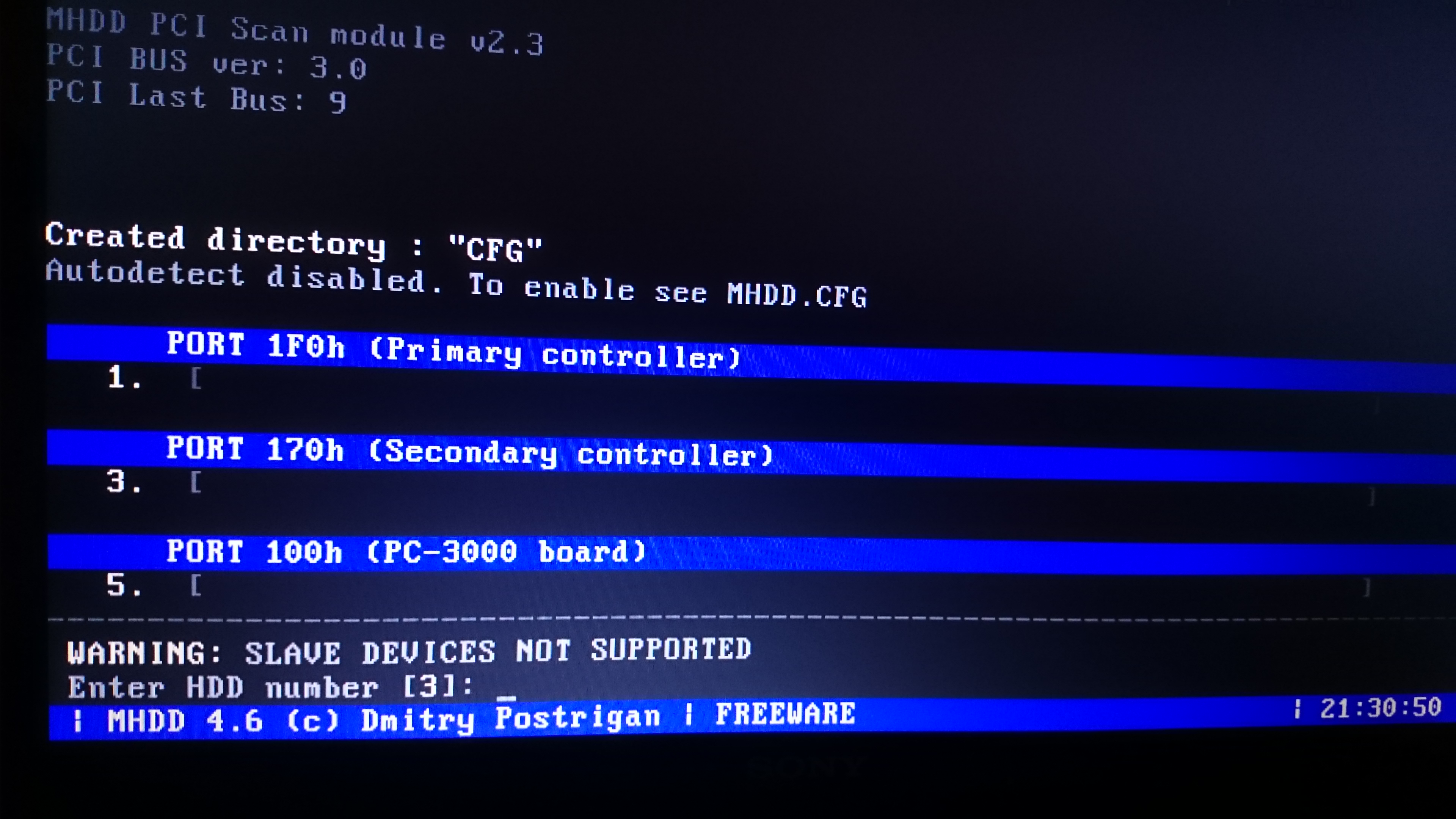

Following, I set the boot mode to Legacy. I used MHDD and the SSD was not identified at all (not primary, nor secondary master, nor PC-3000). I have tried to search for it and every time I received the error: Drive not ready.

Yes, post a picture of the status register for confirmation, please. Edit: over USB, yeah - does not matter, nevermind.

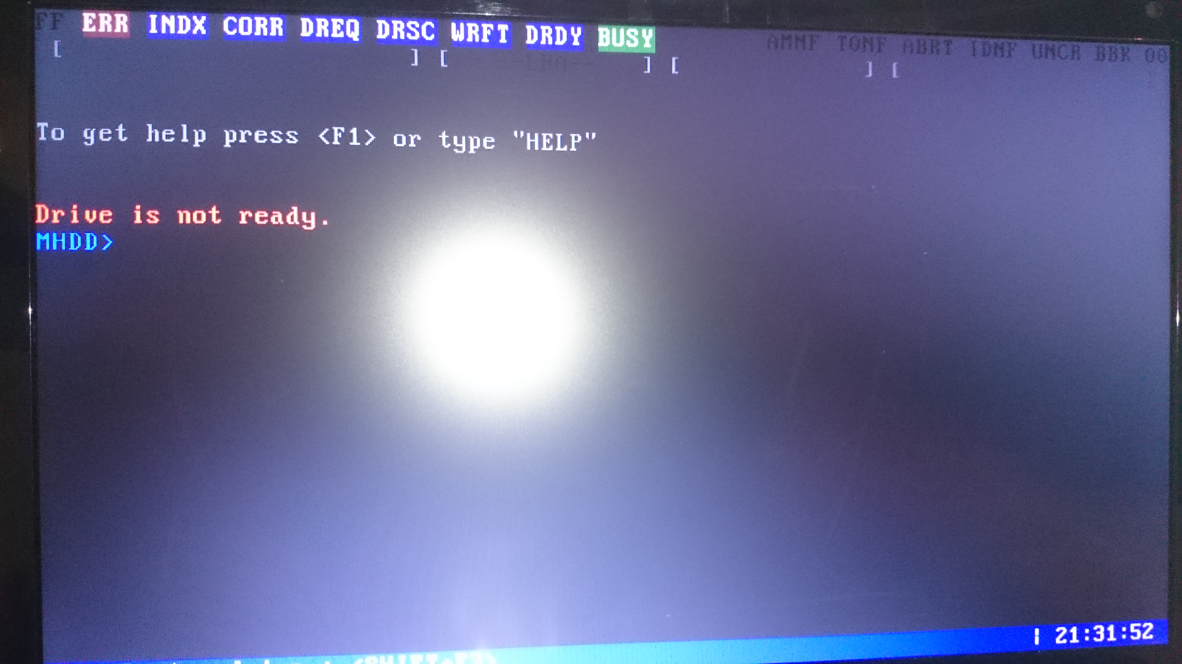

Below are the 2 pictures from MHDD...I only get Drive not ready regardless of what I try...

It won't detect anything in AHCI mode.
 Post subject: Re: Toshiba Q300 unresponsive
PostPosted: April 25th, 2016, 15:23
Looks like it just stays busy, not sure about the error register being lit up. So, yeah, seems like controller issue.

Hello, I have now successfully set SATA Mode Bios to IDE in Bios and MHDD does not detect the drive at all.
I still get the in MHDD the message: Drive is not ready.
Any ideas?...
Any ideas?...
That's because as we already posted a few times: the drive is not going to allow access over SATA/ATA! It's broken.
The only way to get anywhere is via a serial port, which sadly I haven't gotten in to, either because it's not active or because it requires special activation.
