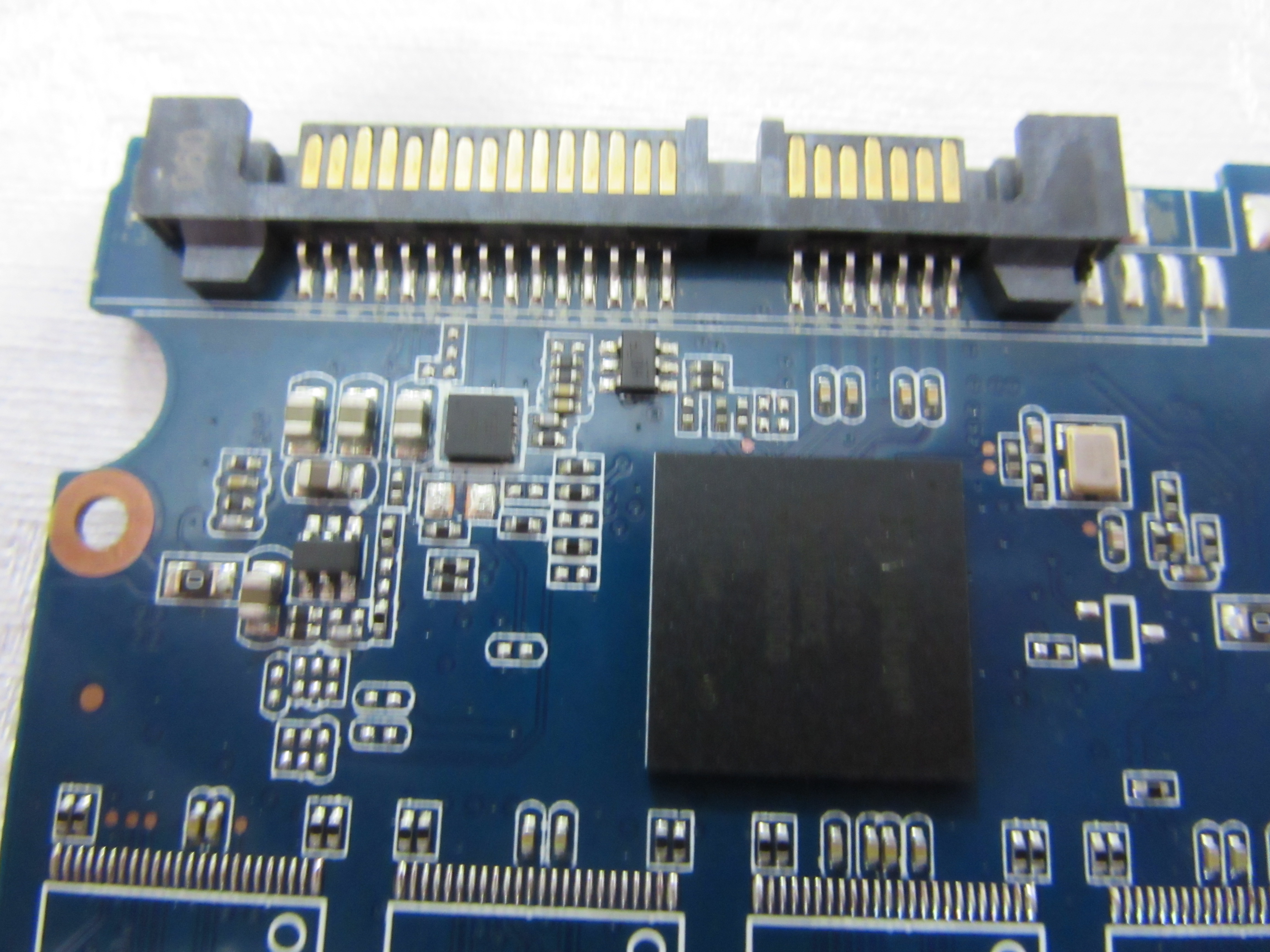

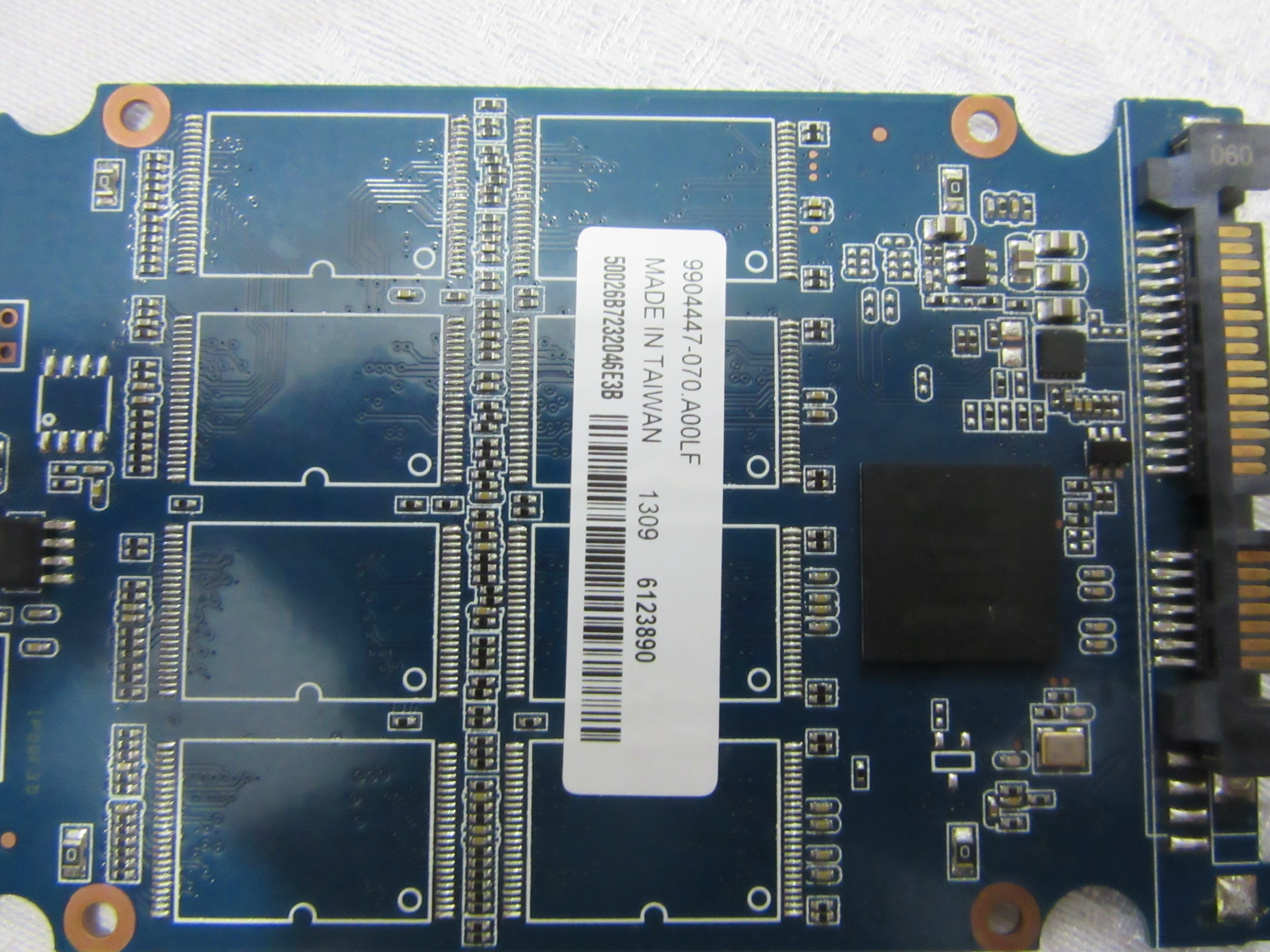

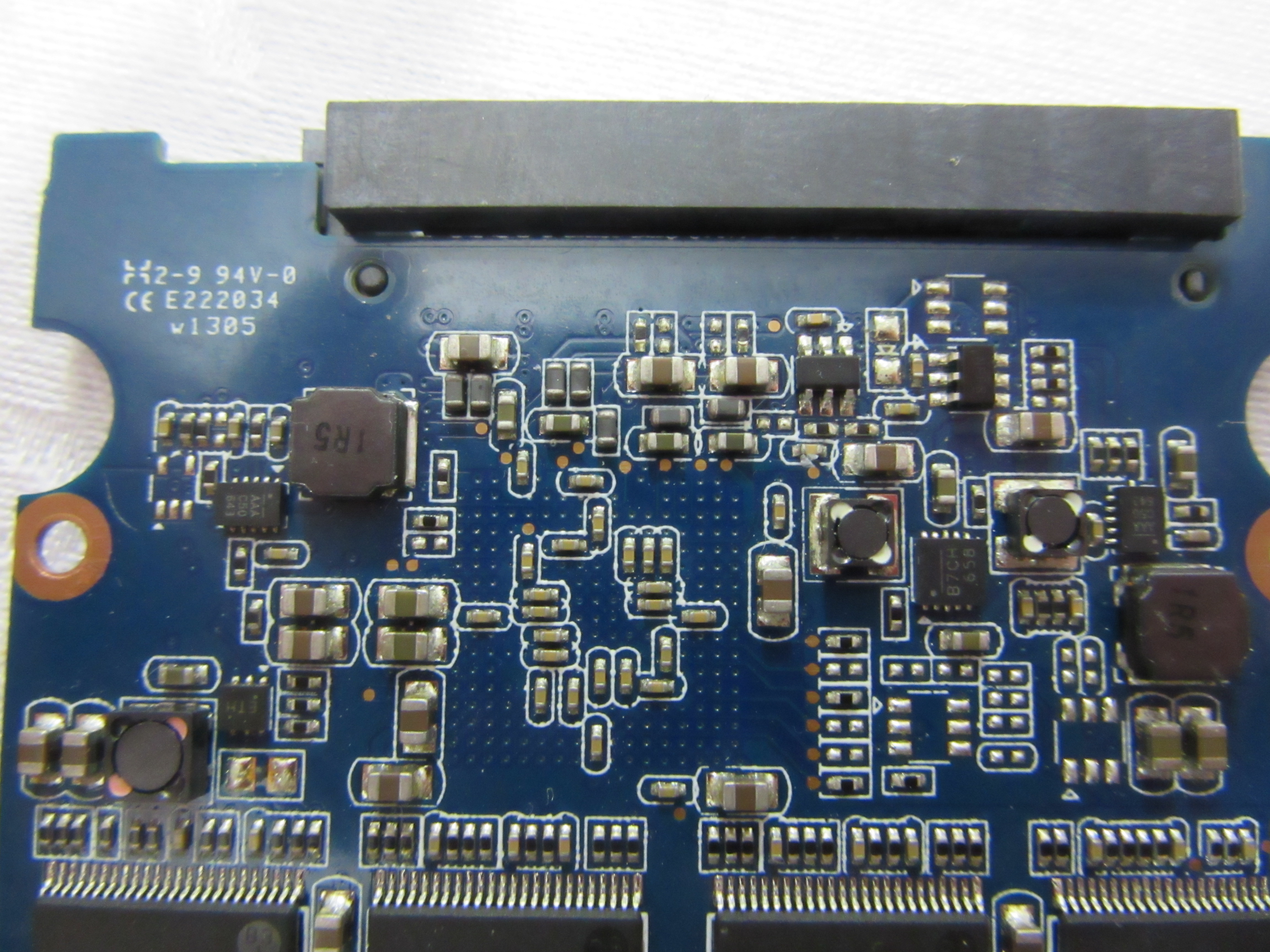

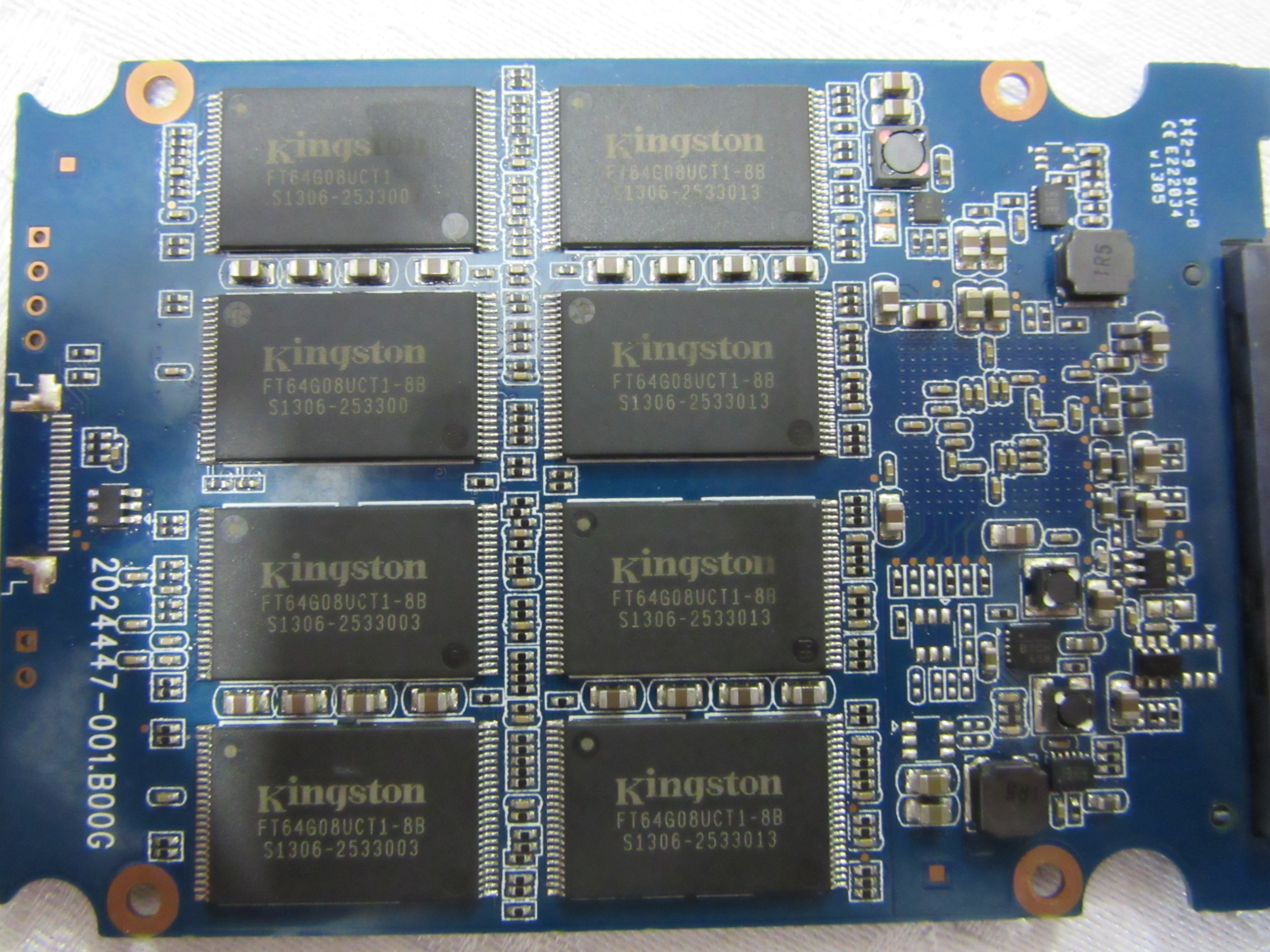

I was able to put my hand on an 120GB Kingston, but it has A totally different PCB
but I have found a 60GB which is "almost" identical, will it work to compare measurements?
 Post subject: Re: Kingston SSDNOW 300 Case Opening
PostPosted: May 14th, 2018, 18:42
Posts: 17256
It looks similar -- different ICs but probably similar output voltages. There is one additional regulator on the 60GB version near the screw hole on the flash side.

here are the measurements
on 60
5Vin OK
5Vout OK
resistance 5Vin to ground 6.90 "K"ohm (get noting (0L) when measured on 200 ohm)
resistance 5Vou to ground 16.18 "K"ohm (get noting (0L) when measured on 200 ohm)
resistance 5Vin to 5Vout 21.80 "K"ohm (get noting (0L) when measured on 200 ohm)
V1 = 5.02V resistance = 16.21 "K"ohm (get noting (0L) when measured on 200 ohm)
V2 = 2.84V resistance = 5.35 "K"ohm (get noting (0L) when measured on 200 ohm)
V3 = 1.00V resistance = 0.465 "K"ohm (get noting (0L) when measured on 200 ohm)
V4 = 2.85V resistance = 73.30 "K"ohm (get noting (0L) when measured on 200 ohm)
on 240
5Vin OK
5Vout OK
resistance 5Vin to ground 6.58 "K"ohm (get noting (0L) when measured on 200 ohm)
resistance 5Vou to ground 21.60 "K"ohm (get noting (0L) when measured on 200 ohm)
resistance 5Vin to 5Vout 24.27 "K"ohm (get noting (0L) when measured on 200 ohm)
V1 = 0.14V resistance = 0.3 ohm
V2 = 0.00V resistance = 0.3 ohm
V3 = 0.23V resistance = 0.4 ohm
V4 = 0.00V resistance = 0.3 ohm
any thoughts ?
PostPosted: May 14th, 2018, 20:59
Posts: 17256

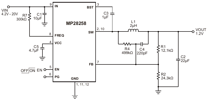

The rule of thumb for switchmode step-down converters is to locate the junction of an inductor and capacitor(s). That's the output voltage test point. Either measure the voltage across the capacitor, or measure the voltage between the inductor and ground.
See http://www.hddoracle.com/viewtopic.php?f=59&t=231#p=16236
Your measurements would suggest that V3 is the Vcore supply for the flash controller. That's bad news. :-(
As for V1, measure the voltage at the 1R5 inductor.
I can't identify the B7CH part, but it appears to be a dual step-down converter made by Monolithic Power. The other ICs are as follows:
MP28258DD, Monolithic Power, 3A, 4.2V - 20V Input, Synchronous Step-down Converter, marking AAA, QFN12:
https://www.monolithicpower.com/pub/media/document/MP28258_r1.14.pdf
RT8010GQW, Richtek, 1.5MHz, 1A, High Efficiency PWM Step-Down DC/DC Converter, 2.5V to 5.5V input, marking ET, adjustable, WDFN-6L:
http://www.richtek.com/assets/product_file/RT8010=RT8010A/DS8010A-10.pdf
