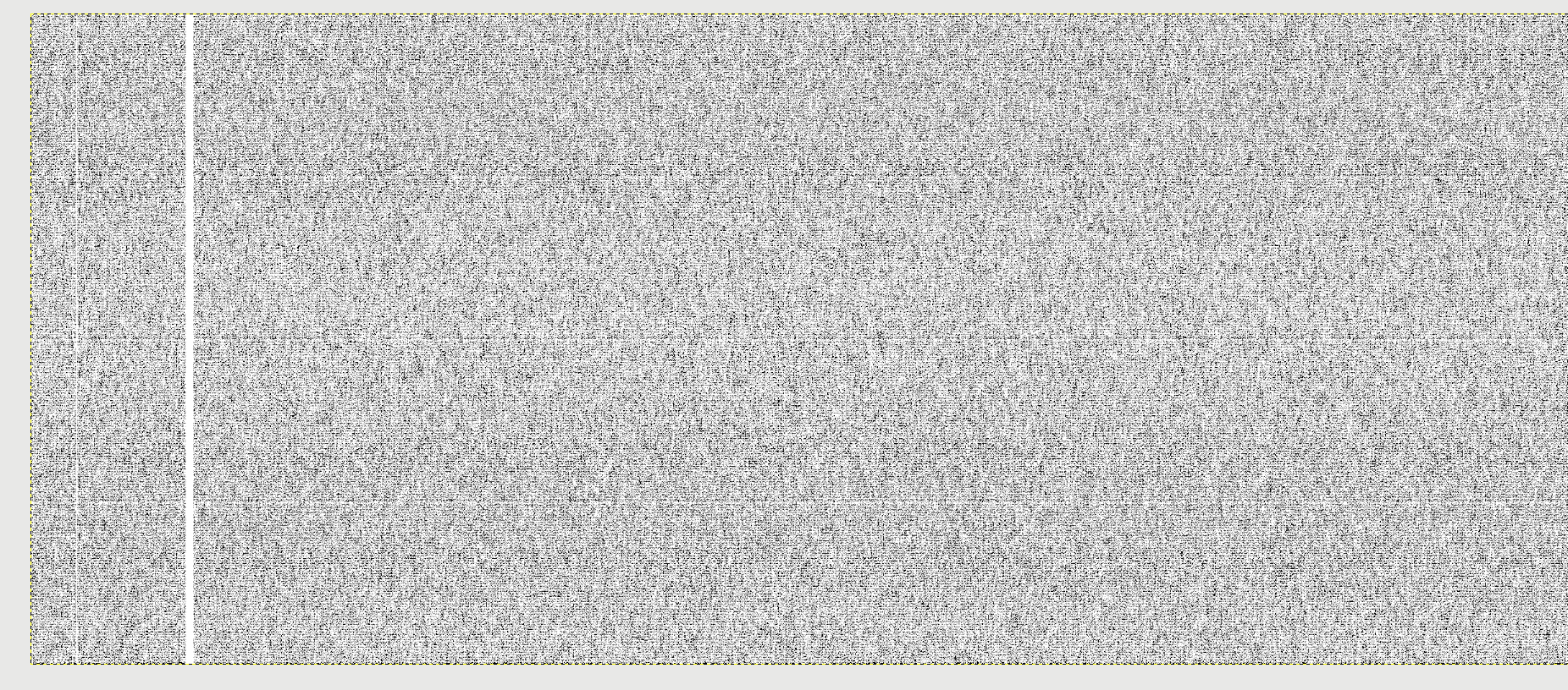

Dump of blocks 2048/2049/2050/2051 (begin part of the blocks)

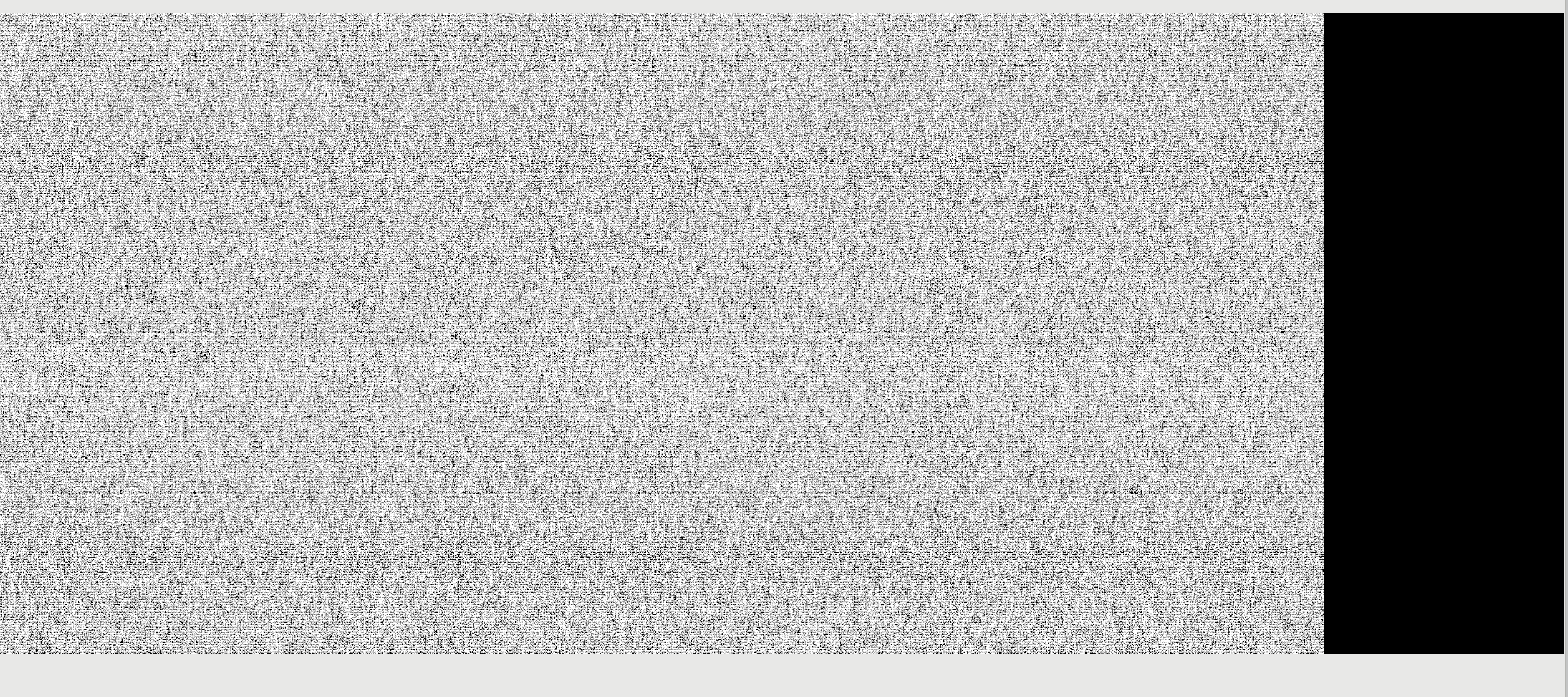

End part of the block :

We can see block separation, and there are at the beginning of pages :
- 1 bit always 0
- 12 bits always 0
And 48 bytes of 0xFF at the end.
I though the always zero bits can be bad columns, but that's very curious because these potential bad columns are same in the 2 planes of the first chip (CE0), but also the same in the 2 planes of second chip (CE1) !!
Seems everything is Xored (data+spare areas) !?

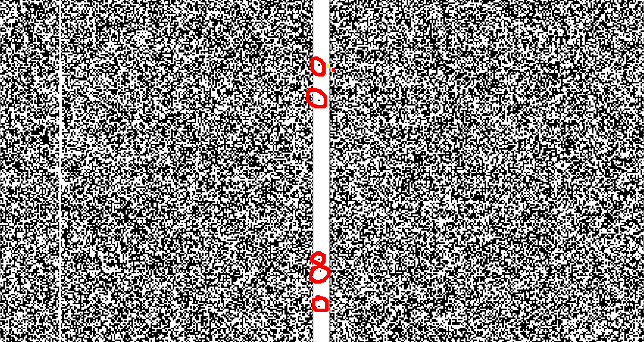

I have some bad bits in the dump :
But I think the dump quality is good, because the white column is 12 bits wide, and on a dump sample of 8192 pages, thus 98304 bits, I counted only 89 bad bits (0.00091%)
If I'm not mistaken, the 70 bytes ECC for 1024 data byte (total 8752 bits) can correct up to 40 bit errors, thus up to 40/8752 = 0.004%

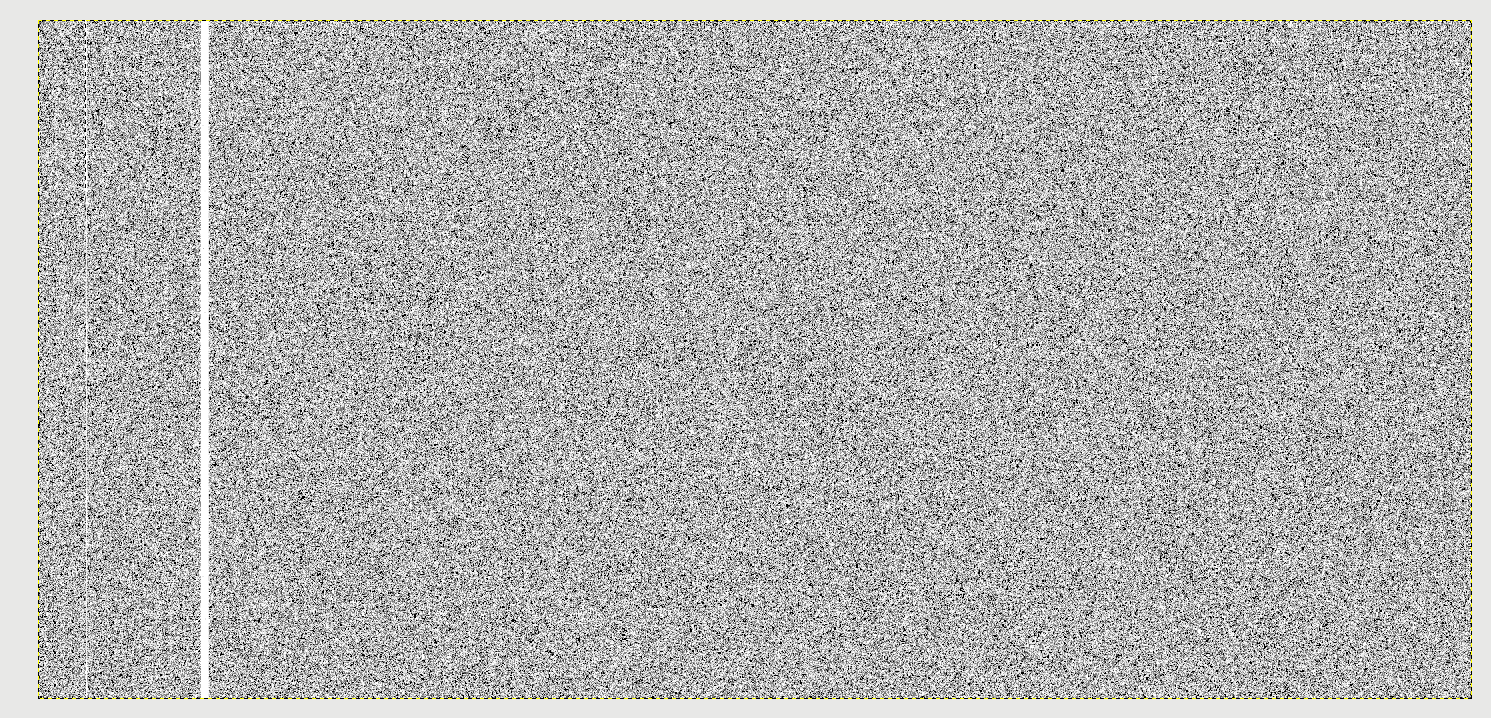

Which noice ?
Looked on other blocks for example, here 4 block :
Maybe SA is not good and has no sense because page are mixed, but I see no difference with some tutorials which explain data recovery ?
