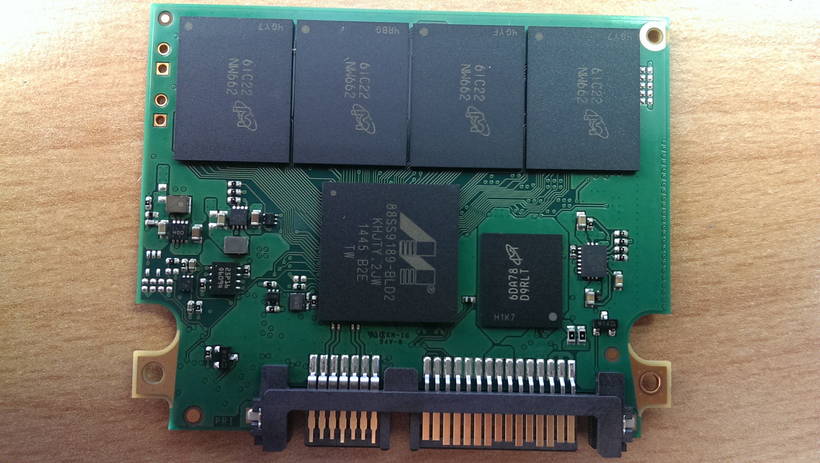

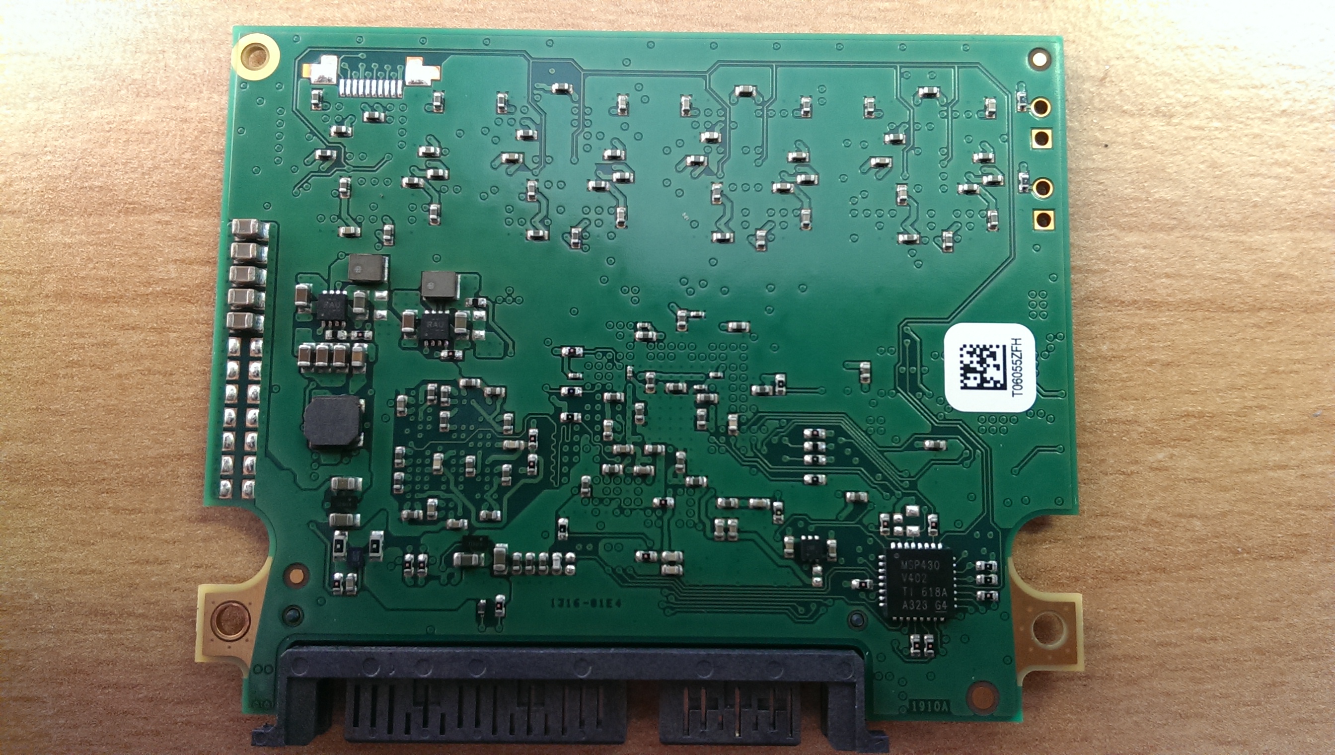

A bit late but here's proper scans of the board: http://imgur.com/gallery/uz400
Yes they're different models, but they have quite some similarities, i.e. the RAU chips in the same places: http://images.anandtech.com/doci/7864/DSC_5269.jpg
And the rear: http://images.anandtech.com/doci/7864/D ... 1470344694
MSP430 in the exact same spot. Very similar layout. Worth a shot?
Nevermind, that's the M550 and not the M4. I'll stick with a MX100 model.

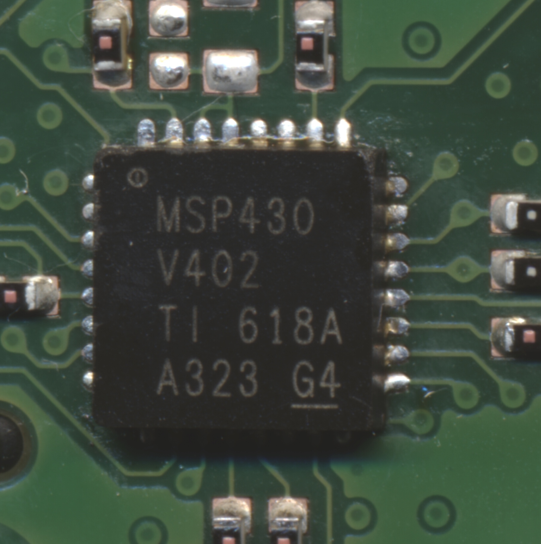

Ugh, I expected more!
 Post subject: Re: Crucial MX100 repair after PSU failure
PostPosted: August 10th, 2016, 15:52
Posts: 17323
The MSP430 is marked "V402". I guess that means it has a different firmware version. I wouldn't trust it. :-(

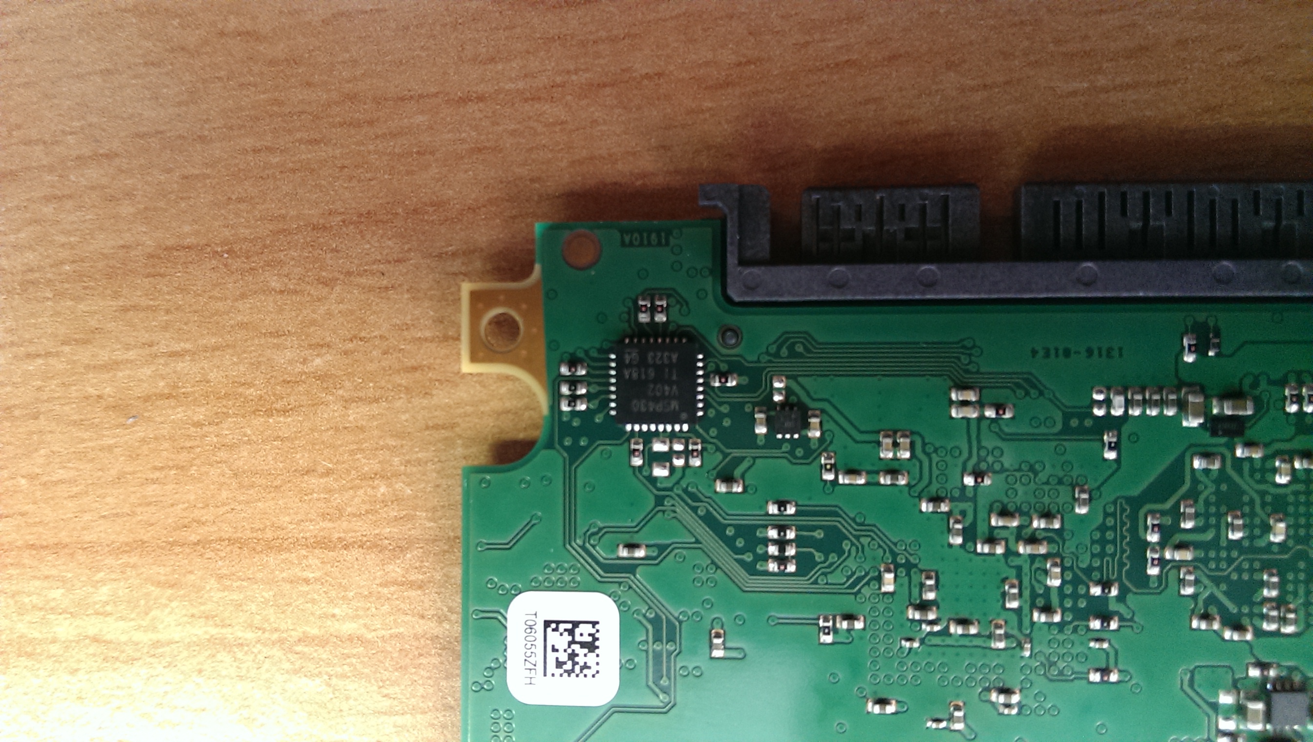

Posts: 44
Location: Nederland
Well, enable pins seemed to match so I performed the transplant. Was pretty confident in the soldering but it didn't work so I opted out of further risking the new 250GB disk. Removed the MSP430 from the dead SSD and placed it back on the new MX200. First try wasn't very good, probably because I didn't perfectly level the pads before soldering and it ended up not being perfectly aligned. I took it off, cleaned the pads, used leaded solder instead and although the result was imho still pretty bad, it didn't look misaligned. Pic attached.
Plugged in the disk and it got recognized, hdtune says all blocks are still fine. So no material gain or loss either for today but at least I've got confidence a replacement isn't too difficult. The search for a proper donor continues..

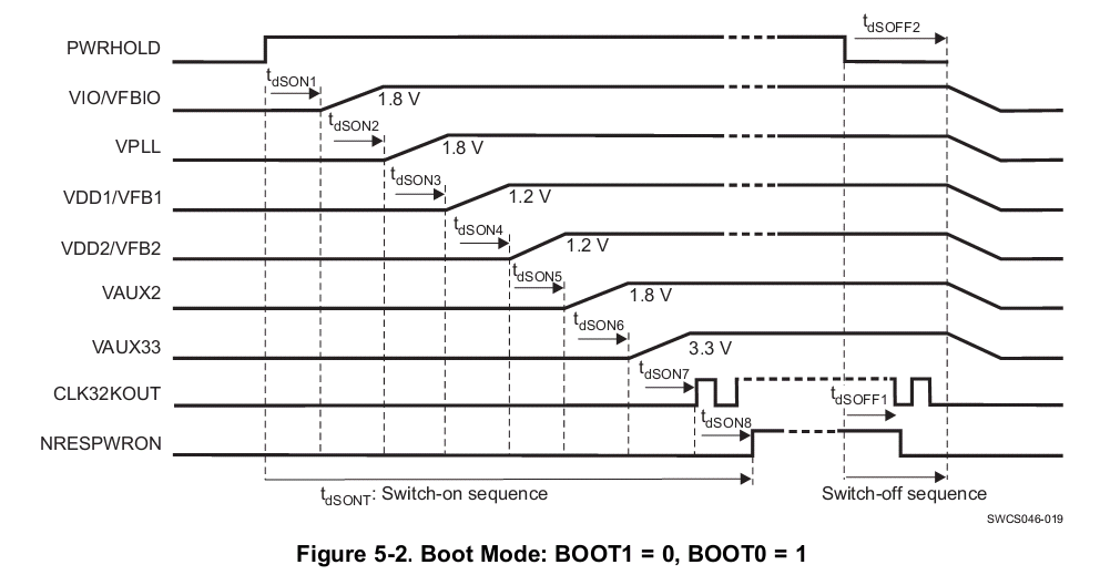

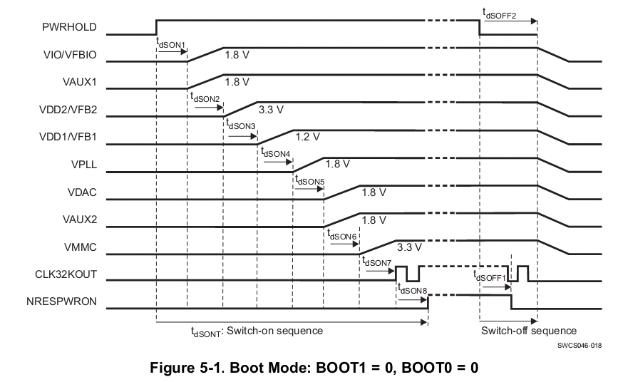

FWIW, I had a look at some of TI's power chips. For example, the TPS65910 is a Power Management Unit (PMU) that integrates several switchmode converters, linear LDO regulators, an Embedded Power Controller (EPC), and an I2C interface for communicating with other MCUs. It would be like integrating the MSP430 (an EPC) and all the regulators into a single chip.
The TPS65910 incorporates several power sequences for different processors, and these are selected via two pins, BOOT0 and BOOT1. The first supply to come up is Vio. After all the supplies are up and running, the chip releases the NRESPWRON signal (active low power-on reset).
Of course this chip is of no use to you in your application, but I thought its datasheet might help to understand how your board works.
