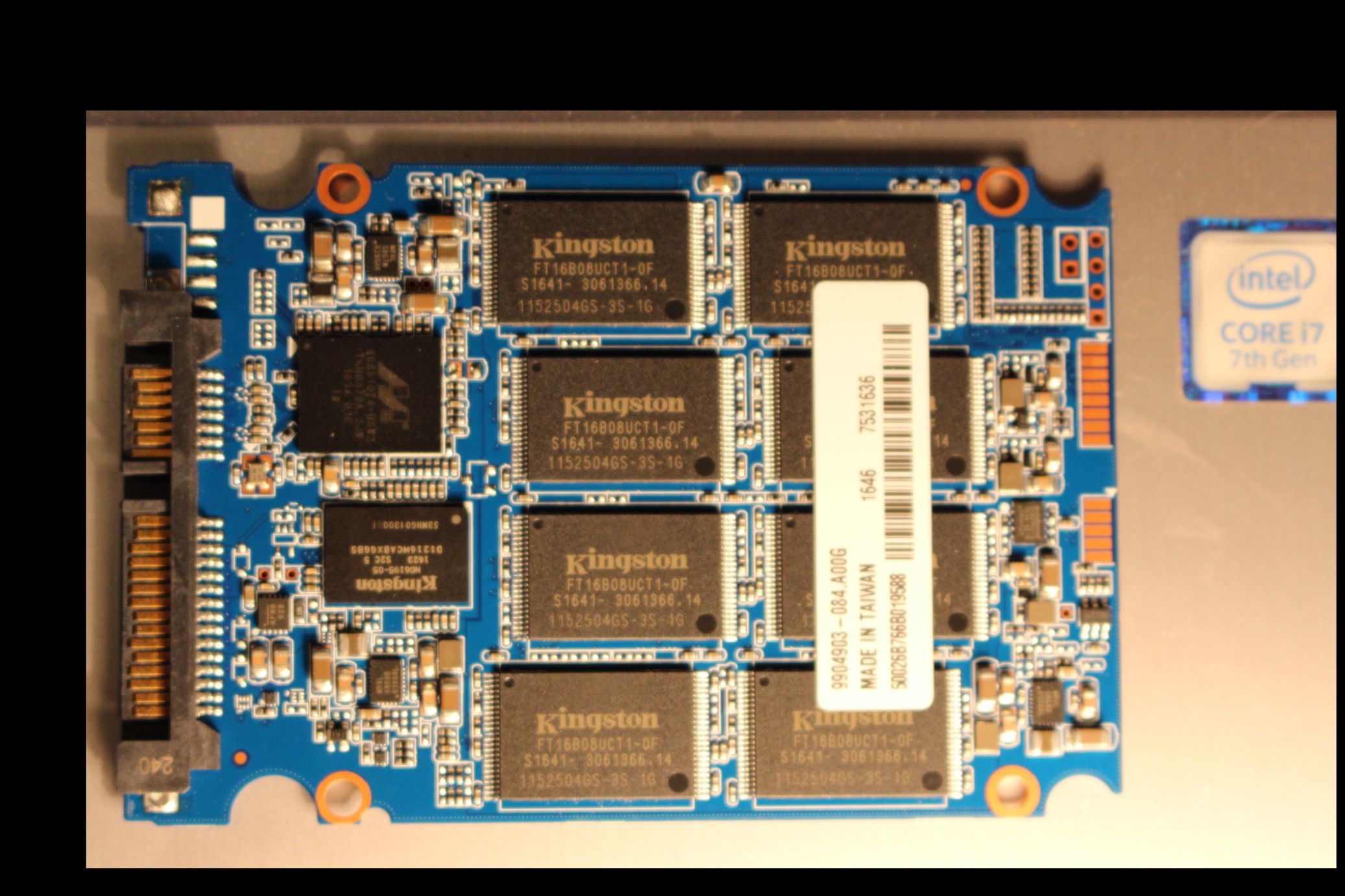

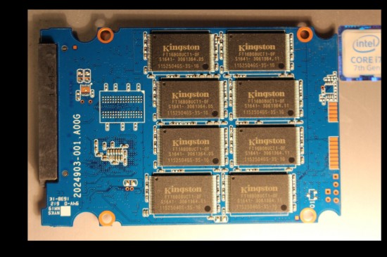

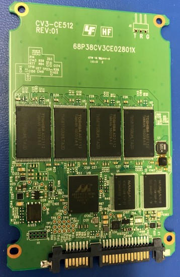

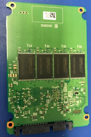

How about opening it up and taking a hi-res pic of each side. I think these are a simple ally case with 4 screws. inside a single PCB. just be gentle and you should be fine.
As far as I can see with this thread we don't know the exact controller or memory chips yet. Not a whole lot of point continuing without some concrete information. be glad to help after that.

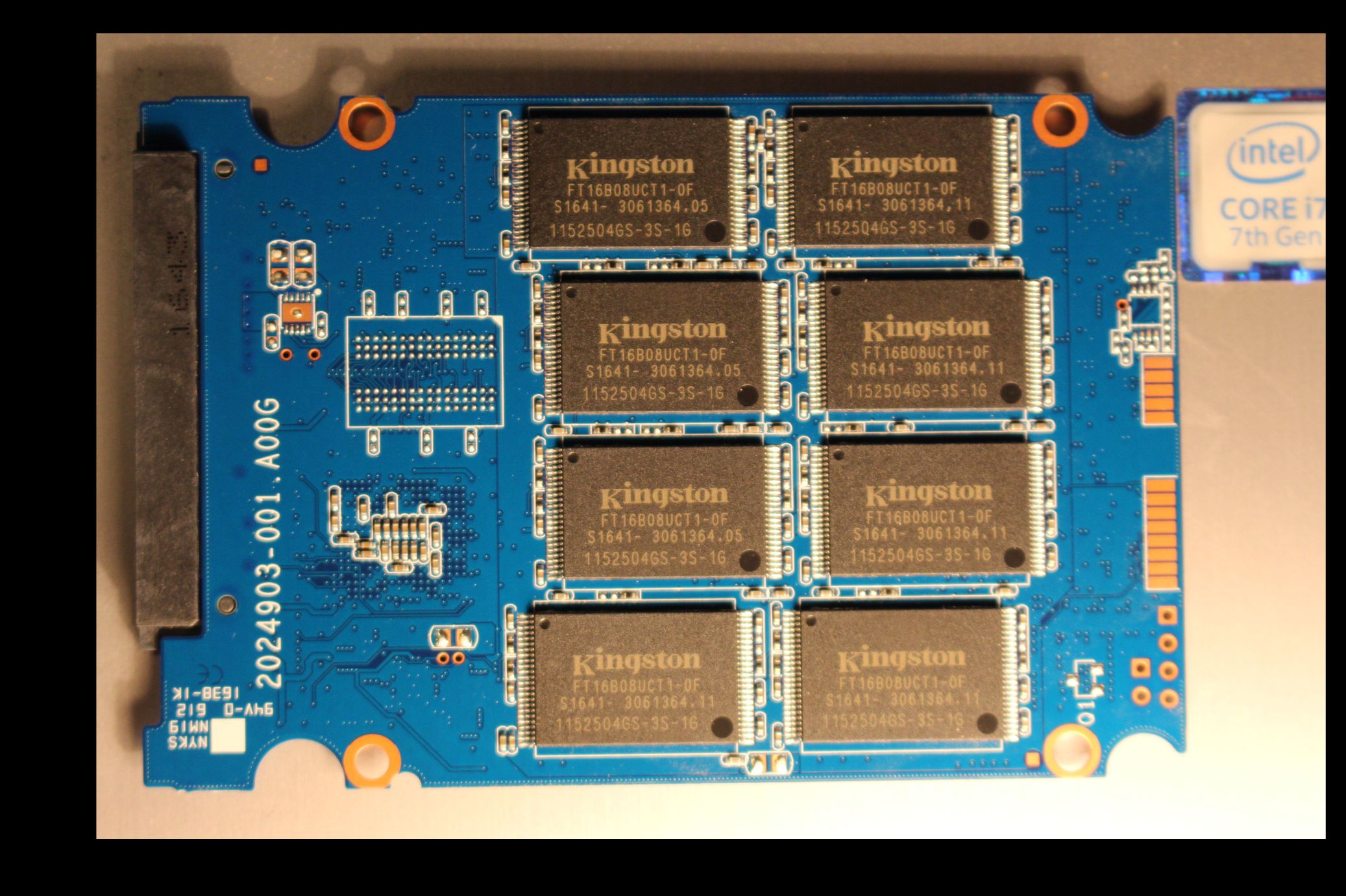

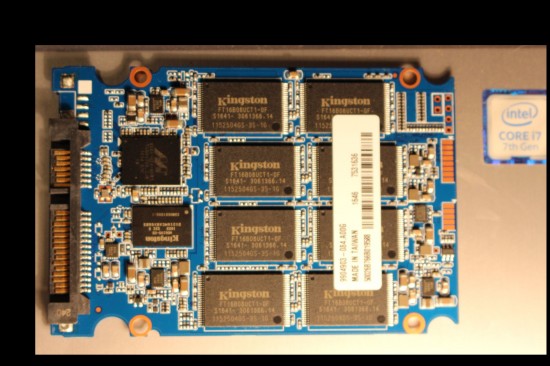

Here are the photos :D Not sure if I uploaded them correctly.
download/file.php?mode=view&id=15152
download/file.php?mode=view&id=15151
Good job finding that link. I will try that asap though I did notice that the firmware update is over a 1 year old that supposively fixed the issue. I hope that the firmware I had installed was already that version, but I think this is definetly worth a closer look. Thanks.

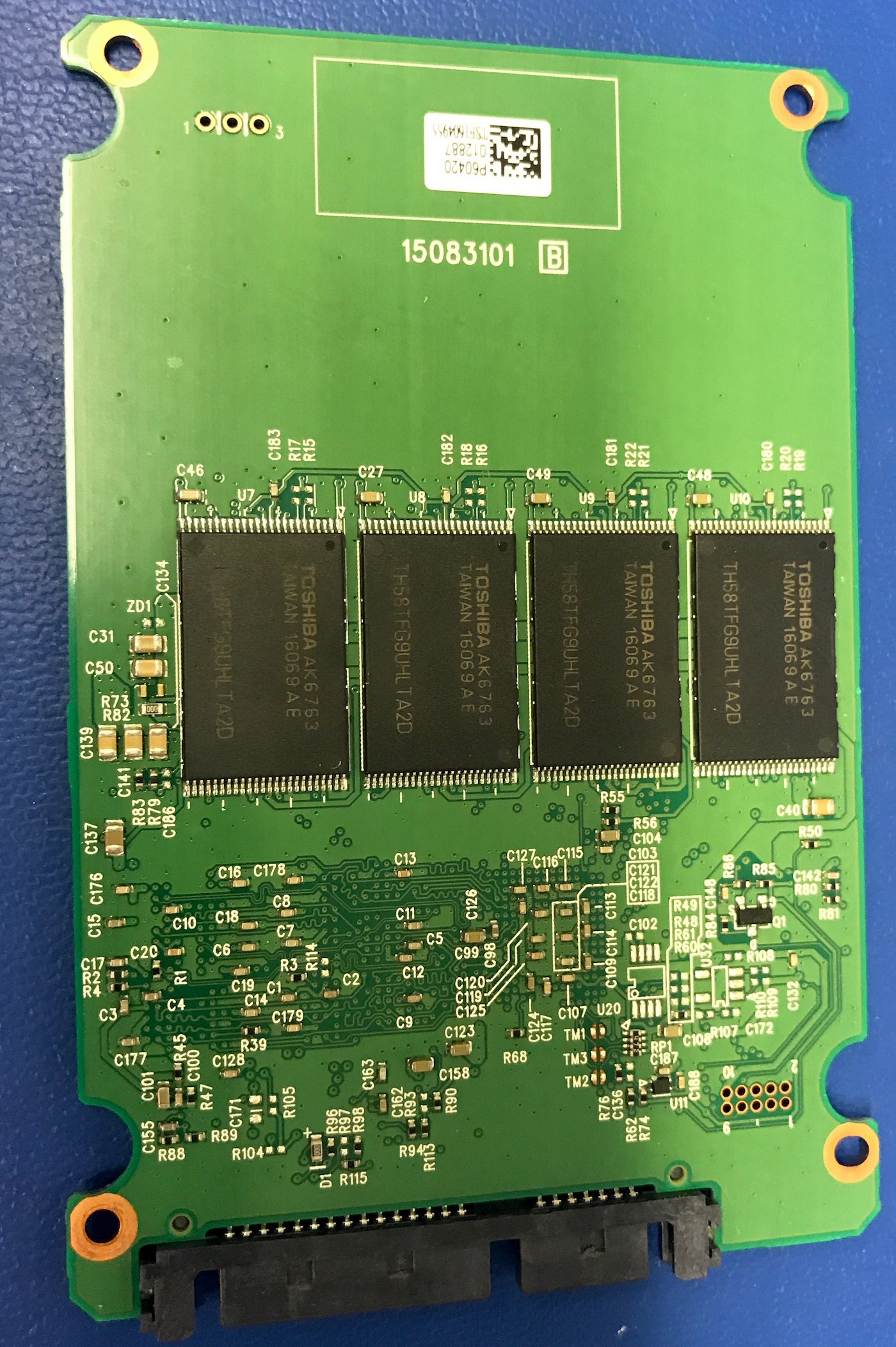

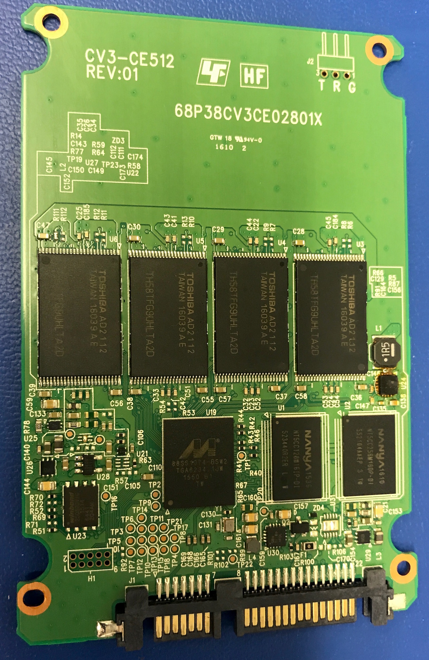

Thanks for the pictures!
this page: https://kb.mcafee.com/corporate/index?page=content&id=KB81136&locale=fr_CA&viewlocale=fr_FR
seems to imply it may be a SED (self encrypting drive)
But the actual dell Part number of 01D79 which is on your label says it isn't ...at this page: http://www.dell.com/support/article/au/en/aubsd1/sln304028/liteon-cv3-solid-state-drive-ssd-may-not-be-detected-in-your-system?lang=en
you may be lucky.
This product page tells the ECC (BCH ECC 128 Random Bits/2KB)which is an integral part of finding a solution, so mybe helpful. I haven't learnt how to figure out BCH yet, but I know some on here have: http://www.liteonssd.com/en/PRODUCT/client-sata-ssd/18q25q-sata/cv3-series.html
The only 88SS1074-BSW2 based SSD I have in my research pool here now is a Kingston and I could take a dump from it, but I'm worried they wouldn't be compatible for research, as Liteon appear to at least tweak the firmware .. any mention of custom algorithms make me wary:
The CV3 series SSD adopts a new controller with the low-density parity-check (LDPC) algorithm. By implementing the controller’s LDPC error-correcting technology, this extends the drives endurance with TLC Flash as much as 33%, hitting reliability levels only attainable with MLC flash. The blazing-fast writes are achieved by intelligently treating certain memory cells as premium single-level-cell NAND for maximum speed. When, during idle time, data in those cells is stashed away to fully exploit the capacity benefits of TLC flash.
I guess it is possible both Liteon and Kingston get an SDK for their versions of drives and simply do a few config options.. then talk up their "custom firmware development" kinda like the home router vendors do with their firmwares.
I have a Liteon SSD but different model and controller that I also don't think useful in research for this, Liteon LCS-128M6S with Marvell 8SS9187-BLD2
I have some more Marvell based SSDs at work and will have to have a look what they are.
