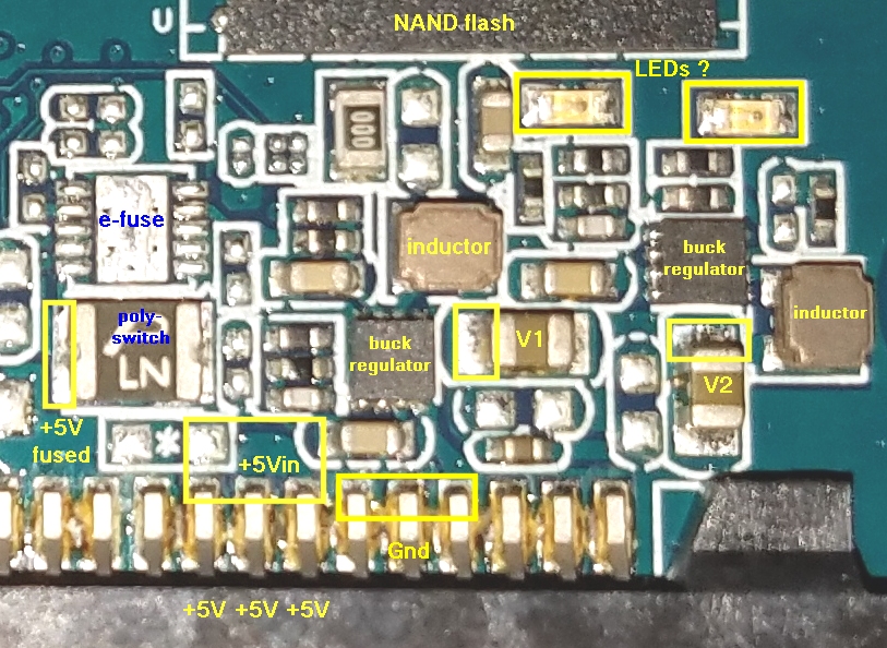

I realise that the OP is not interested in performing any measurements, but others might be, so here is my take on the circuit.
I would measure the voltages at V1, V2 and V3. Also measure the voltages at the 5 inductors on the underside. The latter would be associated with the internal PWM circuitry in the flash controller.
I'm guessing that the 2-pin location is the shorting point for safe mode, but I would be careful. If all the supplies are OK, and the SSD does not enter safe mode, then I would check the crystal. I would also check whether the controller or NAND are hot to touch.

He should be as it has already been 3 weeks, and this would take what, an hour being careful. Also he did say
I need to do whatever it takes to get my data back off this drive
Anyway I am curious about the Phison now. I just bought one for research : https://www.fruugoaustralia.com/pny-cs900-120gb-25-sata-3-internal-solid-state-drive-ssd-ssd7cs900-120-rb-new/p-17383107-37990902. (I'm going to regret this in the morning!) I will take the measurements suggested by Franc.

I wonder if the square safe mode (?) pad is wired to the R/B pins of the flash. The underside of the SSD has an unpopulated 272-ball BGA, so it wouldn't be to difficult to test this idea. Perhaps shorting the R/B pin(s) to ground could be a universal safe-mode method?
https://prod.micron.com/~/media/documents/products/data-sheet/nand-flash/80-series/l84c_plus_64gb_128gb_256gb_512gb_async_sync_nand.pdf
