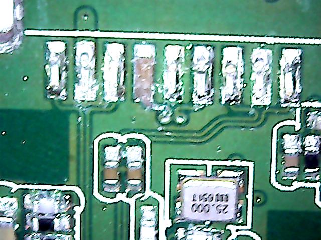

Blizzard wrote:
I will defer to fzabkar, but my previous cases the USB 3.0 have caps, 2.0 do not. The ones I have (Phison 2251) with non-standard USB 3.0 pinout have the controller on the opposite side and TSOP48 NAND.
In both examples one pair of 3.0 pins are capacitively coupled, the other are not.
In the OP's case there are no inductors (chokes). The Patriot-256GB example has chokes at L4 and L5.
        ___
    o---UUU---------o
        ___
    o---UUU---------o
        ___    ||
    o---UUU----||---o
        ___    ||
    o---UUU----||---o
    o--------------o
    o--------------o
    o------||------o
    o------||------o
It stands to reason that the centre pins would be for USB 2.0 (a photo of the opposite side would help to confirm this). That's because USB 3.0 connectors are downward compatible with USB 2.0, and it would make sense for the PCB layout to facilitate a USB 2.0 connector (as jeremyb appears to be suggesting).

The following site clearly shows the capacitors and inductors for each of the USB 3.0 differential pairs. The centrally located USB 2.0 pair is directly connected to the flash controller.

That matches my configuration for previous non-standard USB 3.0. The standard, as JeremyB mentioned, is pin 2-4-6-8 for USB 2.0 connection, but our non standard are 1-4-6-9.

Well that did gain us some improvement. We can see there is a USB connected and the volume does have a label, but no size. So this may be both a board issue, hence not being able to power via USB 3, and a NAND issue, perhaps broken solder balls as suspected. I have reflowed the NAND but this still did not improve things. I am going to remove the NAND, but I suspect its BGA-70 which is why I didn't want to remove it in the first place.

Check the voltages on the bypass capacitors around the NAND.

@fzabkar. Here are the voltages around the NAND
BC9 1.1v
BC8 1.1v
BC22 1.8v
BC4 1.1v
BC6 1.1v
BC5 3.3v
 Post subject: Re: Flash Drive Help
PostPosted: June 6th, 2018, 16:00
Posts: 17335
The voltages look OK.

ddrecovery wrote:
4.3v, not sure why its not 5v. This is also wired to a new connector so we can rule that out.
Unless you have miswired the USB pins, then ISTM that you must have a problem with the thruhole at C8.
I suspect that the OP miswired the USB pins by mistake
IMHO the OP had used another USB connector who has a diff pinout like this
@ jeremyb here is attached the one you're referring to
the controller is PS2251

This post is from 2018... and Jeremyb was wrong it was the right pinout, hence the correct voltage readings..... -;)
