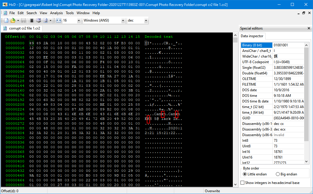

There is 10GB of good data and the rest is corrupt, if I had to "guess" its a firmware issue w/ the camera, the CF card itself appears to be fine to me.
ECC is green in the areas where corrupt headers are seen and the card is fully functional.
Re: Help! need to refer someone for SDcard in dominican repu
December 2nd, 2019, 23:21
jeremyb wrote:There is 10GB of good data and the rest is corrupt, if I had to "guess" its a firmware issue w/ the camera, the CF card itself appears to be fine to me.
In case anyone wants to follow along at home they can download a sample of the headers below..
I don't "think" its recoverable, it looks like every a 16bit word where one of the bits is stuck off, not inverted.
eg: 0x00 is always 0x00 but 0x6F will be 0x6B

1. The NAND chips are fine.. The ECC passes so the data in the chips are fine, I can reassemble the physical image and validate it against the logical image, there is no difference so it's not an interface, controller or NAND issue w/ the CF card. The data was written to the card corrupted, to me the issue is with the Camera.
2. Its not an inverted bit, its a stuck bit, the bit is shorted to ground, it is ALWAYS zero you can't write a script to fix that because there is no operation to decode it..
3. The camera has a years worth of photos on it, only the most recent photos are corrupt.

There is nothing physically wrong with the CF card, file system, or 80% of the data on the card.
It's a deleted file recovery.. 20% of the deleted files have a stuck bit with a value of 0 every 16bit word at bit 2
eg:
org: 1111 1111 0110 1111
mod: 1111 1111 0110 1011
In my opinion the Cameras firmware wrote corrupt data to the card.. perhaps a MOVSW instruction from corrupt DRAM?
As the value is stuck at zero no mater what the original value the damage is irreversible, its not an inverted bit.

This appears to be a CF card thing.
Since then I have seen a couple more, in all cases CF cards. In one of the cases the problem was bent male pin in card reader, problem went away using a different reader.
Now I have another one again.
