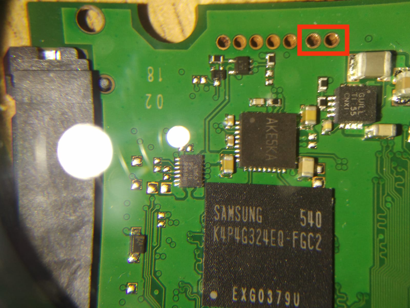

Success! :D
Since I couldn't get the drive detected in Safe Mode no matter what I did, I decided to try if the other method of shorting the pin on the MP5505 worked without SATA hotplug fully working. Sure enough, by first hotplugging the drive in the normal (password locked) mode in order to figure out what port I needed to manually trigger a scan for, I immediately saw it disconnect once I shorted the pin. I then simply had to tell the OS to scan the port a few times for the drive to show up in ERRORMOD:

I decided to go the secure erase route, instead of using the Samsung Magician DC tool. I also decided to update the firmware to from GXT5204Q to GXT5404Q as well via hdparm. After a second secure erase, as suggested on another forum after updating the firmware of the drive in this way, the drive now seems to work perfectly fine. :)
Curiously, it no longer shows up in the Samsung Magician DC 1.0 and 2.0 tools (even after adding the file /usr/local/Magician/AnyOemSupport.xml) despite the drive seemingly behaving normally and showing up like it should in hdparm etc. I know that it showed up in Samsung Magician DC 2.1 in the past.

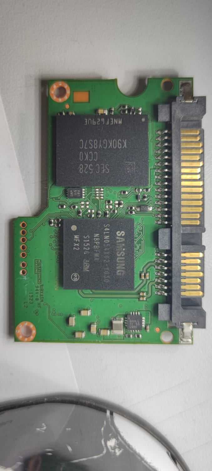

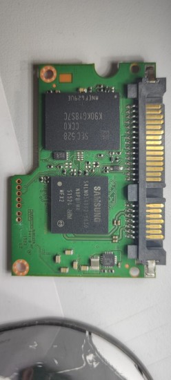

Is this method works for PM883 too? I tried to find temperature sensor or power loss protection IC in the PCB. I typed to google what I can read from the top of the ICs but no result found :(
I have a 3.84TB with non default master password :(

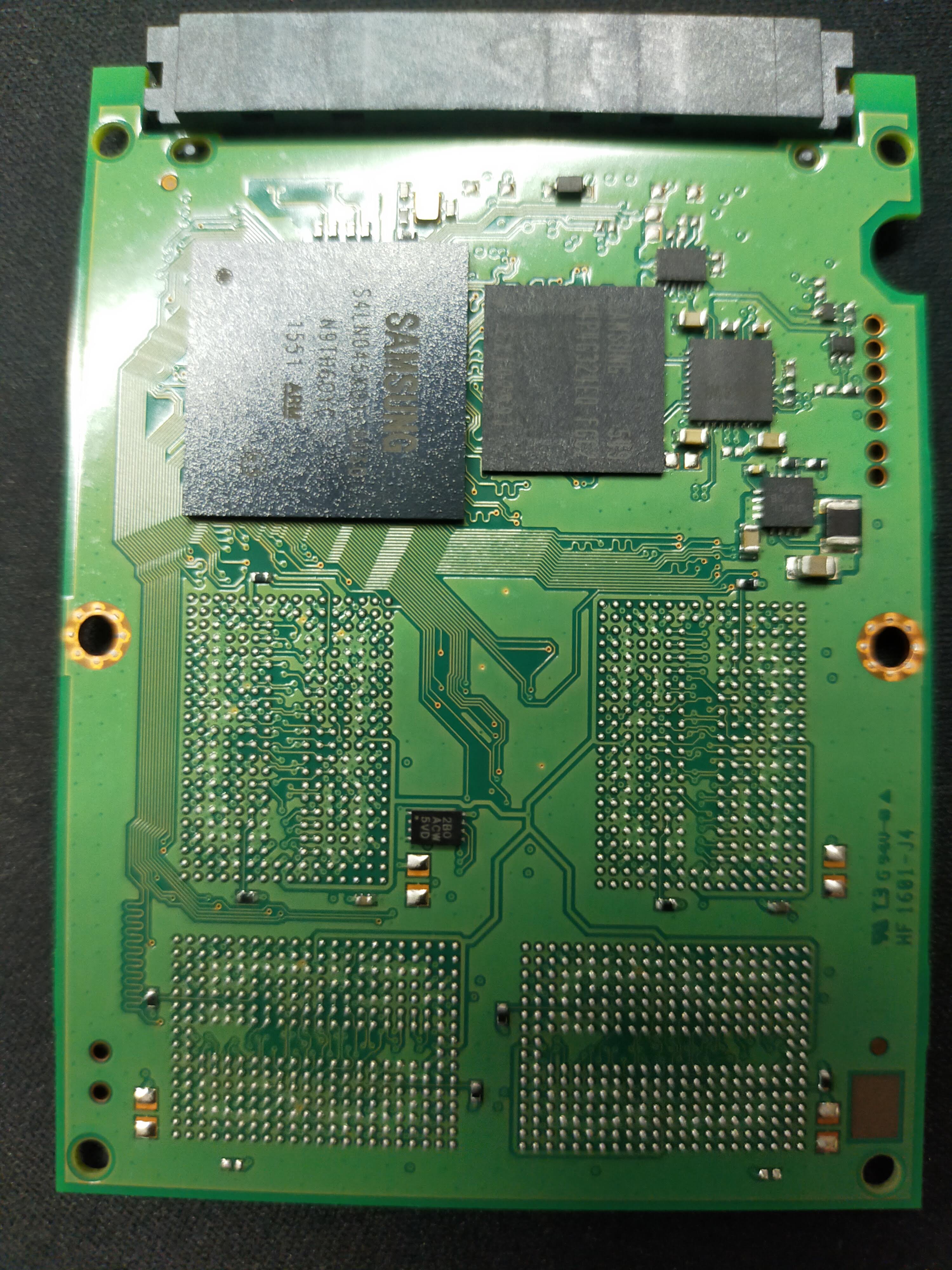

Upload detailed photos of each side.

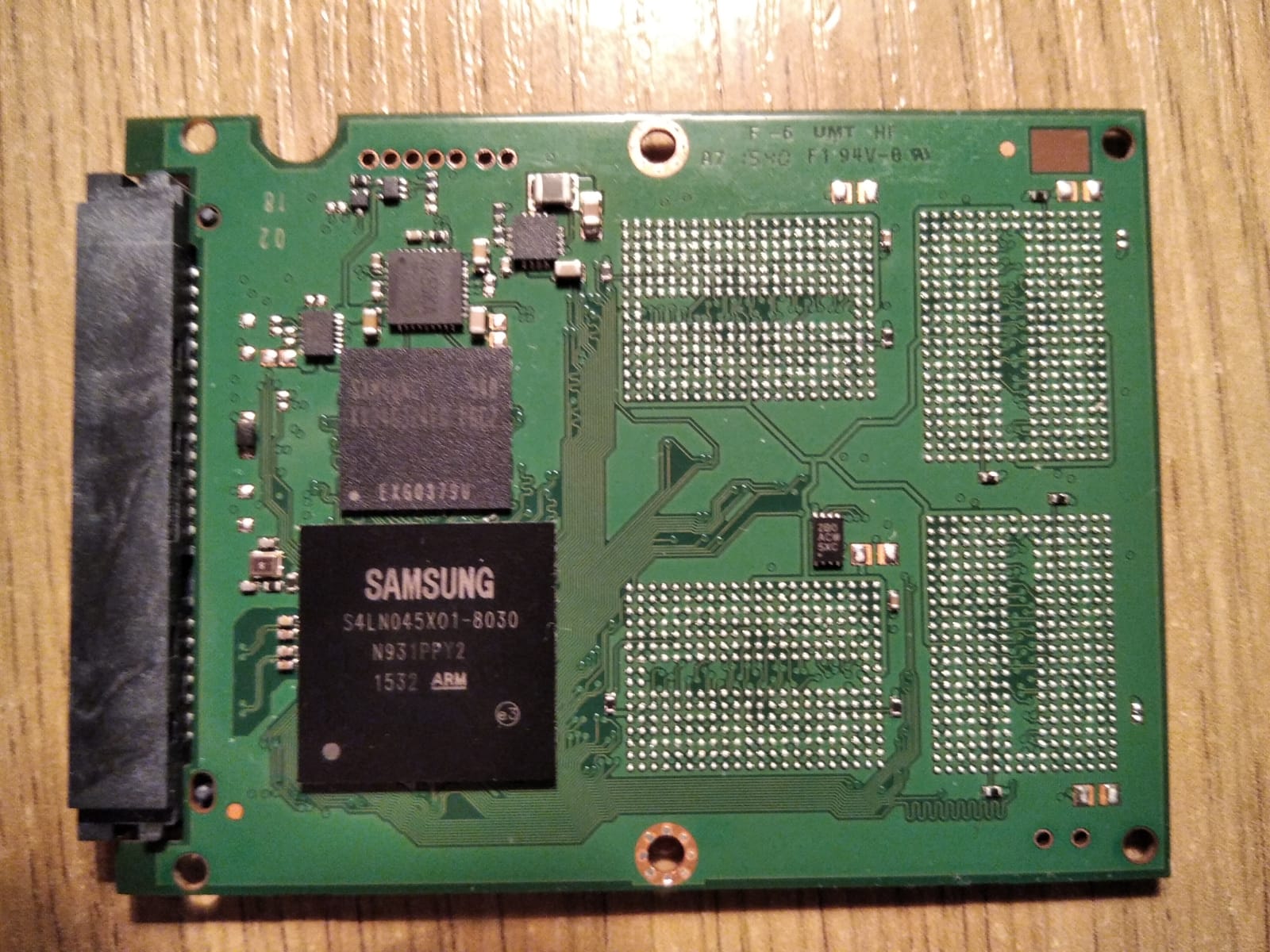

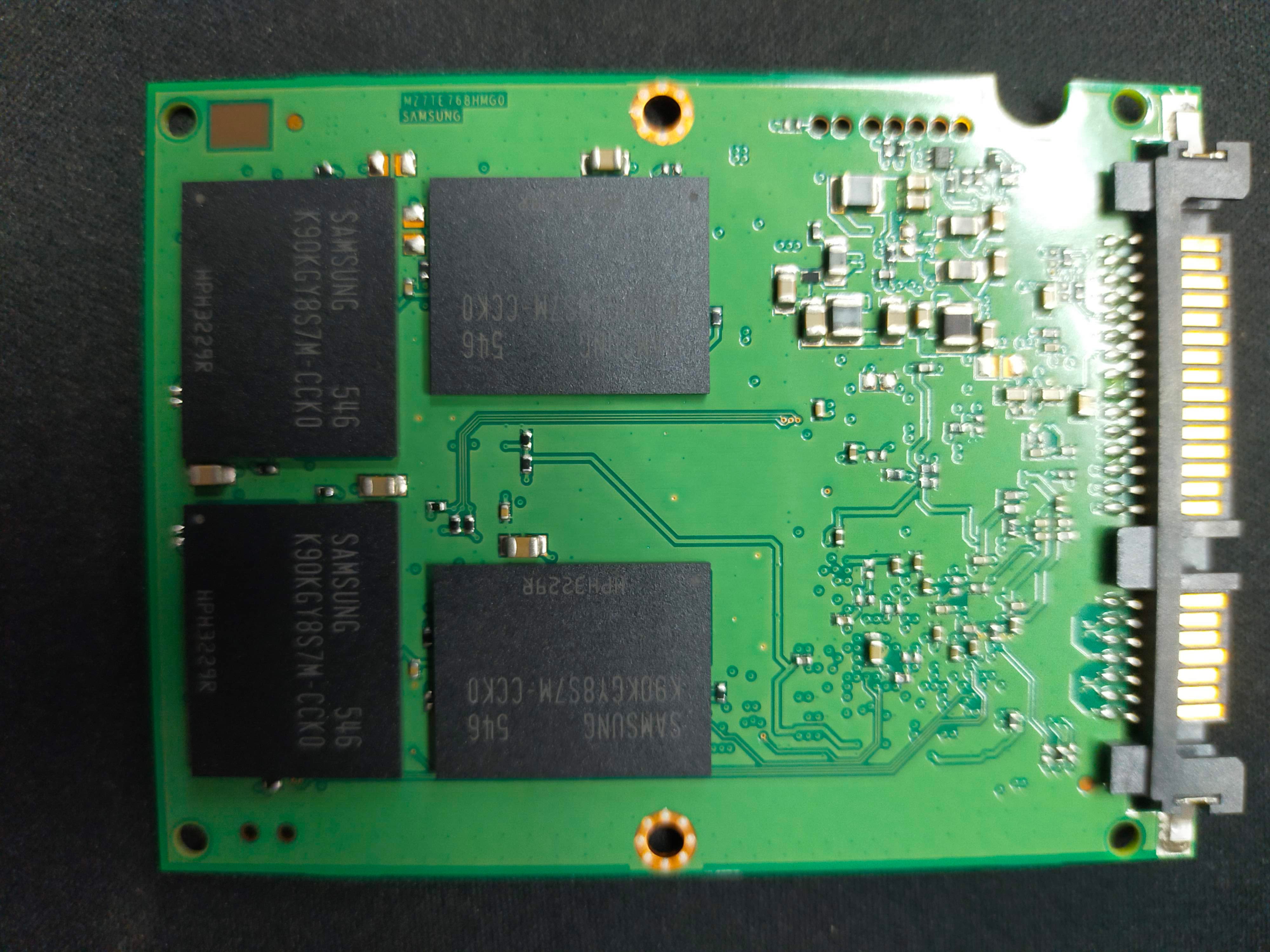

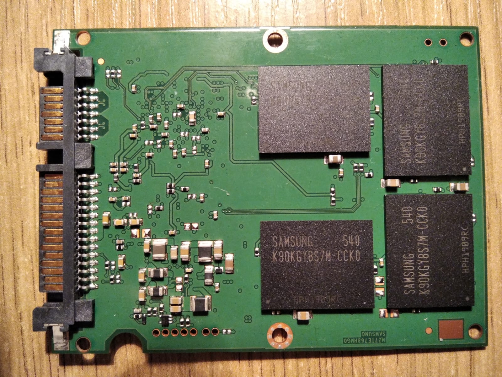

@danielkovacs, does your PCB look like this?
https://www.techpowerup.com/ssd-specs/samsung-883-dct-960-gb.d1266
https://tpucdn.com/ssd-specs/images/d/1266-pcb-back.jpg
https://tpucdn.com/ssd-specs/images/d/1266-pcb-front.jpg

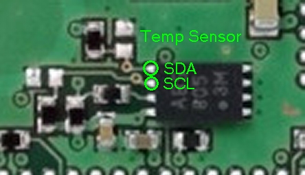

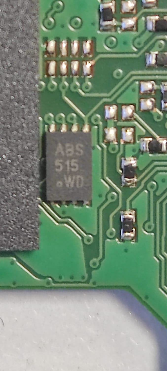

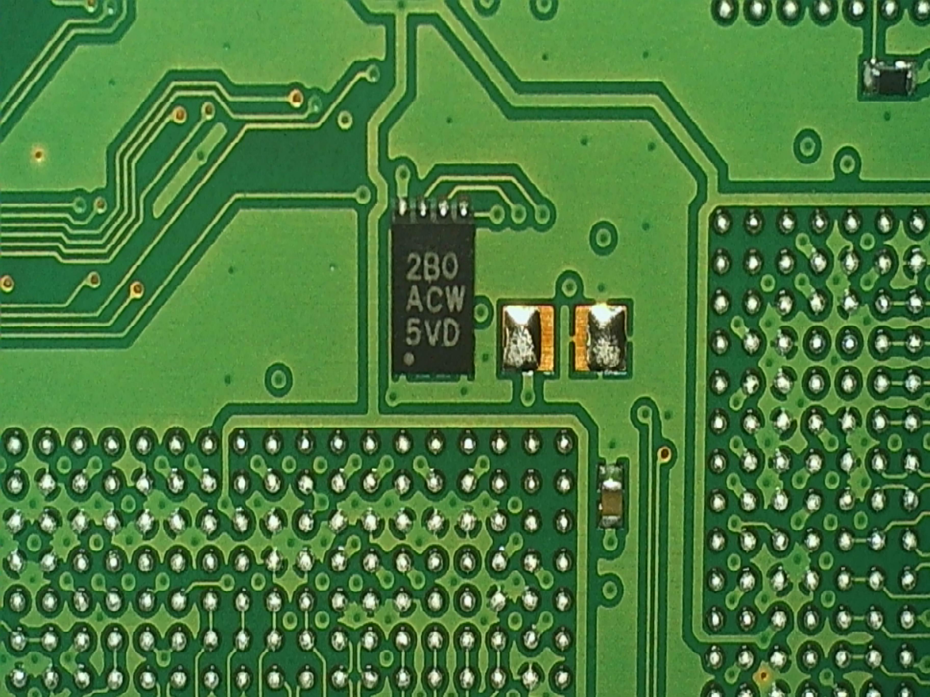

I think "BPK7YG" would be involved in power loss data protection. I suspect that it's a Silergy part with a marking code of BPKxyz. Unfortunately, I can't find its datasheet.
The "ABS" part would be the temperature sensor.
MCP9844T-BE/MNY, Microchip, +/-1 degC, 1.8V Digital Temperature Sensor, marking ABS, TDFN-8:
http://ww1.microchip.com/downloads/en/DeviceDoc/20005192B.pdf

My PCB is look like the same, only I have more NAND chip due to the higher capacity. I checked the temperature sensor pins to find which pin connected to the ground when the device was powered off. PIN1 and PIN4 are grounded.

My PCB is the same what you linked, I have more NAND chips soldered, due to the higher capacity. Should I try to ground the temperature sensor PIN6 to get ERROMOD? I checked the pins of the temp sensor when device powered off, PIN1 and PIN4 are grounded...

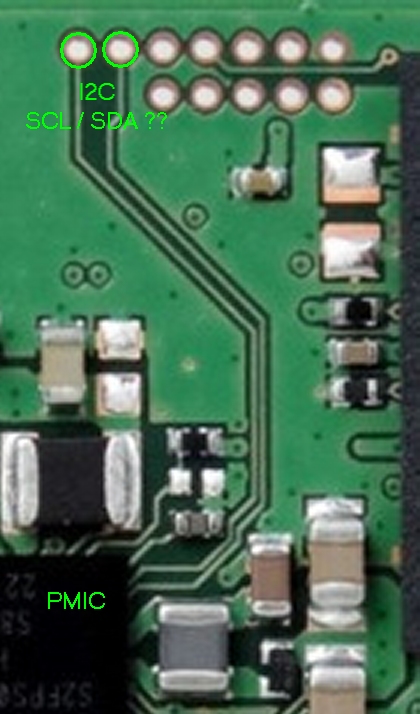

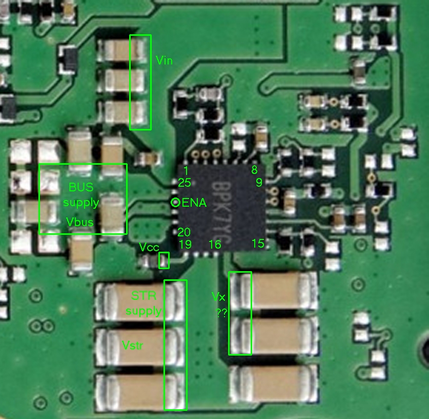

I don't feel comfortable with your SSD because I don't have datasheets. If you are prepared to accept any risks, you could try grounding that pin.
I would prefer to try "safe mode", but I don't know which pads are the relevant ones. There are two rows of pads at one edge of the PCB (7 + 5). These would be JTAG pads, plus some other functions. There is also an 8-way edge connector whose function I can't guess.
If someone is willing to share the safe mode test points, start with that.

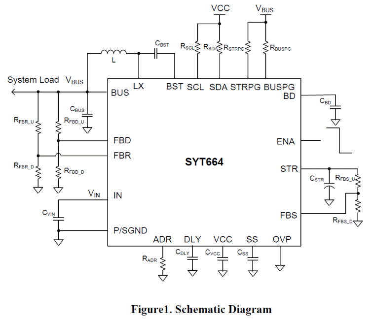

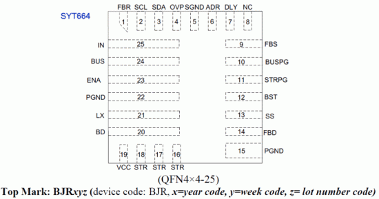

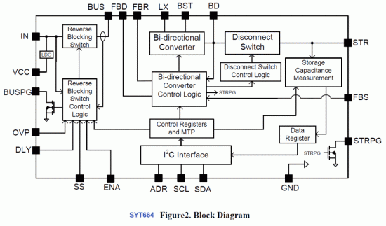

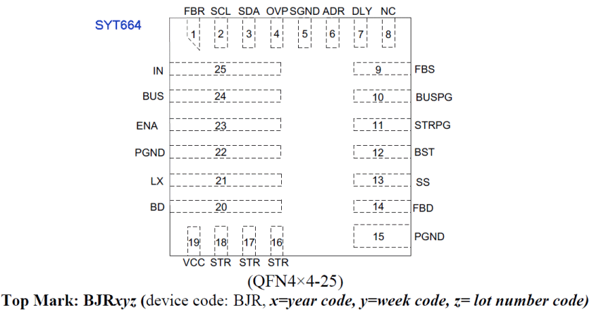

I think Silergy's SYT664 IC may be a very similar chip.
Unfortunately the link to its dataheet is dead.
https://www.geckor.com/static/upload/file/20220809/1660026921692877.pdf
I did manage to download Google's text based cached versions, though.
https://webcache.googleusercontent.com/search?strip=0&q=cache:https%3A%2F%2Fwww.geckor.com%2Fstatic%2Fupload%2Ffile%2F20220809%2F1660026921692877.pdf
https://webcache.googleusercontent.com/search?strip=1&q=cache:https%3A%2F%2Fwww.geckor.com%2Fstatic%2Fupload%2Ffile%2F20220809%2F1660026921692877.pdf
 Post subject: Re: Unlocking ATA Password of PM863a SSD possible?
PostPosted: December 9th, 2023, 1:45
Posts: 17324

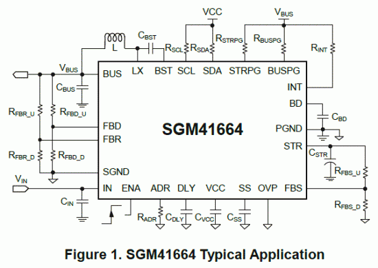

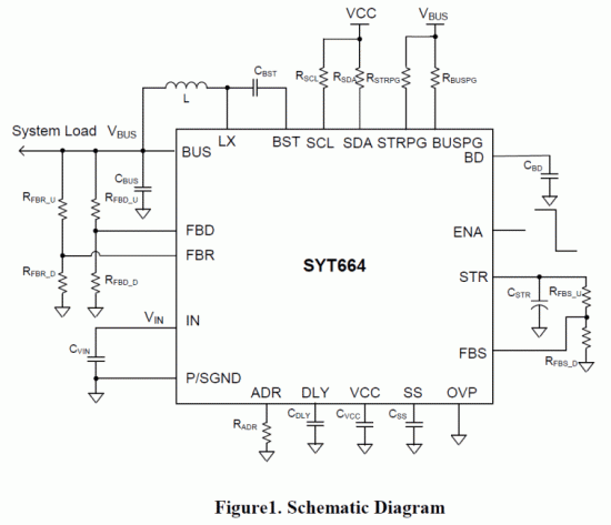

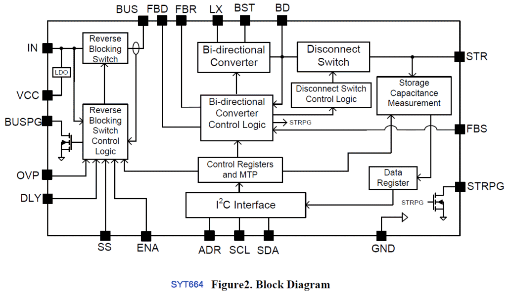

Some kind fellow at eevblog.com found the datasheet:
SYT664, Silergy, High Current Over Voltage Protection Switch with High Current Bi-directional DC/DC Regulator And Capacitance Measurement, marking BJRxyz, QFN4×4-25:
https://www.visvie.com/static/upload/file/20220809/1660026921692877.pdf

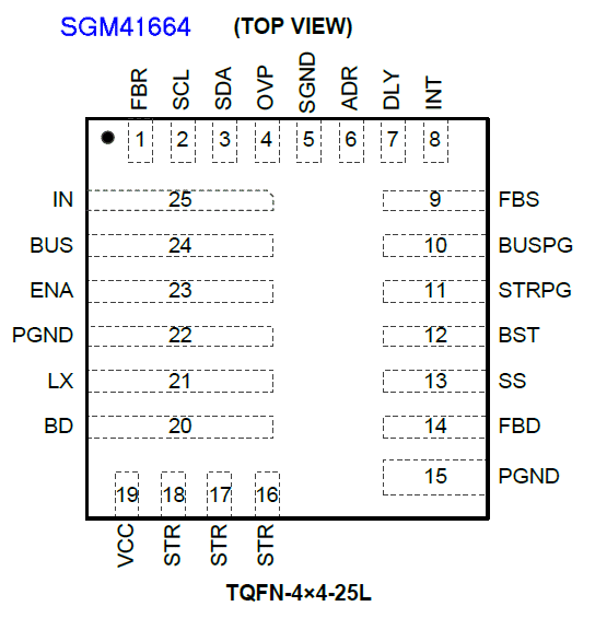

This IC is compatible. The only difference appears to be in pin #8.

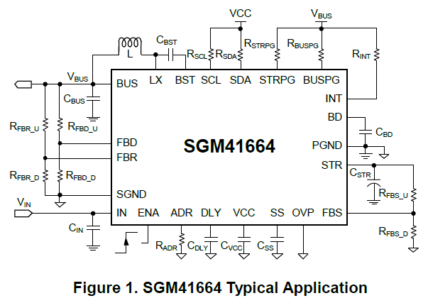

SGM41664, SG-Micro, Efficient I2C Power Backup Manager with High Current Bidirectional DC/DC Converterand Capacitor Measurement Capability, TQFN-4×4-25L:
https://www.visvie.com/static/upload/file/20220809/1660026640335476.pdf
https://www.visvie.com/hot/SGM41664-Replace-SYT664.html
Pin #23 is an ENAble input. We need to check whether this pin is directly connected to a supply or via a pullup resistor. To this end we need to test for continuity between ENA and each of Vbus, Vin, Vcc, Vstr and Vx. If there is no continuity, then it should be safe to ground the ENA pin. In this case, since pin #22 is PGND, it should be safe to short pins 22 and 23 together.

Downloaded 836 times
SGM41664.pdf [647.71 KiB]
Downloaded 849 times
PostPosted: December 11th, 2023, 14:10
Posts: 17324
Could anyone with an SSD that has the same 7 + 5 pads test for continuity between all the test points I have identified as possible I2C data and clock pins?
PostPosted: December 11th, 2023, 21:26
Joined: February 18th, 2020, 9:35
Posts: 77
Location: Ukraina
Yes, these are SCL and SDA, when they are shorted, the disk will fall out in Error mode.
PostPosted: December 13th, 2023, 10:15
Joined: October 9th, 2012, 18:37
Posts: 66
I can confirm. When I shorted these pins you marked green, my PM883 went into ERRORMOD.
Then just do the security erase with hdparm and the drive is back with it's capacity and unlocked.
PostPosted: February 5th, 2024, 9:04
Joined: February 5th, 2024, 5:53
Location: Kyiv, Ukraine
Hi all!
I have ATA password problem with SSD Samsung PM851 MZ-7TE5120 MZ7TE512HMHP-00004.
It was be installed in to the laptop with touch ID scanner, and activated protection in BIOS. I think, BIOS set some ATA password in to the SSD. This laptop is no longer there, and I cant unlock my SSD.
This is OEM product, and Samsung didn't support it on website and in Magician application! Also i can't find firmware ext0300q.enc at the web for it.
I shorted 2 pins (red), and try run HDPARM , but this did not help solve the problem!
Standard connecting:
hdparm -I /dev/sdb
/dev/sdb:
ATA device, with non-removable media
   Model Number:       SAMSUNG MZ7TE512HMHP-00004
Serial Number:      S1RJNSAGA02581
   Firmware Revision:  EXT0300Q
Security:
   Master password revision code = 2007
      supported
      enabled
      locked
   not   frozen
   not   expired: security count
      supported: enhanced erase
   Security level maximum
   2min for SECURITY ERASE UNIT. 8min for ENHANCED SECURITY ERASE UNIT.
hdparm --security-erase NULL /dev/sdb
/dev/sdb:
Issuing SECURITY_ERASE command, password="", user=user
SG_IO: bad/missing sense data, sb[]:  70 00 05 00 00 00 00 0a 04 51 40 00 21 04 00 00 00 00 00 00 00 00 00 00 00 00 00 00 00 00 00 00
Connecting with shorted 2 pins:
hdparm -I /dev/sdb
/dev/sdb:
   Model Number:       SAMSUNG SATA SSD
Serial Number:      00000000000000
   Firmware Revision:  ROMMEX17
Security:
   Master password revision code = 65534
      supported
   not   enabled
   not   locked
   not   frozen
   32min for SECURITY ERASE UNIT. 32min for ENHANCED SECURITY ERASE UNIT.
/dev/sdb:
hdparm --security-erase-enhanced NULL /dev/sdb
/dev/sdb:
So, you can see, result SECURITY ERASE no change with shorted 2 pins!
Maybe some of you tell me, what i do wrong?
PostPosted: February 5th, 2024, 13:47
Posts: 17324
Try shorting the of the SCL and SDA pins of the "2B0 ACW" 8-pin IC. This is a temperature sensor. Maybe this will provoke ERRORMOD.
PostPosted: February 7th, 2024, 14:31
shortings the of the SCL and SDA pins of the "2B0 ACW" 8-pin IC do no make any changes.

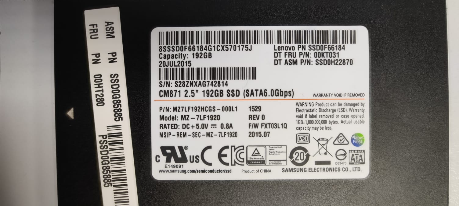

This is a Samsung sata ssd CM871 locked
Any suggestions on pins to join to ground to try to unlock?

Only server SSDs go into ERROR MODE

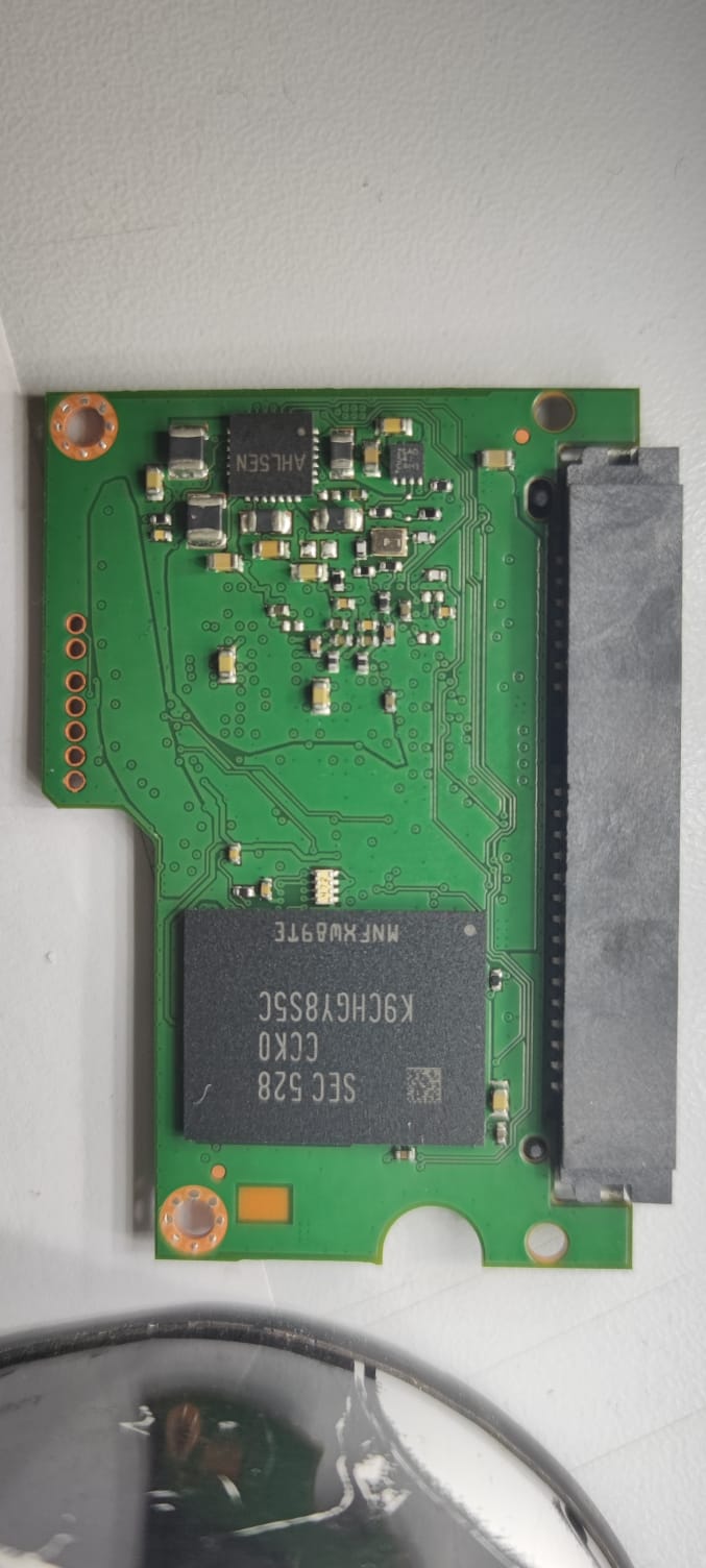

Hello Friends,
Can someone pls guide me which IC and PINs to short?
Samsung PM851 512 GB SATA SSD.
File comment: PCB front
File comment: PCB back
File comment: This one? Which pins?
