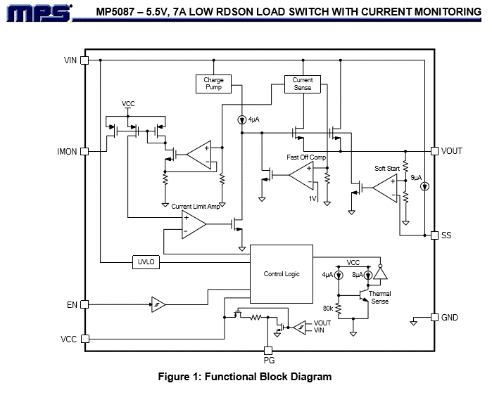

The supply pins are nearly always bypassed by a filter capacitor. You will probably find it easier to measure the capacitor rather than the IC. I always look for less "busy" access points.

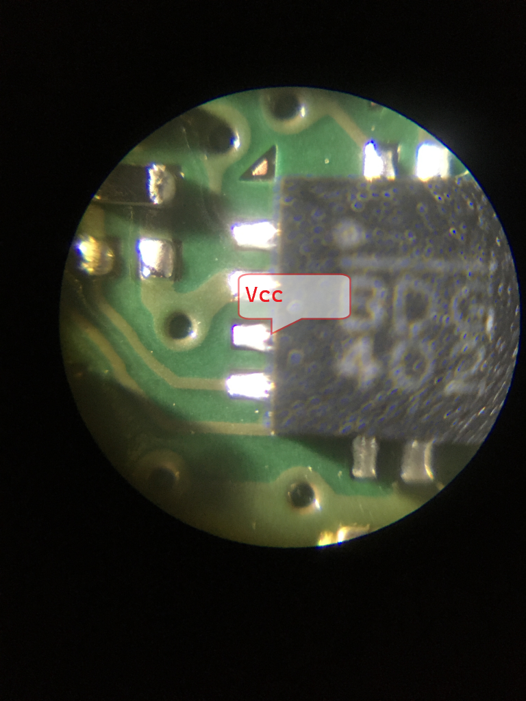

Hmmm,..... :?:
 Post subject: Re: Dead nvme Intel 600p -> Data Recovery -> now part is mis
PostPosted: October 27th, 2020, 20:54
Posts: 17356
Maybe you could test for continuity between Vcc and the nearby capacitors? Or could it be that Vcc and Vin are tied together by the circuit?
PostPosted: October 27th, 2020, 22:44
Posts: 17356
The load switch provides protection from shorted loads. It also has an undervoltage lockout, which means that it doesn't turn on until the supply voltage has risen above the UVLO threshold. It can also be used to put parts of the SSD to sleep in standby mode.
If the ENable pin is strapped to Vcc via a resistor, and is not controlled by the flash controller, then this would suggest that the load switch is not being used for power saving purposes. That is, it would suggest that it is always on. If so, then it would be OK to bypass it. I'm now wondering whether the function of the load switch is to protect the NANDs from an external 3.3V supply whose quality is unknown. All the other supplies are derived from the 3.3V supply via DC-DC converters, so they are largely immune to external quality problems.
So, in short, if you can find where the ENable signal is generated (either locally or from the flash controller), then we can have some confidence in what we are doing.

I'm wondering whether the load switch provides 3.3V power to both the NAND array and the controller. If so, then this means that the controller cannot control the Enable pin, which in turn means that the switch would be always on. Therefore it would be OK to bypass the switch. One could confirm this by measuring the voltages across the small bypass capacitors around the controller.
If after bypassing the switch the SSD doesn't come to life, then we would need to examine the PG (Power Good) pin. This signal is derived from the Vin and Vout voltages.

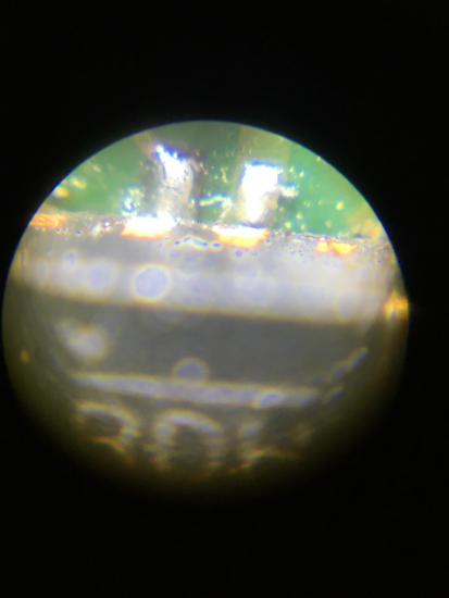

Progress!!!
If you wanna call it that, I rather have the feeling I'just put the drive back into the state it was
when I sent it off for data recovery.
Thank you fzabkar for leading me thru the dungle this far.
I had a closer look at the connections of the load switch. I've tried a photo with my son's microscope.
I thought i quickly fix this with my soldering iron, well it took me the whole night until I got it right.
It turns out, the load switch wasn't broken, just bad connected.
Now the drive boots into ROM mode just fine.
Only in normal mode, the BIOS hangs for a while, then reports no drive.
For now I just let it sit, powered on in BIOS, to see if the firmware is gonna do some magic.
Reports suggest that powercycling sometimes has helped. We'll see.
Any suggestions on how to continue from here. Send it to recovery again?
Oh good, now I have to go with my kids to the swimming pool, without sleep, that kinda s...s.
