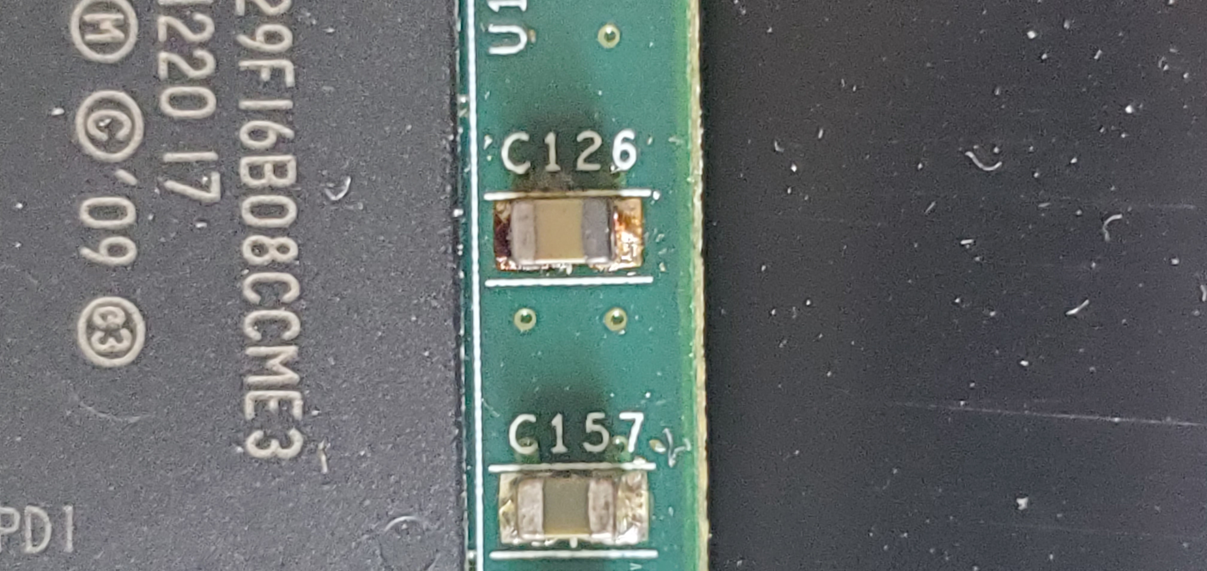

File comment: C126 kinda looks like it could be burned?
Hi guys,
Ive got my Vertex 4 dead. with crypto in it. i bought the same working SSD as donor, but im not sure whats the best aproach to fix it.
On my dead SSD no LED comes up, also almost all of capacitors are shorted. only one capacitor (C126) on the back looks darker and kinda burned, but im not sure its the problem. How can i find whats cousing those shorts? if its INDILINX or Hynix or RT9991?
Also would it work if i swap all NANDS with working SSD? or is it better just to swap the those 3 ive mentioned above?
