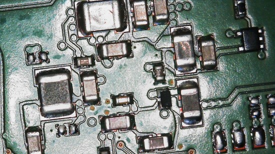

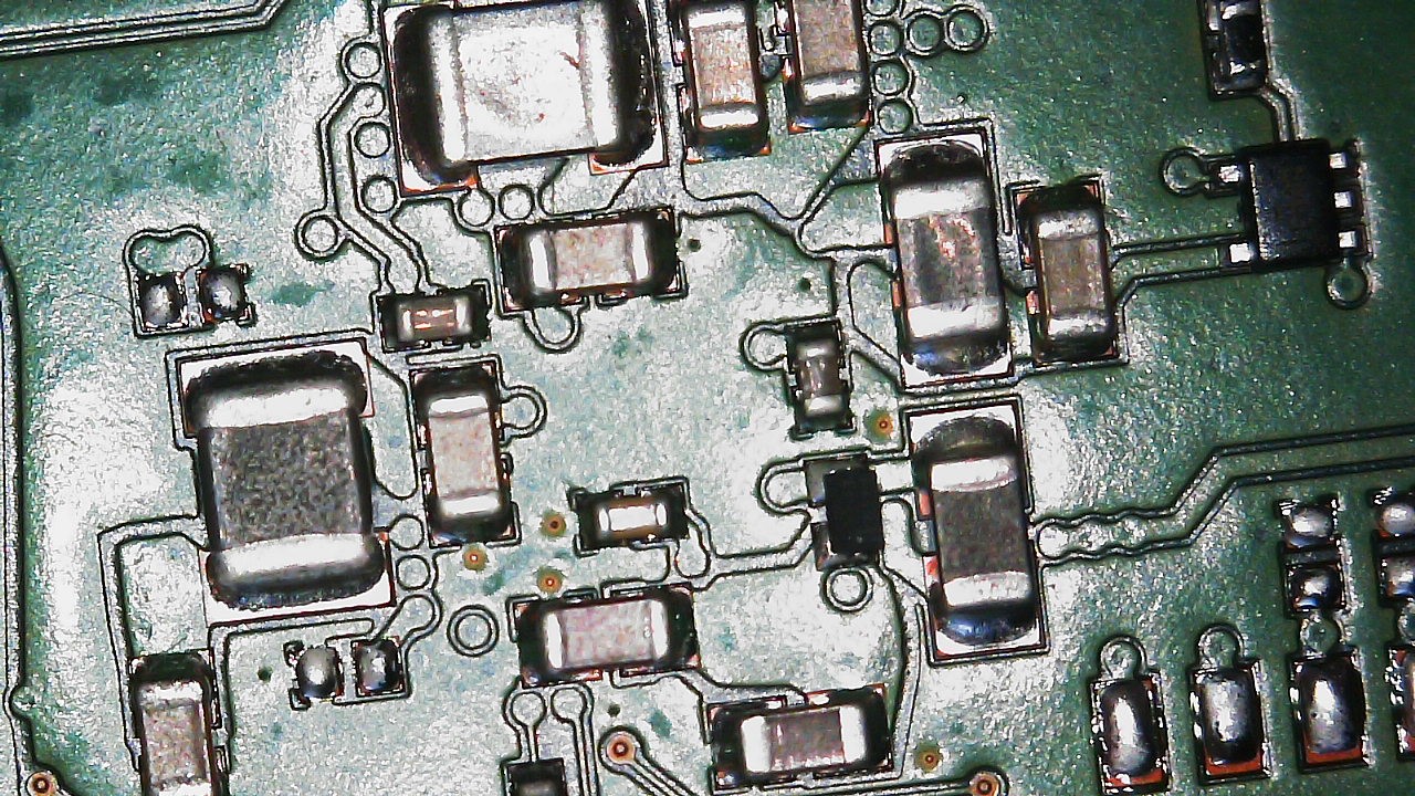

I did a physical inspection using a USB microscope. the diode does seem dark , suspect it is burnt but not sure.
I didn't measure a volage across it though. But here are the ones I did measure. My Fluke meter doesn't have a precision measurements as it seems.

V1 looks bad, but your measurements don't give me much confidence. You should select a lower range on your meter.
The diode is OK -- it is producing the correct boost voltage (12V).

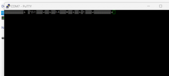

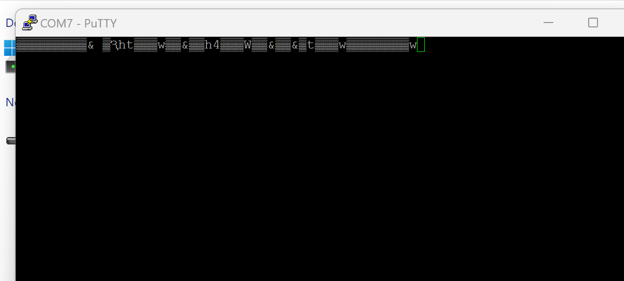

Connecting to 2 pins UART next to JTAG (5) pins I get some garbage spits out on the terminal. When I short the safe mode pins ( next to UART) and connect the disk back to USB port, I get no output on the terminal and disk won't appear in "diskmr". As soon as remove the short, I see the same garbage spit on the screen and the disk appears in the "diskmgr".

Oh my boy... There is no need to short it.
First use speed 115200, the garbage you see is because you use incorrect speed. Second, wait for terminal to stop spitting and report back.

Well I tried 115200 8N1 and then reduced the speed down up to 9600 but nothing helped. Then I thought that UART might get activated in the safe mode which is activated by shorting the safe mode pins. So either way, I didn't see a proper output on the puty.

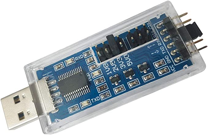

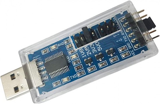

Can you show me a picture of the device you are using as terminal?
Here it is.
Thank you for trying to help me on here. Appreciate your time and help.

Set the hardware with a jumper on 1.8v connect with a 115200 baud rate, open putty, then power on device with a sata power cable.
