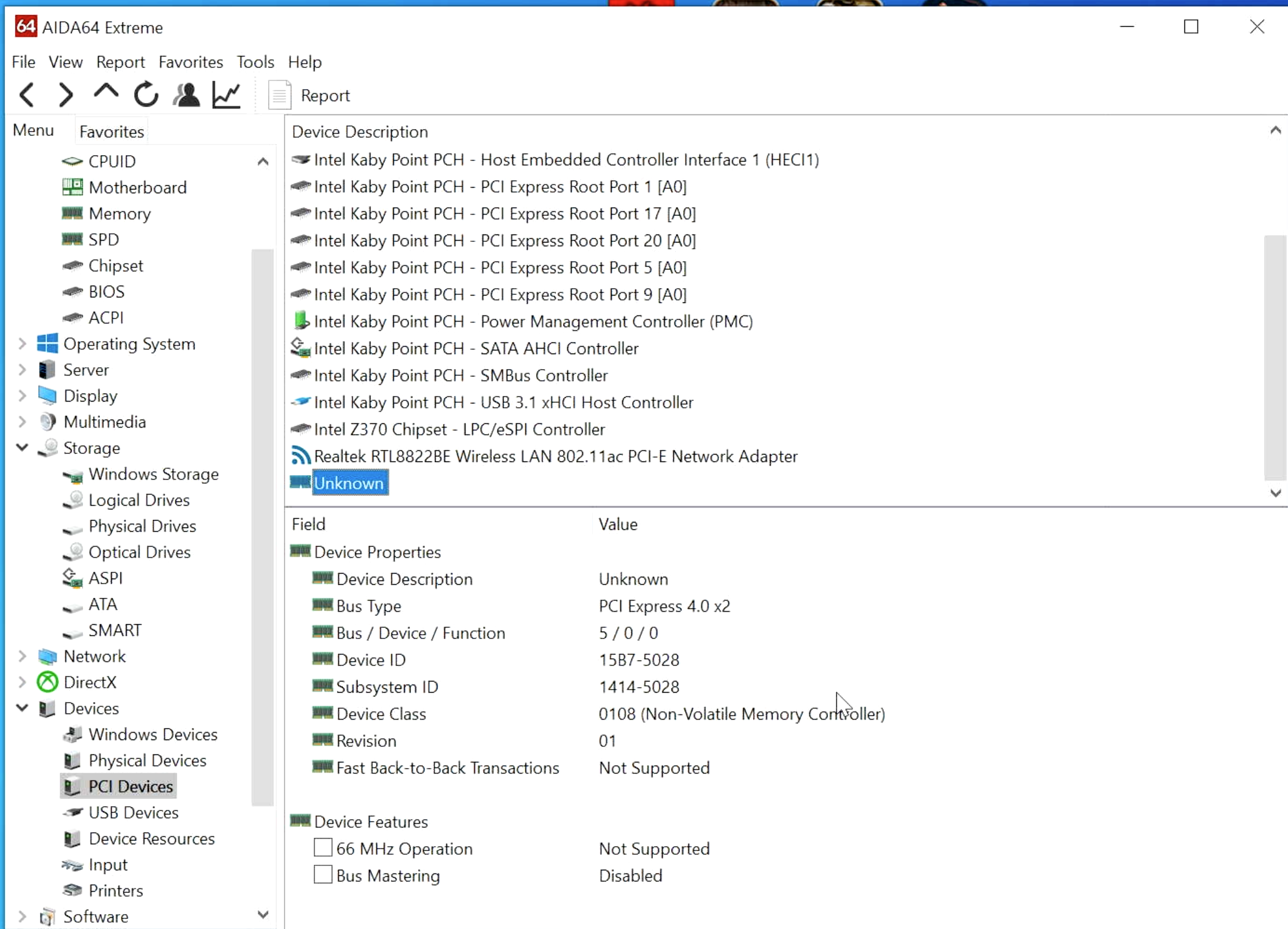

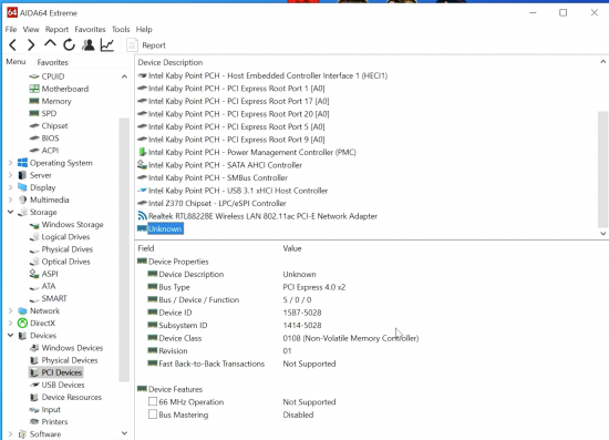

so, ive got some kinda update for you guys:
1. good ssd that i have for comparison is sn530 which is 99.9% same layout and ics. all voltages are same. basically all diagrams that i wrote are correct and applicable for a good ssd and can be useful for anyone who needs. except resistance on that low rail (13 ohm) is 25 ohm but i guess that's still in kinda acceptable range.
2. poked around with oscilloscope - couldn't see any smbus-like communication neither on those 3.3v resistors nor testpoints.
3. tried shorting those resistors 3.3v and that 1.2v near crystal. the only that gave something is that 1.2v near crystal. shorting logic side to ground gives some plausible results probably due to non precise timing on shorting, however it seems shorting until win desktop could do.
anyway here is the pic how i got it "detected". win device manager does not see it or i was impatient. it seems sort of a safe mode as it indeed shows pcie 4.0 x2 mode which this ssd is capable of per spec.
any hope or anything else i could try off before i cremate this xbox?

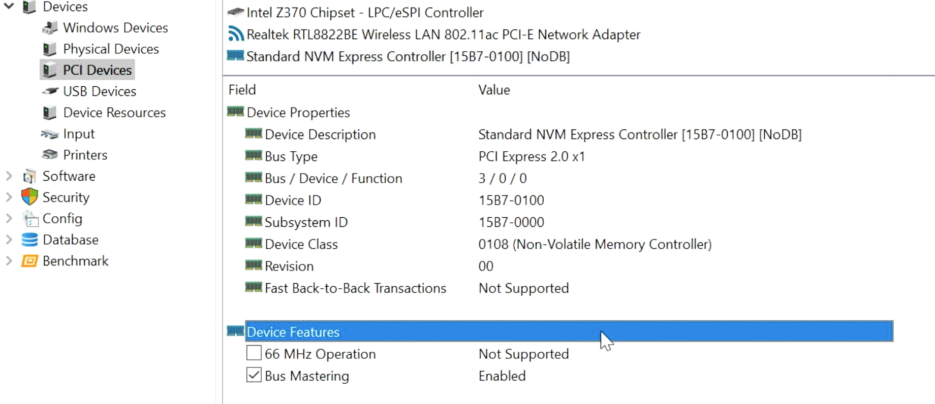

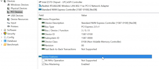

so i tried leaving machine for 24h in bios with ssd plugged in. also freezing it, heating it, reflowed nand and controller - nothing.
tried shorting that resistor again and gave machine a reset. after reset unknown device changes to standard nvme adapter. does that mean anything?

Dropping it into safe model only proves the health of the controller, it's a diagnostic test rather than a fix. The only other thing you can now try is to move the nand to another identical working donor drive. I don't think for a minute it will help but you can at least then say you have tried everything.

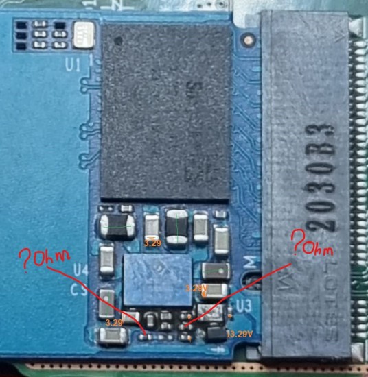

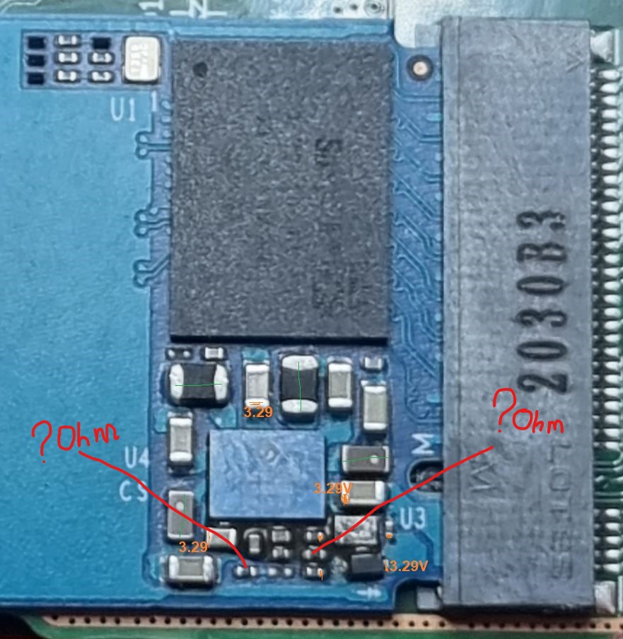

Hi friend! May I know the resistance of the resistors marked in red?
There was a short circuit on the radiator. It needs to be checked.
