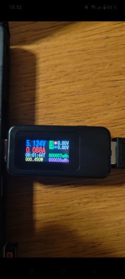

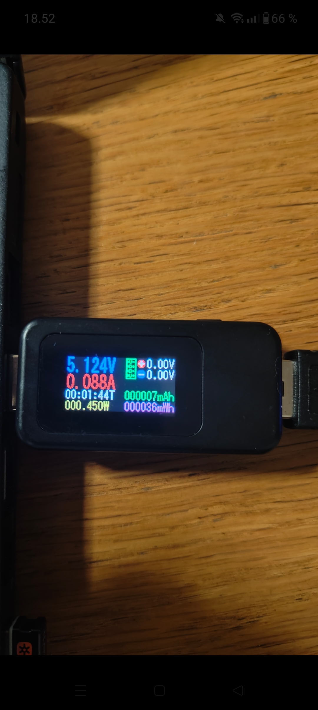

I do have one but its only pulling 86mA and thats what the enclosure pulls. I removed the hdd and ,it pulls 86.

After plugin enclosure with hdd in, to the usb wall adapter, i see current consumption is 0.31A. after few second, it drops down to 0.092A. and it just run in a loop.

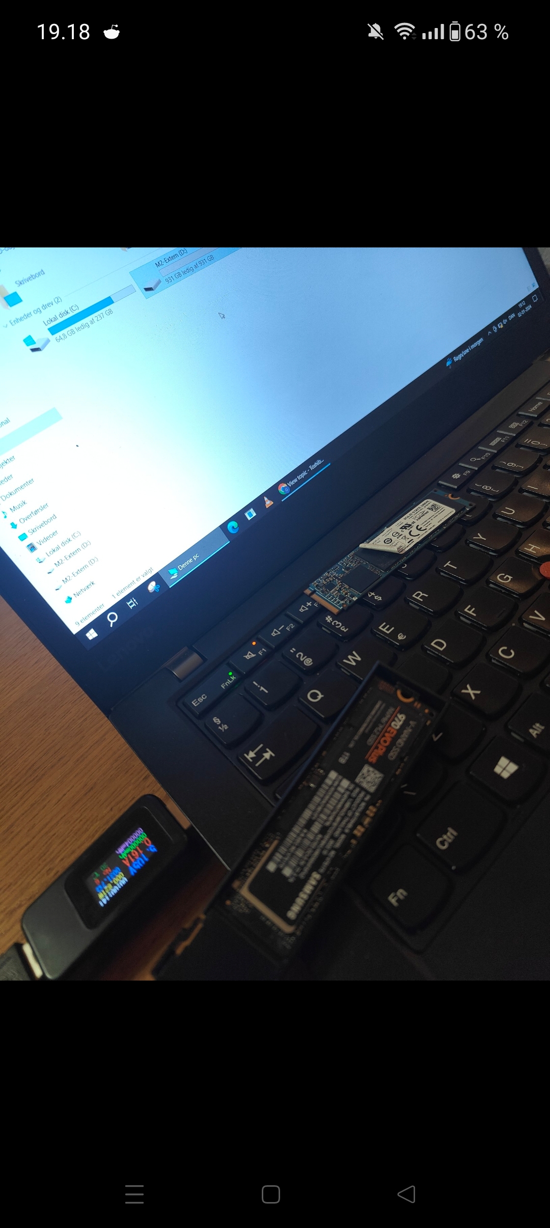

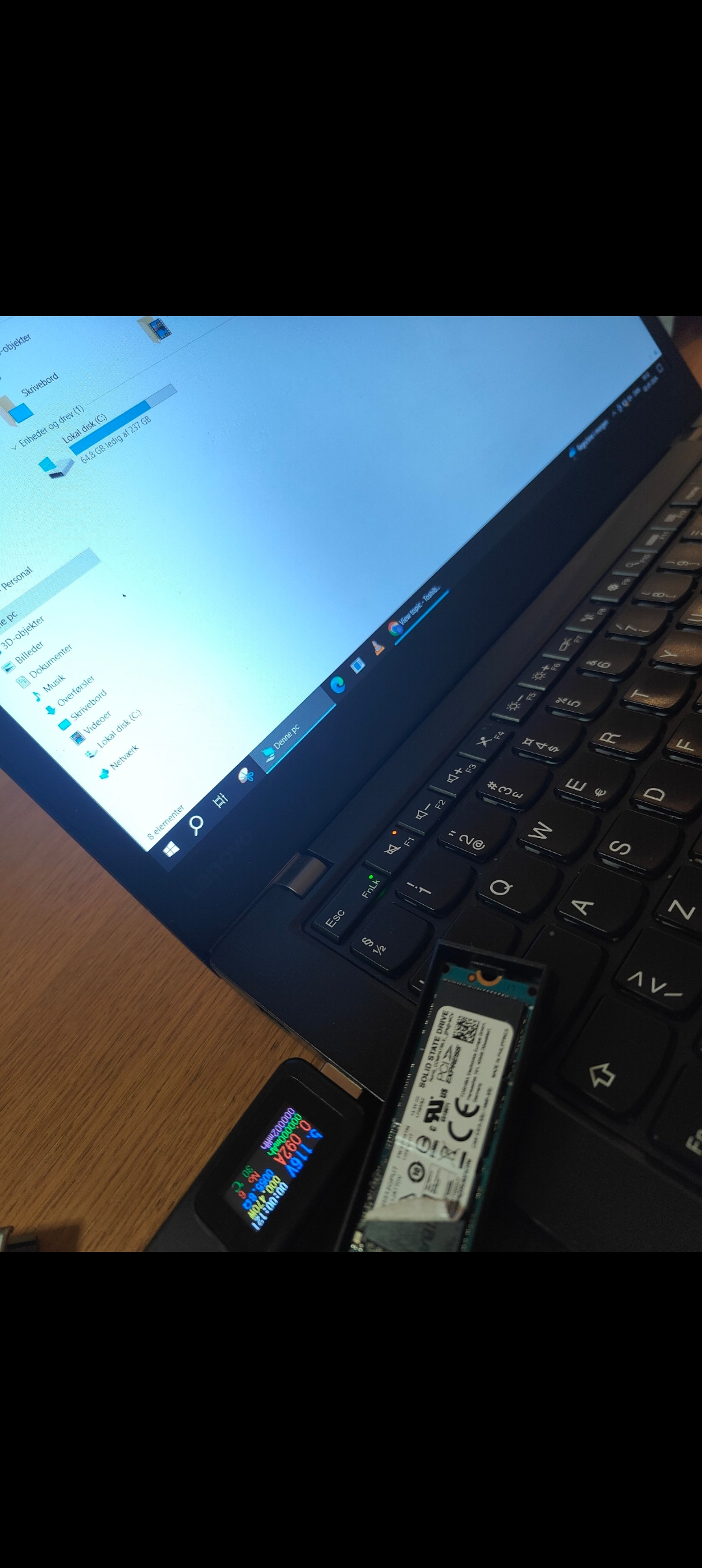

Here is two pic.
One with "dead" m2
One with my second hdd, samsung evo..
As you see its working. I believe pin 38 is the devsleep , and its located on the bottom side, thats not possible for me to measure

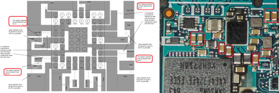

The capacitor on the A1 ball (top left corner) is the only thing left, AFAICT.
LDO = low dropout linear regulator
Re: Toshiba m2 died
January 2nd, 2024, 15:06
AIUI, the ZSA0 chip switches on when its ON pin rises above 1.1V.
The PMIC has a UVLO threshold of 2.7V and a hysteresis of 100mV. This means that it switches on when Vin rises above 2.7V and switches off when Vin drops below 2.6V. IIUC, Vin for the PMIC comes from the Vout pins of ZSA0.
The CBZ chip is a temperature sensor.
The SD and 6AGRVI (?) chips are a mystery to me.

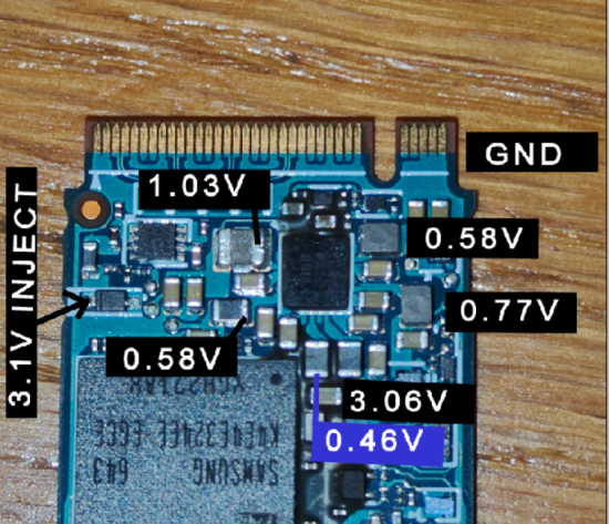

What voltages do you measure at the PMIC inductors?
I would increase the Vin supply to 3.3V and carefully increase the current limit while measuring the PMIC outputs. If you get to the stage where all the voltages are at their correct levels, then this would point to ZSA0.

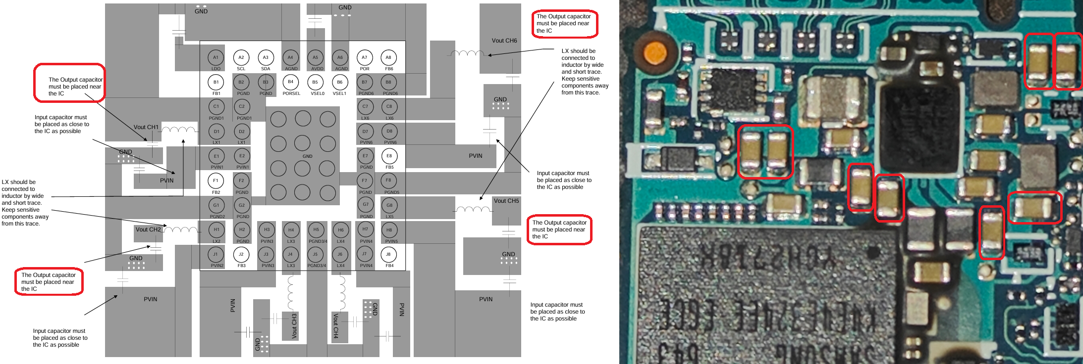

January 2nd, 2024, 16:25
Supply Input Voltage Range : 2.9V to 5.5V
Six High Efficiency, Low Voltage Buck Converters
CH1 : 2.3V to 3V in 25mV step, Output 4A max.
CH2 : 0.9V to 1.6V in 25mV step, Output 1A max.
CH3 : 1.5V to 2.1V in 25mV step, Output 1A max.
CH4 : 0.7V to 1.3V in 25mV step, Output 2A max.
CH5 : 0.7V to 1.3V in 25mV step, Output 1A max.
CH6 : 0.7V to 1.3V in 25mV step, Output 3.5A max.

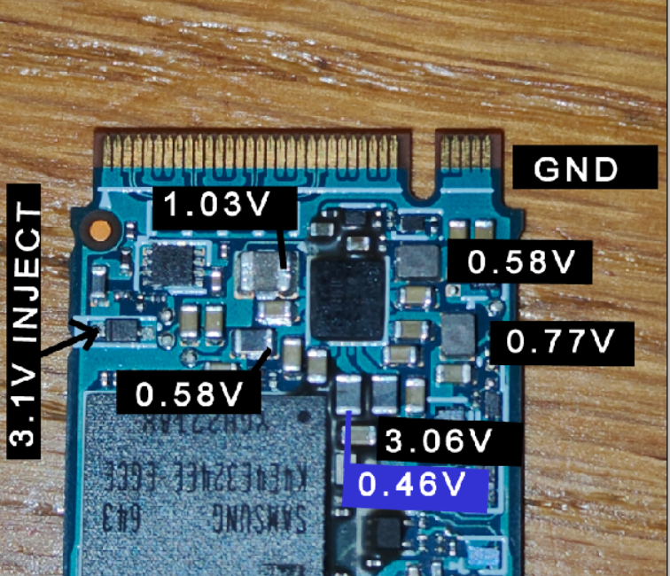

here i have injected 3.1V , at 100mA max.

January 2nd, 2024, 16:40
Channel 4 appears to be too high (3.06V).
CH4 : 0.7V to 1.3V
I would measure the resistance between ZSA0-Vout and PMIC_CH4_out. If this resistance is low, then this could mean that the internal MOSFET switch of the PMIC is shorted on that channel.
Since the voltage range maxes out at 1.3V, this would suggest that CH4 is a Vcore supply. This in turn would suggest that both the controller and PMIC are damaged.

Re: Toshiba m2 died
January 2nd, 2024, 16:46
fzabkar wrote:Channel 4 appears to be too high (3.06V).
CH4 : 0.7V to 1.3V
Measures around 4-500 Kohm
