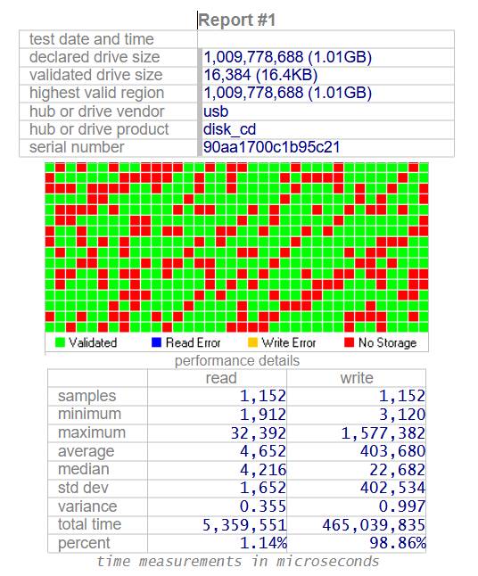

Heres something interesting I found after using validrive. It looks like it only validated 16kb of storage space. Maybe the controller died?
Report.docx [18.28 KiB]
Downloaded 409 times

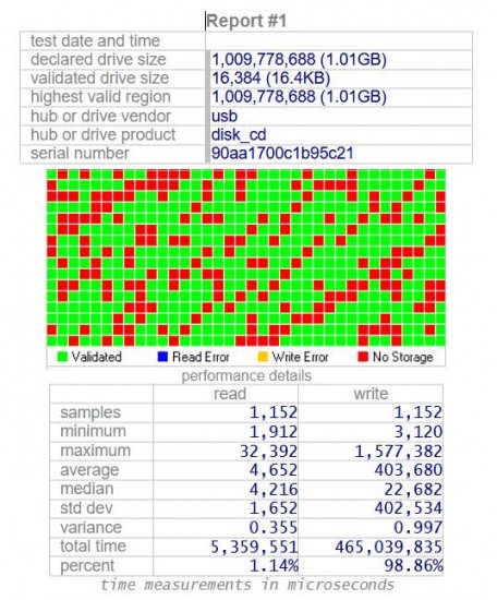

ValiDrive is extremely clumsy as is demonstrated by its report. Just another of SG's f*ckups
The graph does not at all support the conclusion.

But that tool would work on confirming chinesium drive sizes?
And forgot to mention the drive went corrupt after being dropped from my desk (it was from around 80 centimeters). I guess the problem will be the controller or the flash itself (its unbranded with "HVNE4F4 1025" written on it).
