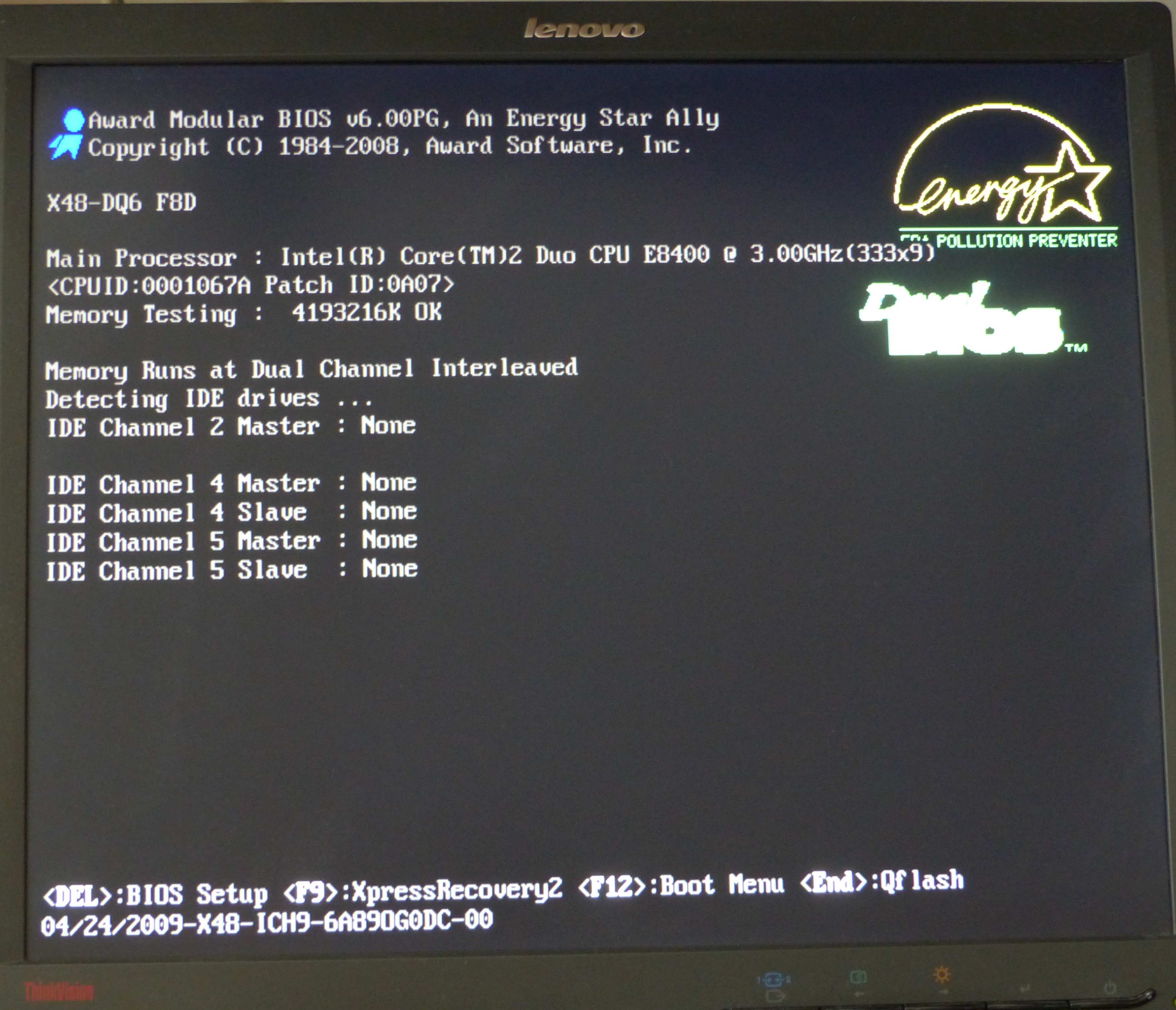

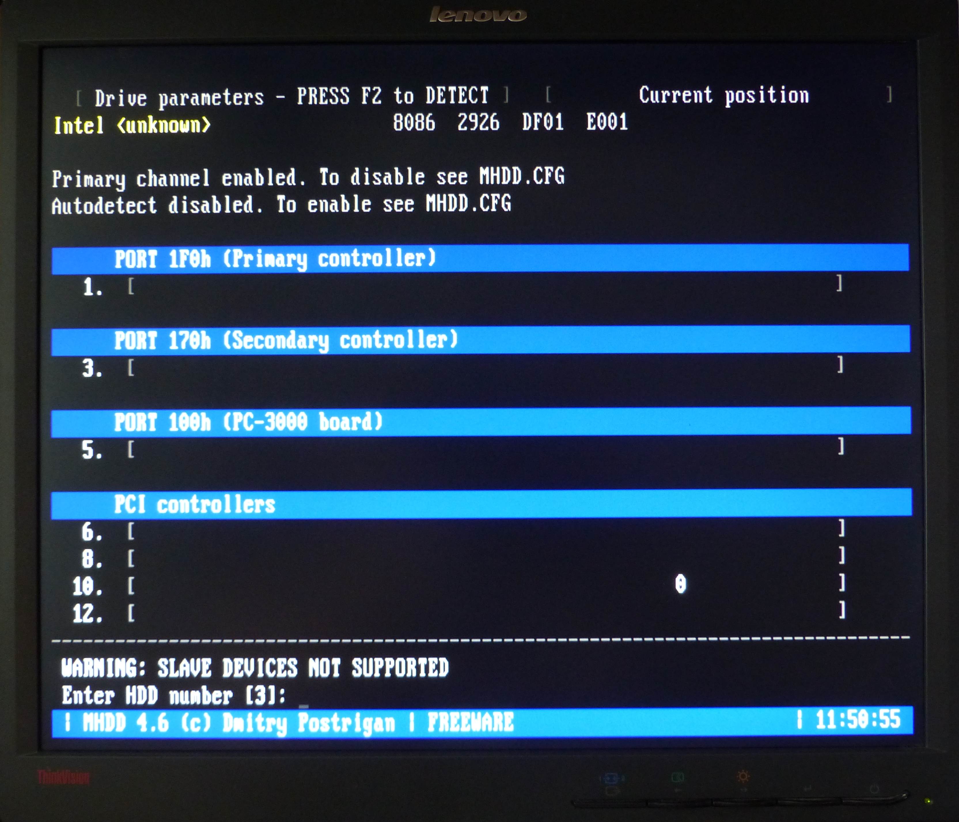

Relevant photos, I think.

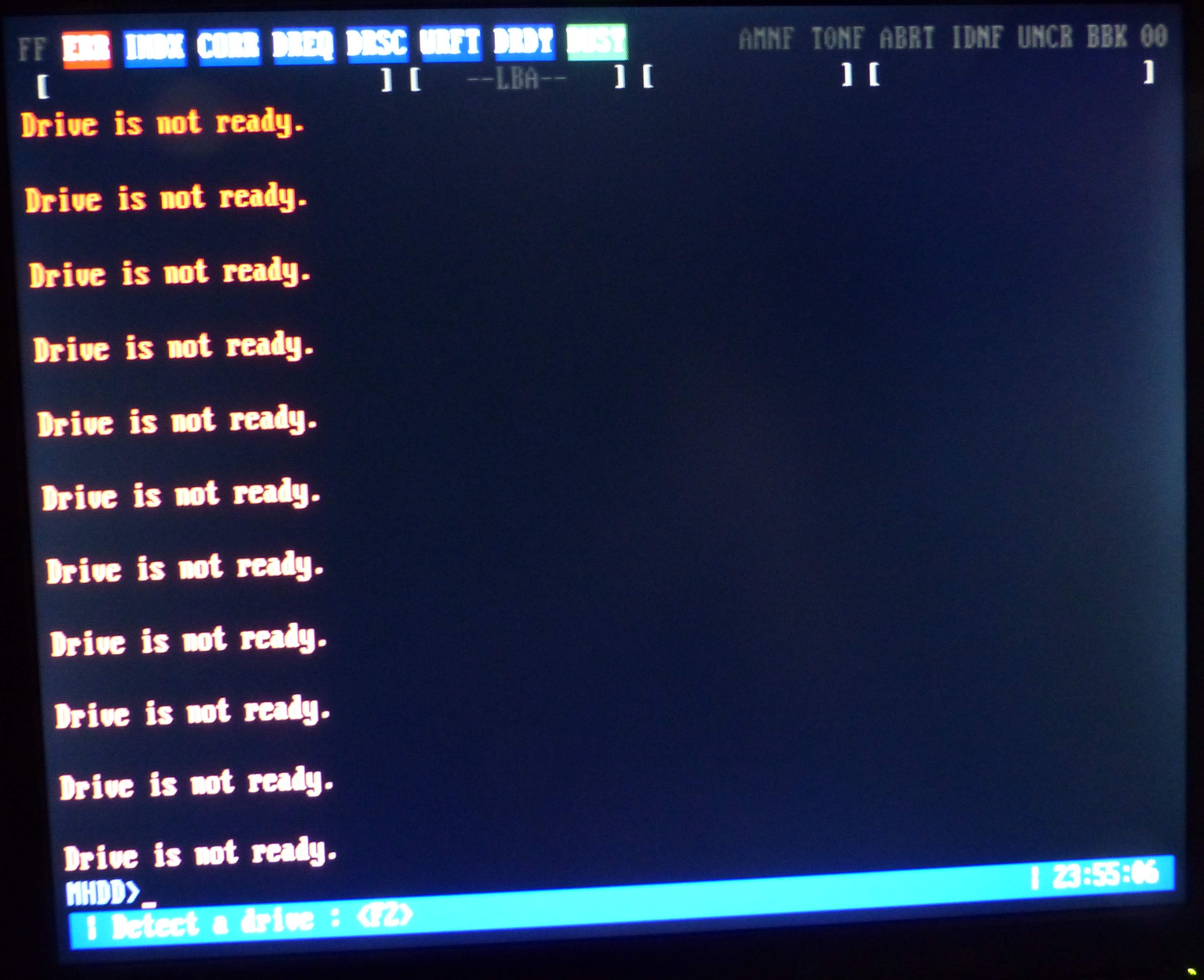

 Post subject: Re: SanDisk X100 256G no BIOS detection
PostPosted: June 17th, 2018, 5:41
Joined: January 10th, 2016, 18:26
Posts: 28
Location: romania
Bad action :D
PostPosted: June 17th, 2018, 16:26
Posts: 17232
ICBW, but ISTM that the "FF" in the Err register suggests that the drive could be brain dead. Alternatively, it could just be that the drive does not communicate until it has loaded its firmware.
I would check the crystal and the outputs of each of the supply supervisor ICs. If the crystal is not oscillating, or if one of the supervisors is holding the flash controller in the reset state, then that could explain the symptoms.
BTW, you can use a TSR program called Snarf to capture MHDD screen shots.

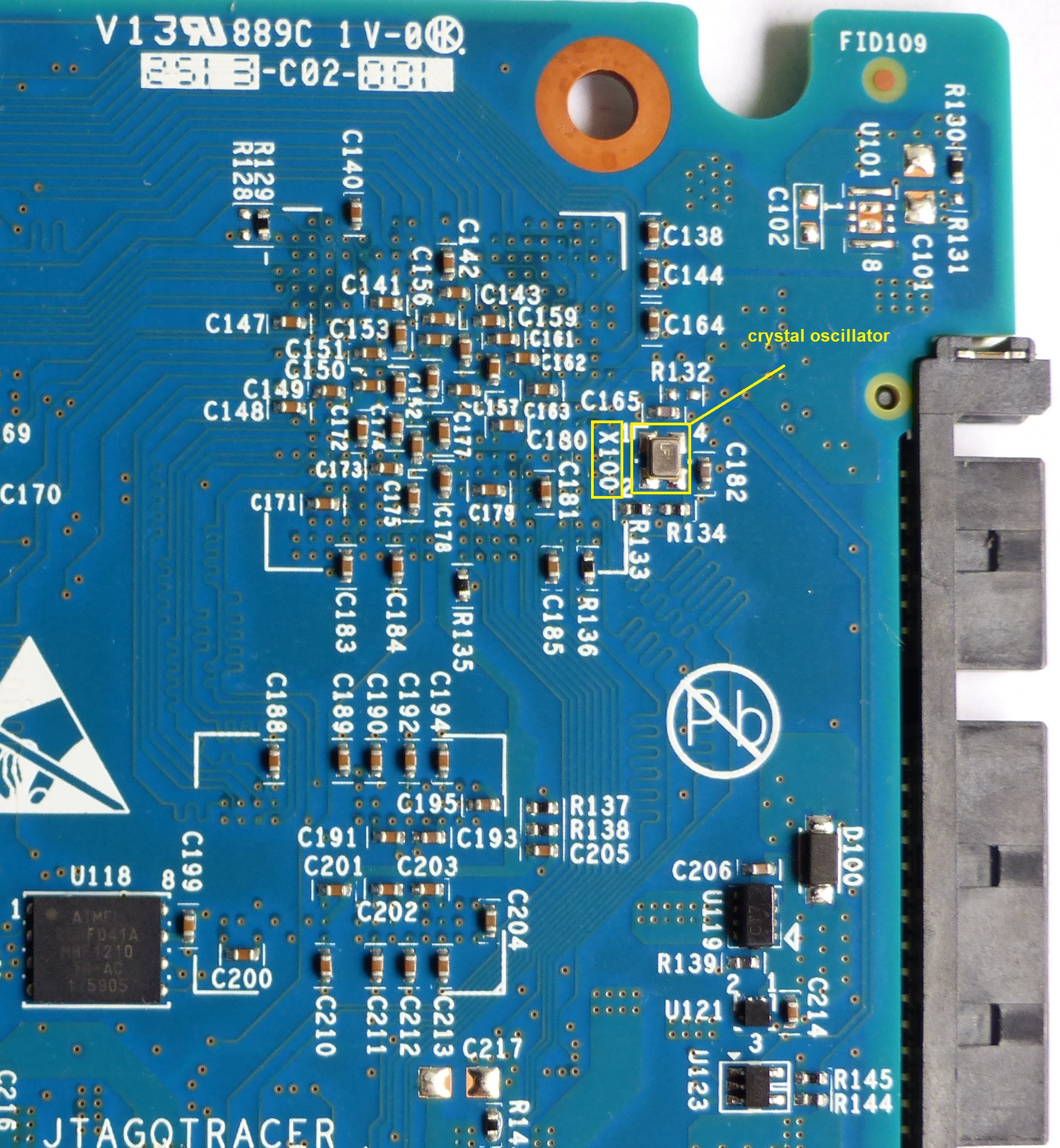

PostPosted: June 18th, 2018, 3:47
Posts: 28
Location: romania
Crystal Oscillator is the one I have noted X100 ?!
PostPosted: June 18th, 2018, 15:26
Posts: 17232
Yes.
Generally speaking, when you troubleshoot a microprocessor based PCB you ...
1/ check the supply voltages
2/ check the crystal oscillator
3/ verify the power-on reset pin(s)

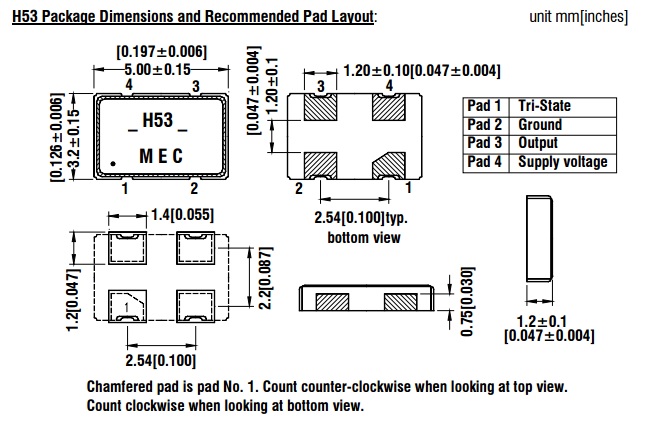

Hi there,
After a long period of convalescence I'm trying to get into activity.
So I managed to check the crystal oscillator marked as X100 and there in no value in Hz scale for the multimeter. The value of voltages measured ​​(pin 2 as ground) are of the mV order (less than 5mV) and bring fast to zero.
The pins are like this:
I did not succeed in identifying its value because the IC does not write anything than LF.
PostPosted: August 17th, 2018, 16:43
Posts: 17232
X100 appears to be a simple crystal rather than a crystal oscillator. The latter incorporates electronic circuitry wherease the former does not. That said, pins 1 and 3 should be biased at a DC level corresponding to half the supply voltage of the flash controller. Furthermore, I doubt that a multimeter has a frequency range in the tens of MHz. Instead you would need an oscilloscope.
