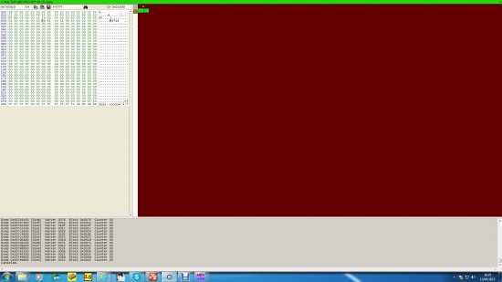

Can't find one of those, but found a dump from another 528 page device.
Hex dump attached starting from FAT
As you'll see, the SA data is present in the last 16 bytes, with bytes 516/517 being the block number. The FAT block has block number "00 01" as we'd expect.
300k.rar [250.23 KiB]
Downloaded 1600 times
 Post subject: Re: Help needed - Serious challange with this one
PostPosted: May 13th, 2015, 11:31
The next block (0x4200 on) is block "00 06" (from bytes 516/517) and we can see FAT entries for files there...
So, the blocks are out of sequence due to wear levelling.

@pcimage, many thanks for your enlightening data. It appears that the OP's job would probably already be done if he had started it with a good dump. (I like to start my days the same way.)
I notice that the FAT16 boot sector (in your example) is located at sector 33. There are then two FATs, each spanning 31 sectors. This means that the root directory would be located at sector 96. That's on a 16KB block boundary. The boot sector's BPB is reporting a cluster size of 32 sectors, so it appears that each cluster corresponds to, and is aligned to, a single NAND block. This leads me to wonder how many formatting tools are able to align FAT (or NTFS) volumes in the same way.
As for the FTL, does this mean that the flash controller scans the block numbers on power-up and then assembles a map in RAM?

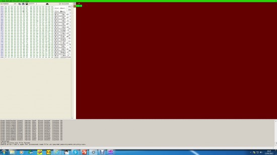

I have some new dumps from BeeProgPlus programmer but i believe that they are bad. I will post them in a while as soon as i get home.. but as we in Portugal usually say "my tail is down".. :'(

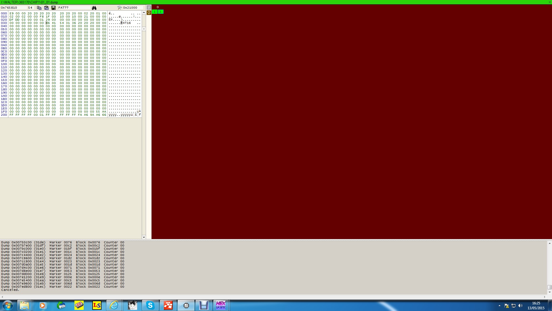

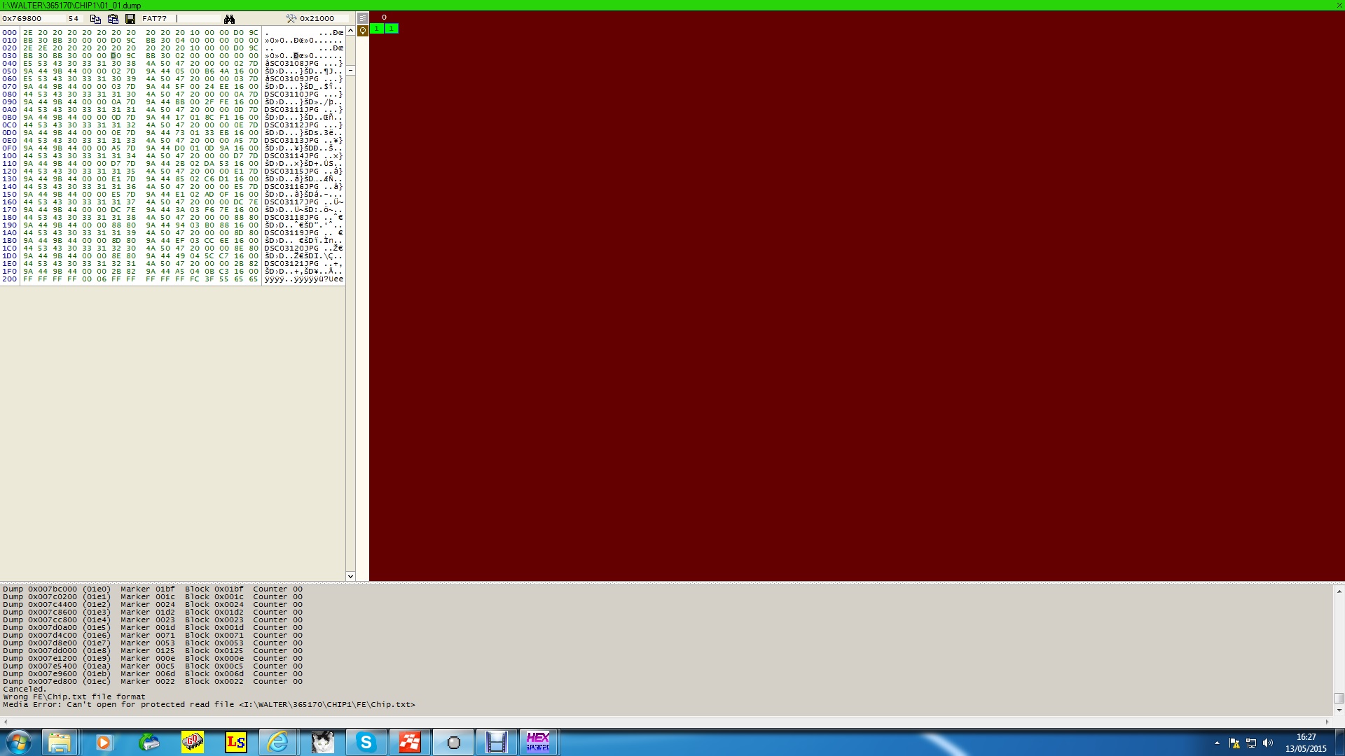

New dumps here:
http://www.joaocesarsilva.com/echo/new_ ... ogplus.rar
Sadly... it seems to me that these are of no help. Give it a check...
PostPosted: May 15th, 2015, 19:17
Posts: 17328

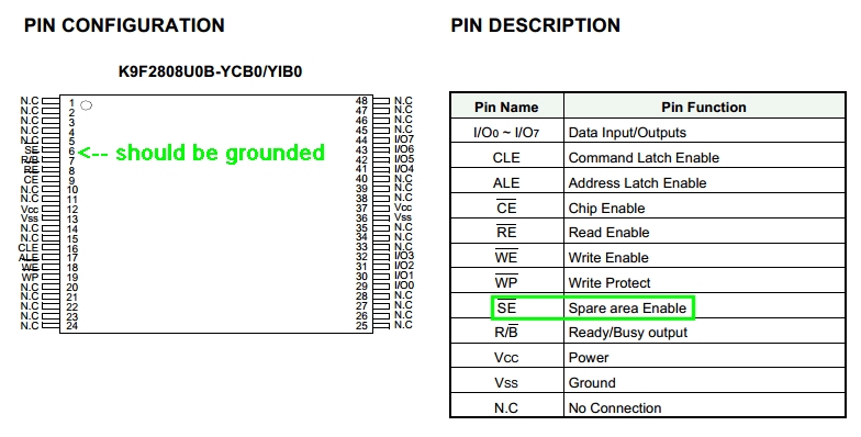

The latest dumps have the same problem. Worse still, the firmware sections are missing. :?
On the plus side, your latest dumps are identical, so there is some hope that there are no bit errors in the user data area.

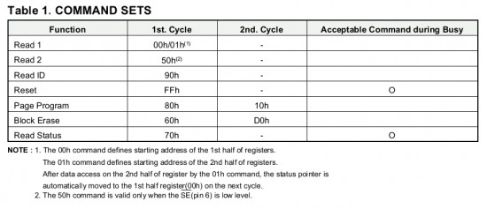

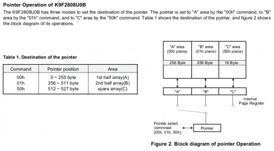

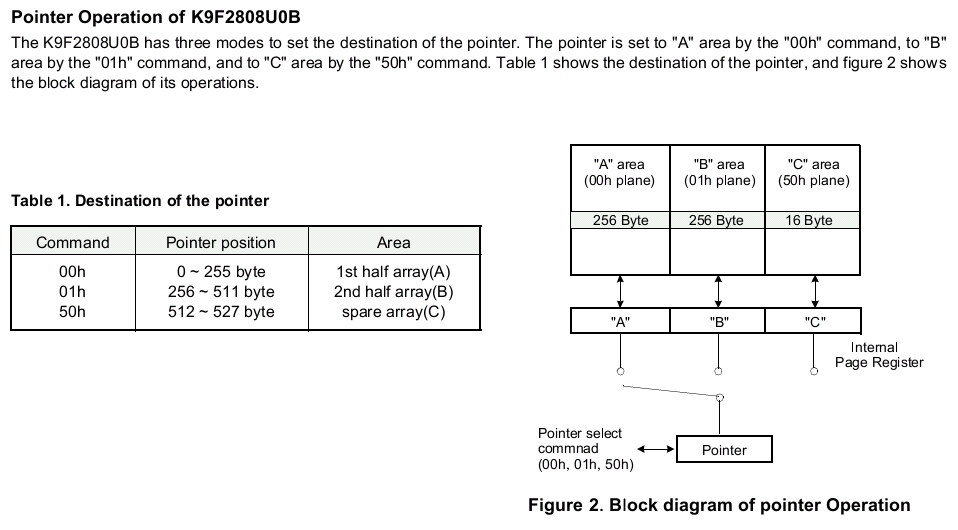

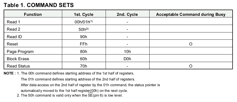

I notice that your chip has an /SE pin that more recent flash chips do not need. I suspect that you need to ground this pin in order to be able to read the spare bytes.
Spare Area Enable (SE)
The SE input controls the access of the spare area. When SE is high, the spare area is not accessible for reading or programming. SE is recommended to be coupled to GND or Vcc and should not be toggled during reading or programming.
Furthermore, the way that the spare area is accessed in this early chip differs from later ones. ISTM that the reason that the programmer is reading the first 16 bytes of the data area instead of the spare area may be that the pointer is being incorrectly set and/or the wrong command is being used.

Just isolate pin #6 from the programmer and run a wire from the IC socket or adapter to ground. If that doesn't work, then worry about the commands.
I suspect that those special commands are only required if you need to explicitly reposition the pointer. If you read the page starting from location 0, then I suspect that the pointer will automatically advance to the spare area. At the moment, because the spare area is disabled, the pointer appears to be skipping over this area and advancing to the next page.

I should add that IMHO it would be best to plug your chip adapter (a DIP type?) into a machine socket (aka turned-pin IC socket), then cut pin #6 from the IC socket so that it no longer connects to the programmer, but leave just enough of a stub so that you can solder a ground wire.

Is NAND pin #6 grounded on the DOC PCB? If so, then that's your answer.
