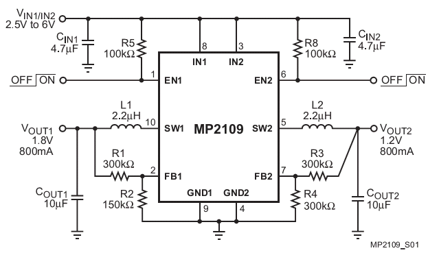

MP2109DQ, Monolithic Power, Dual 1.2MHz, 800mA, Synchronous Step-Down Converter, 2.5V - 6V in, marking B7xx:
https://www.monolithicpower.com/pub/media/document/MP2109_r1.4.pdf
