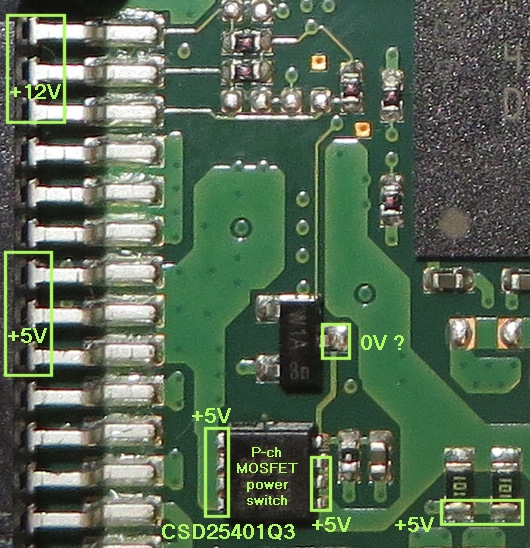

zzattack wrote:
Resistance and voltages on the possibly dead PMOSFET measured the same on the donor board so I went ahead and performed the transplant from a 128GB MX100 donor disk. Success! The disk got recognized and I managed to dump all contents :)
Thanks so much for your help troubleshooting fzabkar!
Can you tell me where this mosfet is located? I have a similar problem with the msata version, but I cannot locate the mosfet ...
Thanks!
 Post subject: Re: Crucial MX100 repair after PSU failure
PostPosted: January 21st, 2017, 7:59
Joined: March 28th, 2014, 9:11
Posts: 44
Location: Nederland
fzabkar posted an image with it marked on the first page (download/file.php?id=12608)
Note though that this mosfet seemed to have survived. It was the MSP430 that needed replacing.

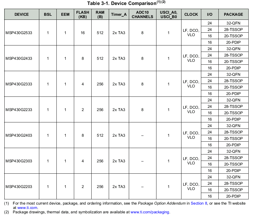

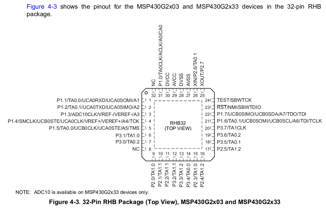

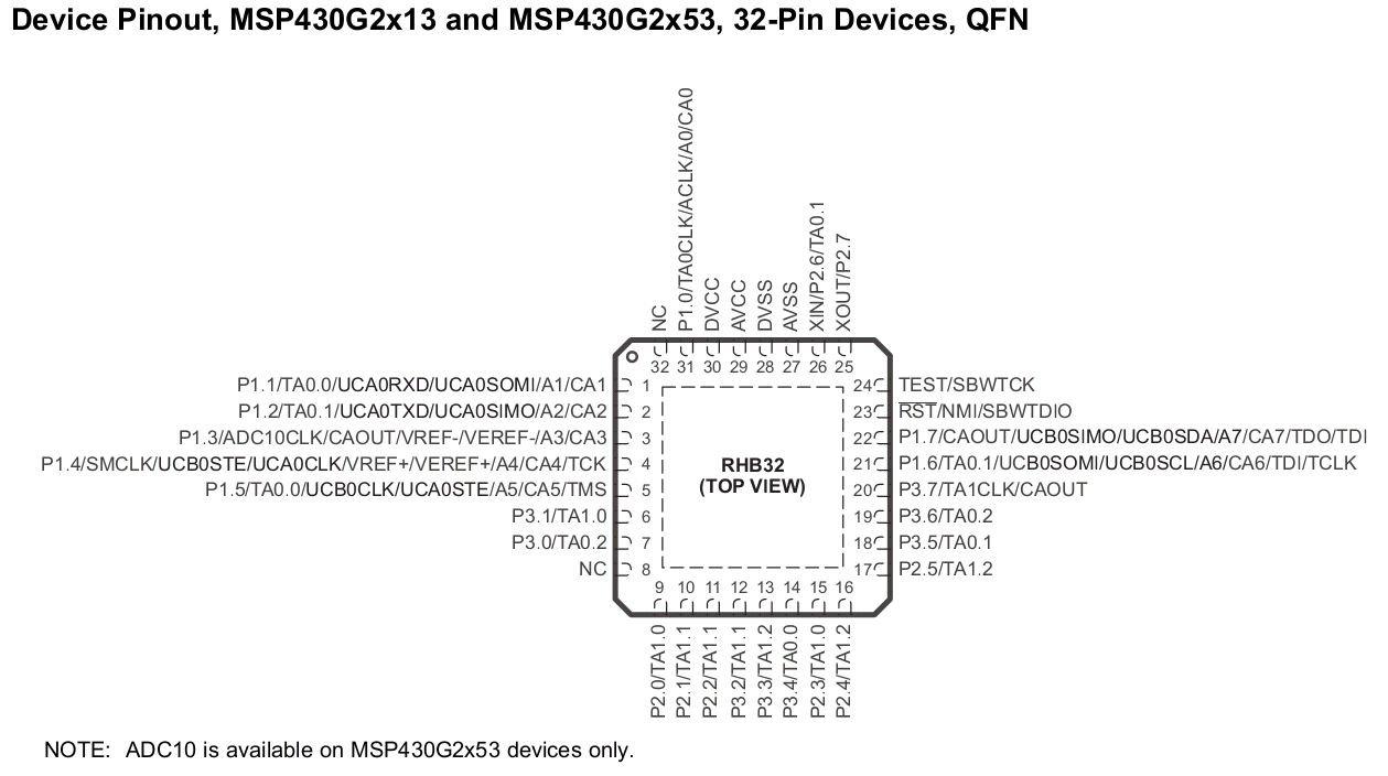

Update:
The following devices appear to have a matching pinout:
MSP430G2x33, MSP430G2x03, Texas Instruments, Mixed-Signal Microcontroller, Ultra-low Power, 1.8V - 3.6V, RHB32:
http://www.ti.com/lit/gpn/MSP430G2533
MSP430G2203 Device Erratasheet (Rev. I)
http://www.ti.com/lit/er/slaz412i/slaz412i.pdf
MSP430G2x53, MSP430G2x13, Texas Instruments, Mixed Signal Microcontroller, Ultra-low Power, 1.8V - 3.6V, RHB32:
http://www.ti.com/lit/gpn/msp430g2453
MSP430G2153 Device Erratasheet (Rev. I)
http://www.ti.com/lit/er/slaz409i/slaz409i.pdf
The recommended applications for the 2x33/2x03 parts include "power management and sensor interface".
       analogue
p/n    comparator   10-bit DAC
2x03   no           no
2x13   yes          no
2x33   no           yes
2x53   yes          yes
              flash/ RAM
MSP430G2403 - 8KB / 512B  *
MSP430G2303 - 4KB / 256B  **
MSP430G2203 - 2KB / 256B
ISTM that the MSP430G2303 and MSP430G2403 devices might be suitable.

Got replaced one at the time and tested each time: 1) 5505, 2) MSP430 (in original it was V402, from donor I got V592, but hoped, that it still can work), 3) 25P16 and 4) W1A mosfet. But still no initialisation...
I have measured voltages on board, see pisture below:
Donor board is short version, but all power lines seemed same:
So Iˇm asking for help, what can I do to find problem.
Unfortunally I donˇt have any specific hardware to repair HDD/SSD, as Iˇm regular electronic repairman.
PS, sorry for my english, donˇt speak it very well.
PostPosted: February 28th, 2019, 16:08
Posts: 17091
1/ I don't know whether the two MSP430 firmware versions are compatible.
2/ A supply voltage of 2.02V for the SPI flash memory seems too low. I would check the small square chip at the bottom left corner of the MSP430.
