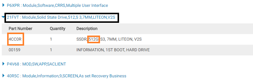

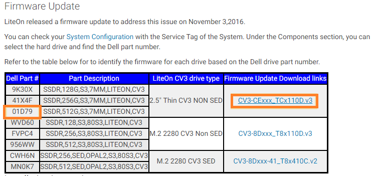

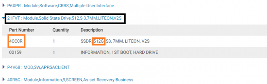

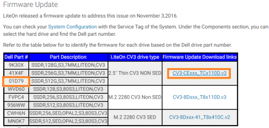

I've been going over this page with a fine tooth comb since it definitely describes the failed drive to a T.
http://www.dell.com/support/article/au/ ... em?lang=en
Installing the firmware update seems like a relatively easy thing to try, so I'm going to give it a shot. I tried to confirm if I was already using the firmware updates since the one in the article is over a year old but I can't confirm the firmware version in dell account, it only shows firmware for my current system with my service tag (which now lists my current Samsung SSD), though I can browse the previous version's components, which the liteon is listed.
It seems like there could be some risk if I don't know what I'm doing (and I don't), so I'm being very cautious. First, I need to be sure of exactly the drive name/type and to install the correct the firmware.
I just want to make sure I'm working with the correct firmware for now. I downloaded this one for part number 01D79 for SSDR,512G,S3,7MM,LITEON,CV3.
http://www.dell.com/support/home/au/en/ ... erId=FCX34
Under the component section in dell, what appears to be the dell part number, is different, so I'm a little hesitant.
Can someone confirm I did download the correct driver. I noticed there is only one 512G part description in the firmware download options, and I confrim this number in my component section, so I'm reasonably sure it is correct. I attached some images.
Sorry if this seems overly cautious in something that should be straightforward.

The update will check your drive for compatablity, or should! It looks to me like the right download.

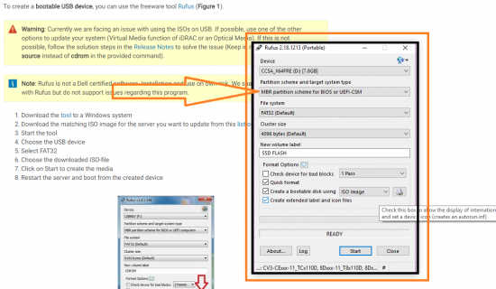

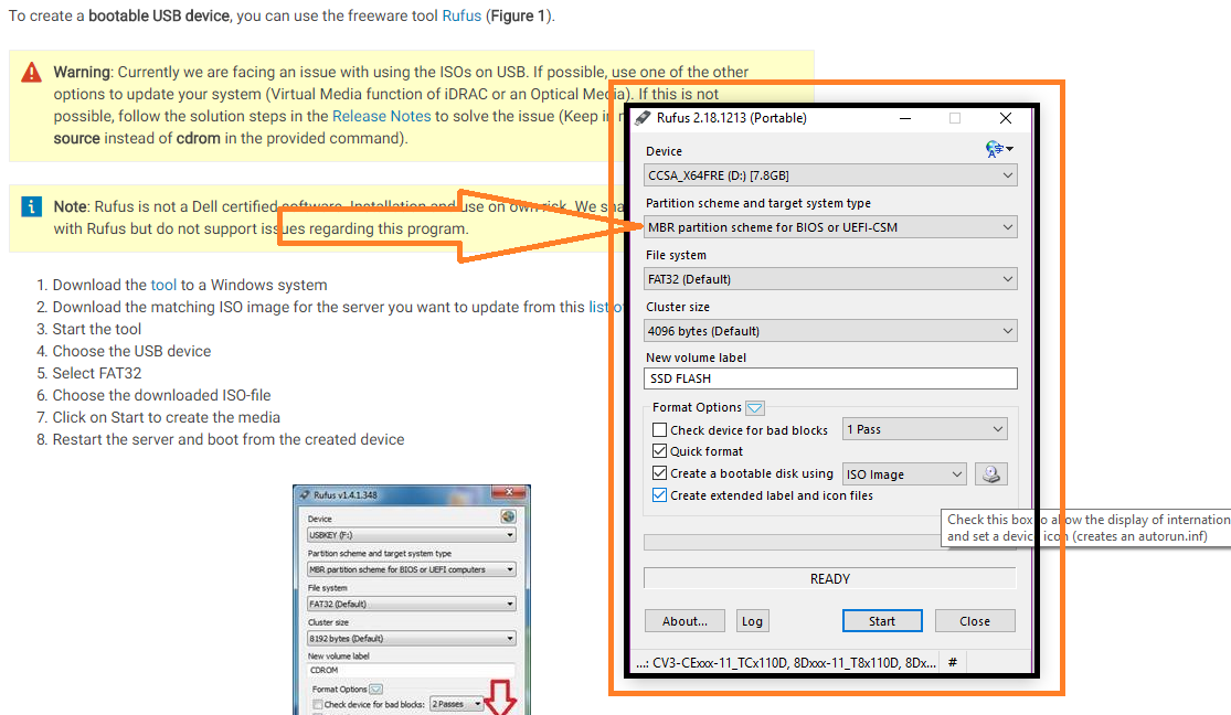

1. Remove my current samsung SSD from laptop.
2. Insert the Liteon.
3. Boot from Thumbdrive and run the DOS firmware updater.
Attached are the settings I used in Rufus. There were no explicit instructions for writing this specific DOS Iso but I followed the instructions as best I could and used the only available BOS target option.
