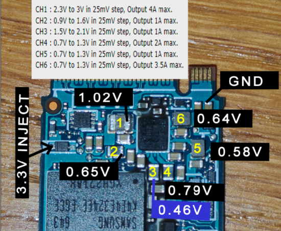

I'm stumped. It does seem that CH4 is not regulating, though.
Would it be possible for you to remove the inductor on CH4 and see whether the supply remains alive?
Or perhaps you could wait for someone else to chime in and offer some better advice?

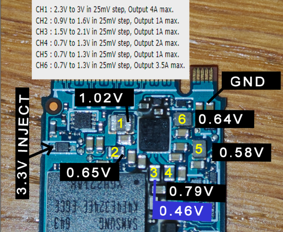

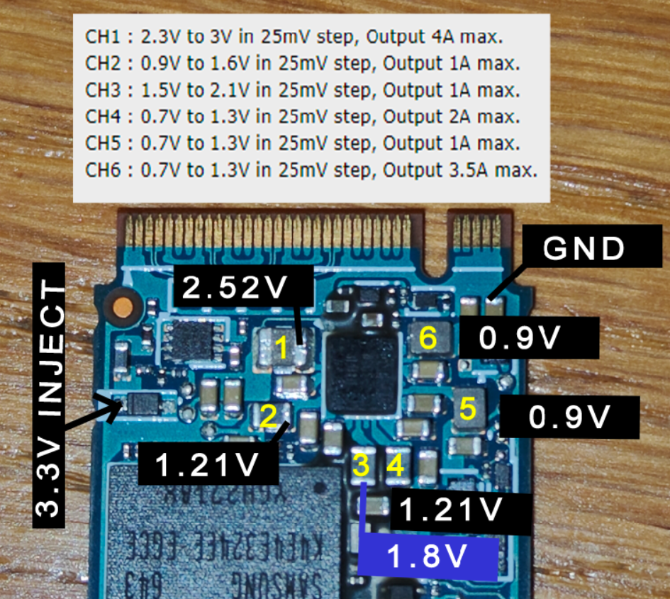

i re-injected, now with 3.3V in
here are the result
 Post subject: Re: Toshiba m2 died
PostPosted: January 2nd, 2024, 17:02
Posts: 17256
Are you still limiting the current? I confess that these results make no sense to me. :-?
Edit: I see you have edited your image. Now the results make sense. It seems that you just need to increase the current limit.

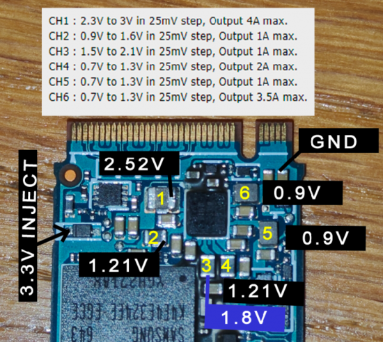

Im not sure about the CH4, after measuring it twice it gave in the first run 3V, but now after injecting 3.3V , now it gives med 0.79V.

ah my silly brain, stopped working, yes there were current limit on, now i set the limit to 500mA and ch1 voltage raised to 2.52V. Give me a min, i have fresh voltages
PostPosted: January 2nd, 2024, 17:07
Posts: 17256
This would make sense if the feedback ball of the PMIC was intermittently open circuit on that channel. In other words, the PMIC incorrectly senses that there is no output on that channel, and it then drives the MOSFET to its limits in an attempt to increase the voltage.

Here the results with current limit of 0.5A at 3.3V input
PostPosted: January 2nd, 2024, 17:13
Posts: 17256
All looks good to me.

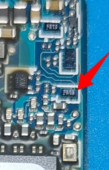

I notice that channel 4 feeds the "XM" IC, but I don't know what it does. Maybe it's another load switch?
PostPosted: January 2nd, 2024, 18:39
Joined: December 30th, 2023, 17:17
Posts: 53
Location: Denmark
You might want to confirm that the same voltages appear at the inputs and outputs of each load switch.

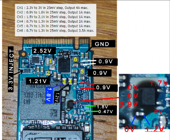

Here re voltages after injecting 3.3V at 500mA.
PostPosted: January 2nd, 2024, 19:05
Posts: 17256
It looks like the 1.8V load switch has failed. I would identify those components which are connected to the output of this switch, in particular the small bypass capacitors, especially the ones in the 64C area. It might be difficult to find the culprit if the fault is/was intermittent.
You may be able to recover the data by bypassing this switch, as you suggested earlier, but I would first try to find the problematic component. If you don't, then the PMIC may be directly exposed to any short that resurfaces.
I'm still bothered by your results for CH4. Hopefully this problem has gone away.

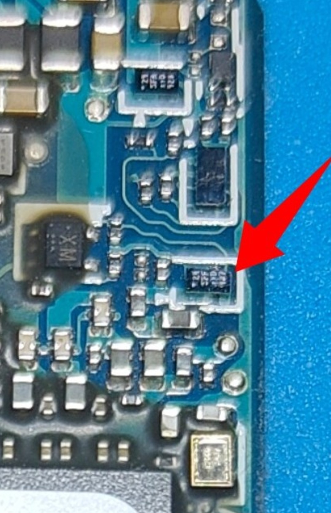

It looks like the 1.8V load switch has failed. I would identify those components which are connected to the output of this switch, in particular the small bypass capacitors. It might be difficult to find the culprit if the fault is/was intermittent.
It look like we are back at the broken load switch again;) dont you think the broken side has effected?
I tried earlier to short in and out for switch, but i didnt see any reaction or changes
When you say ch4, do you mean the 1.2V output? Whats wrong with that?
I will try to find the bad component first otherwise i I will try to bypass it tomorrow and see what happens

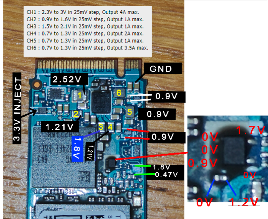

PostPosted: January 3rd, 2024, 12:57
Posts: 53
Location: Denmark
I had to measure all the components again, directly supplied throug usb., no external injection.
there are 3 places where i am able to measure a voltage
