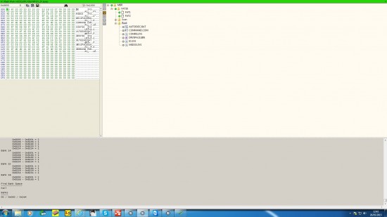

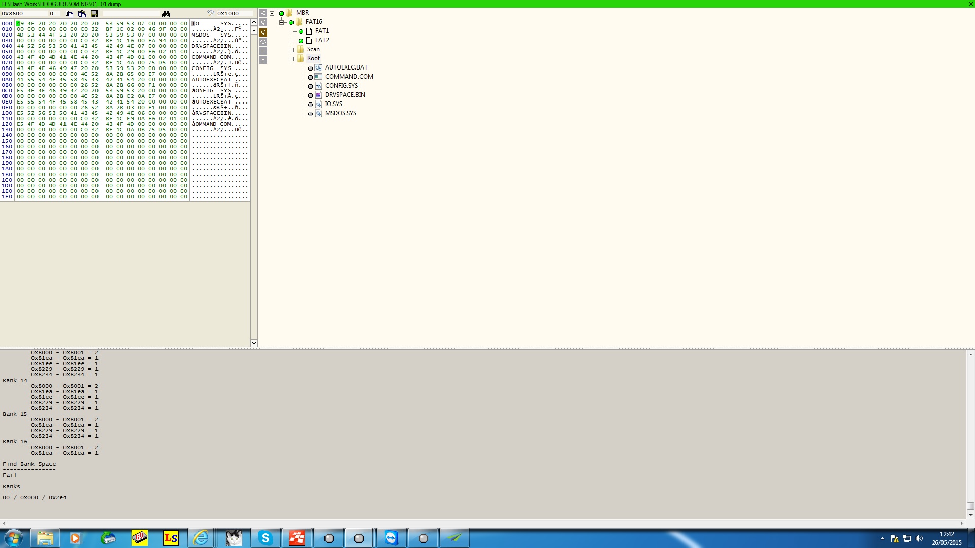

Using block size of 0x4200 and markers at 521/520 I have rebuilt the dump...

Here's the image file dump...
https://www.hightail.com/download/bXBhZ ... SWZOTzhUQw
 Post subject: Re: Help needed - Serious challange with this one
PostPosted: May 26th, 2015, 7:55
And running GDB on the image produces this data (root folder names lost)...
https://www.hightail.com/download/bXBhZ ... MTQxWjhUQw
