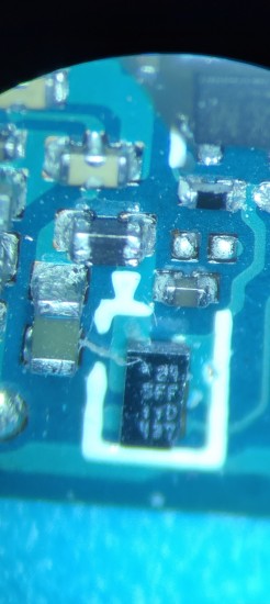

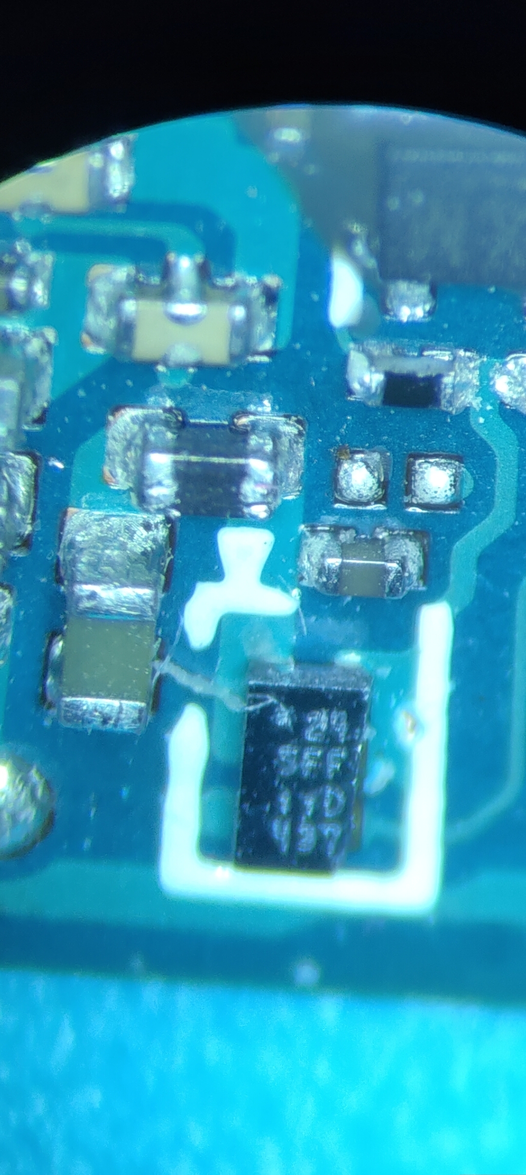

Here is a picture of the 1.8 load switch area.
There is not much , there is two cap and a filter. no short.
Cap on the left, bottom side is GND.

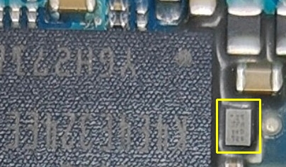

All the supply voltages seem OK, and there are no longer any shorts, but something still appears to be overloading the USB port.
I don't know the functions of SD, 6AGRVI and XM.
Did you check the output voltage and resistance to ground at this IC?

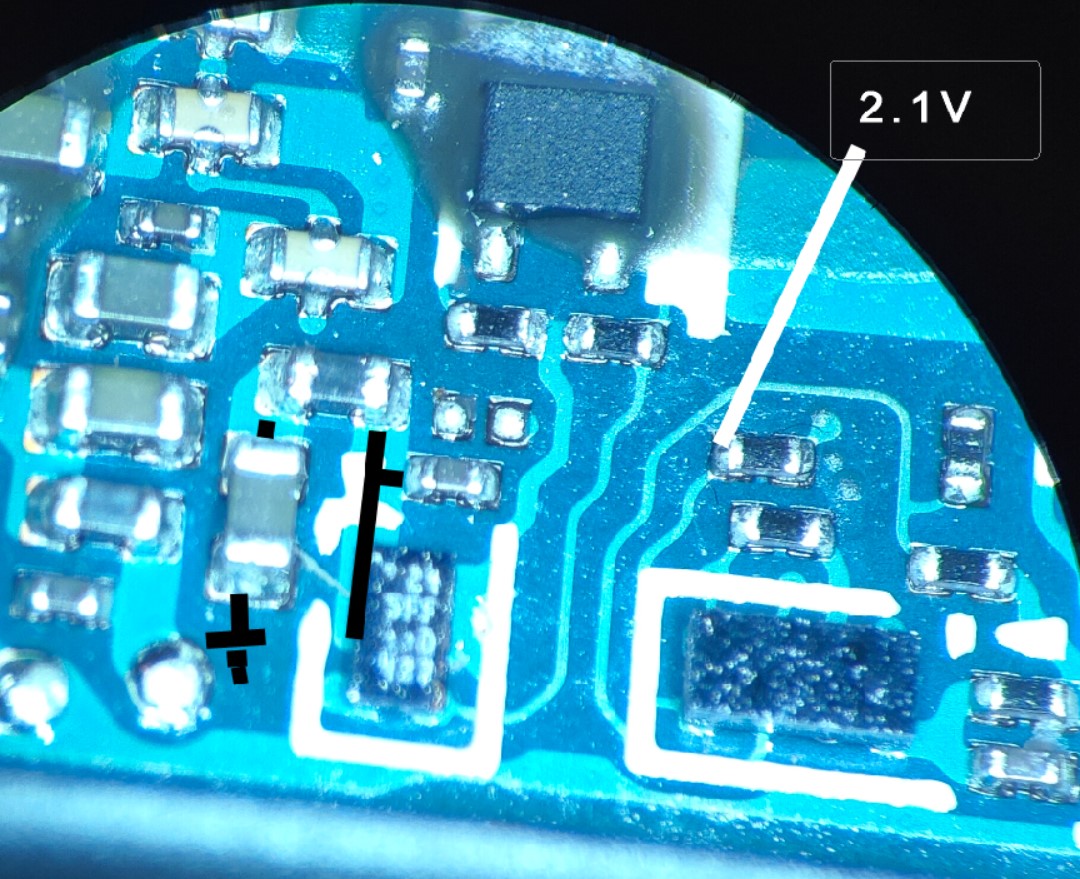

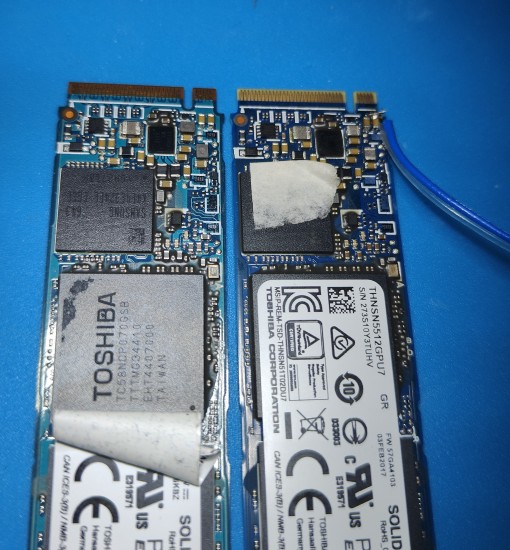

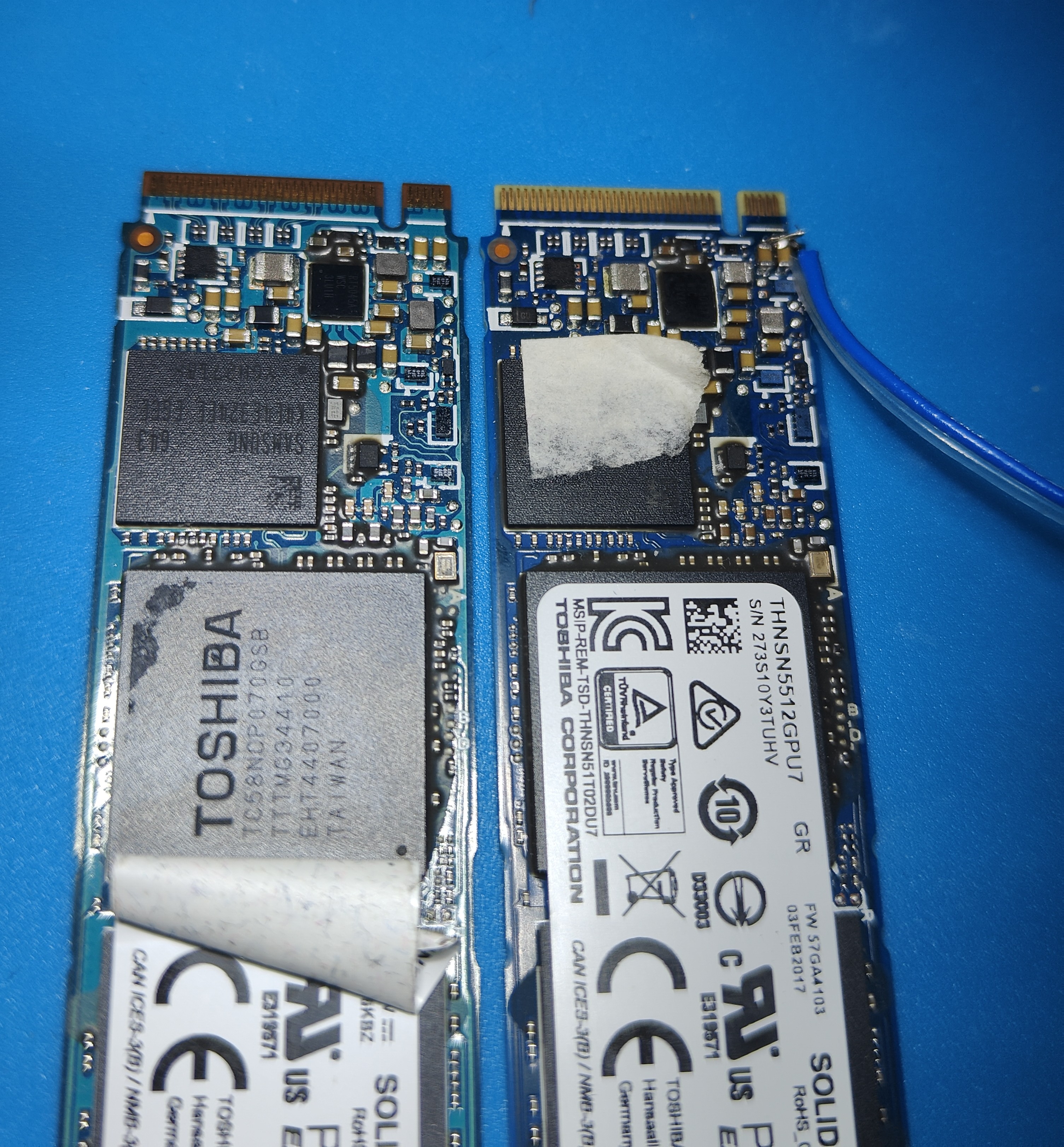

Now with a twin

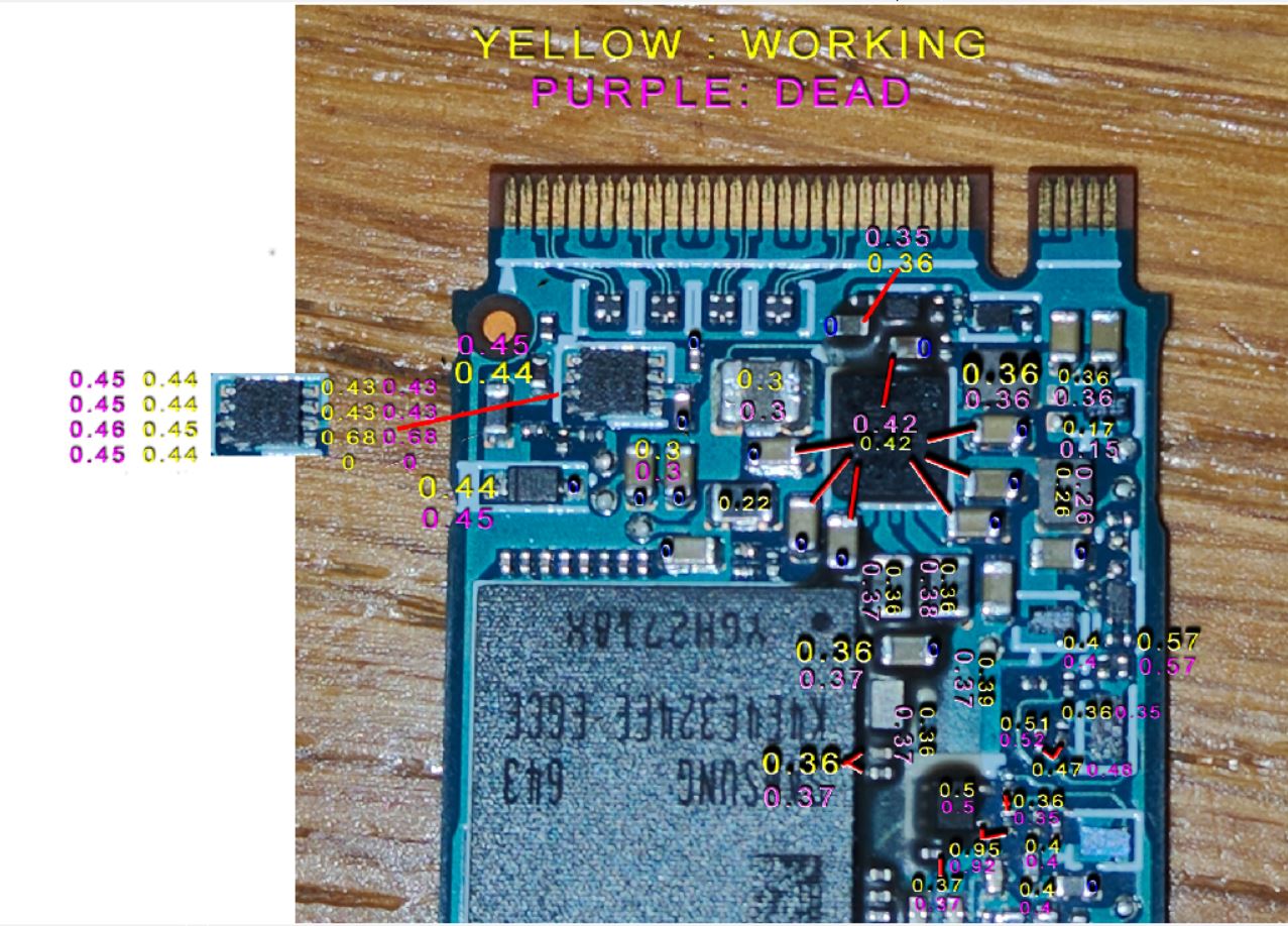

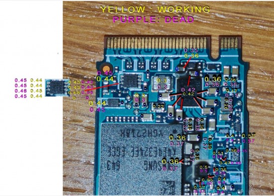

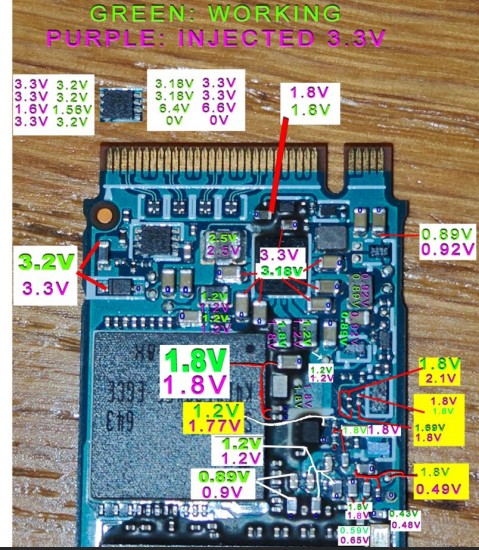

Here is a diode mode measurement to compare a good and the dead hdd. I cant see any difference

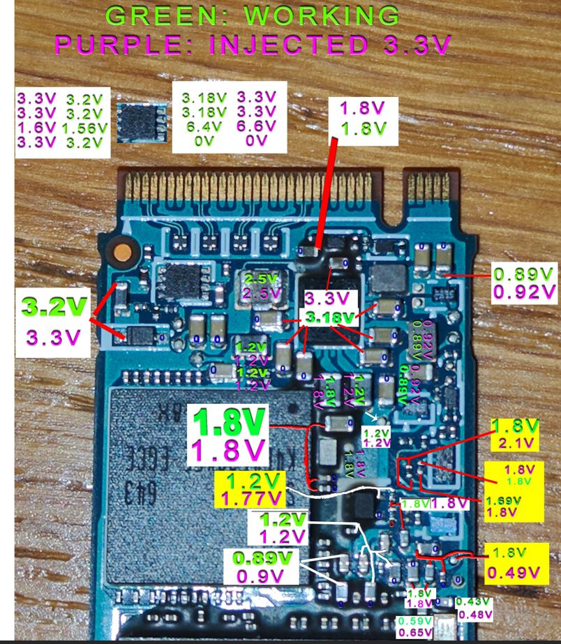

here is voltage measurement on working and the dead hdd
Yellow boxes shows the abnormal values

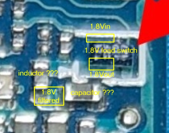

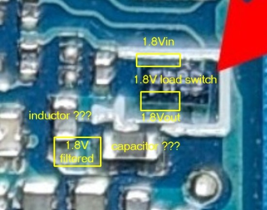

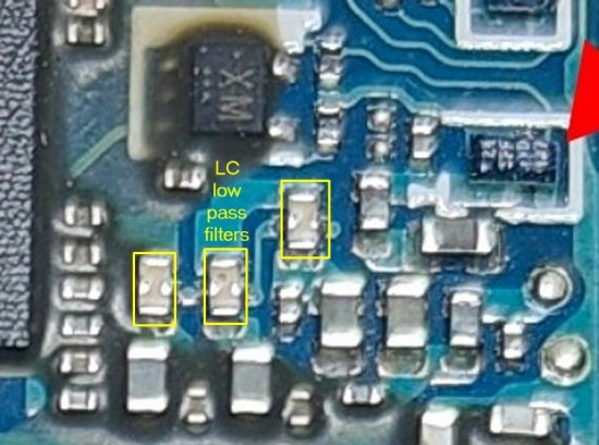

Is it possible that the part which I am guessing is an inductor is open circuit? If so, and if there is no short circuit across the capacitor (?), it should be OK to bridge it.
I'm thinking that the inductor and capacitor may constitute a low pass LC filter.
However, that doesn't explain why the USB port is still overloading. :-???

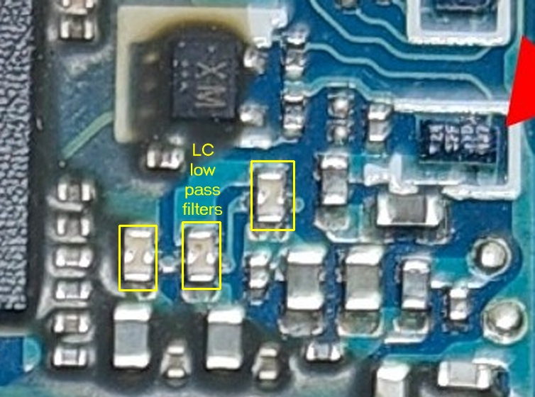

These 3 components are LC low pass filters.
https://www.murata.com/-/media/webrenewal/support/library/catalog/products/filter/lc/k99e_l0270.ashx?la=en&cvid=20160218003958490200

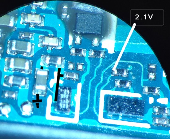

Here is a better pic of the 1.8v ldo
Yes there is a cap and filter.
The Cap is not shorted.
The filter is open as it should.
Screenshot_2024-01-15-22-06-14-64_92460851df6f172a4592fca41cc2d2e6.jpg [ 1.38 MiB | Viewed 15572 times ]

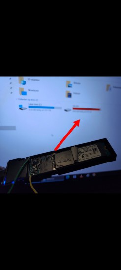

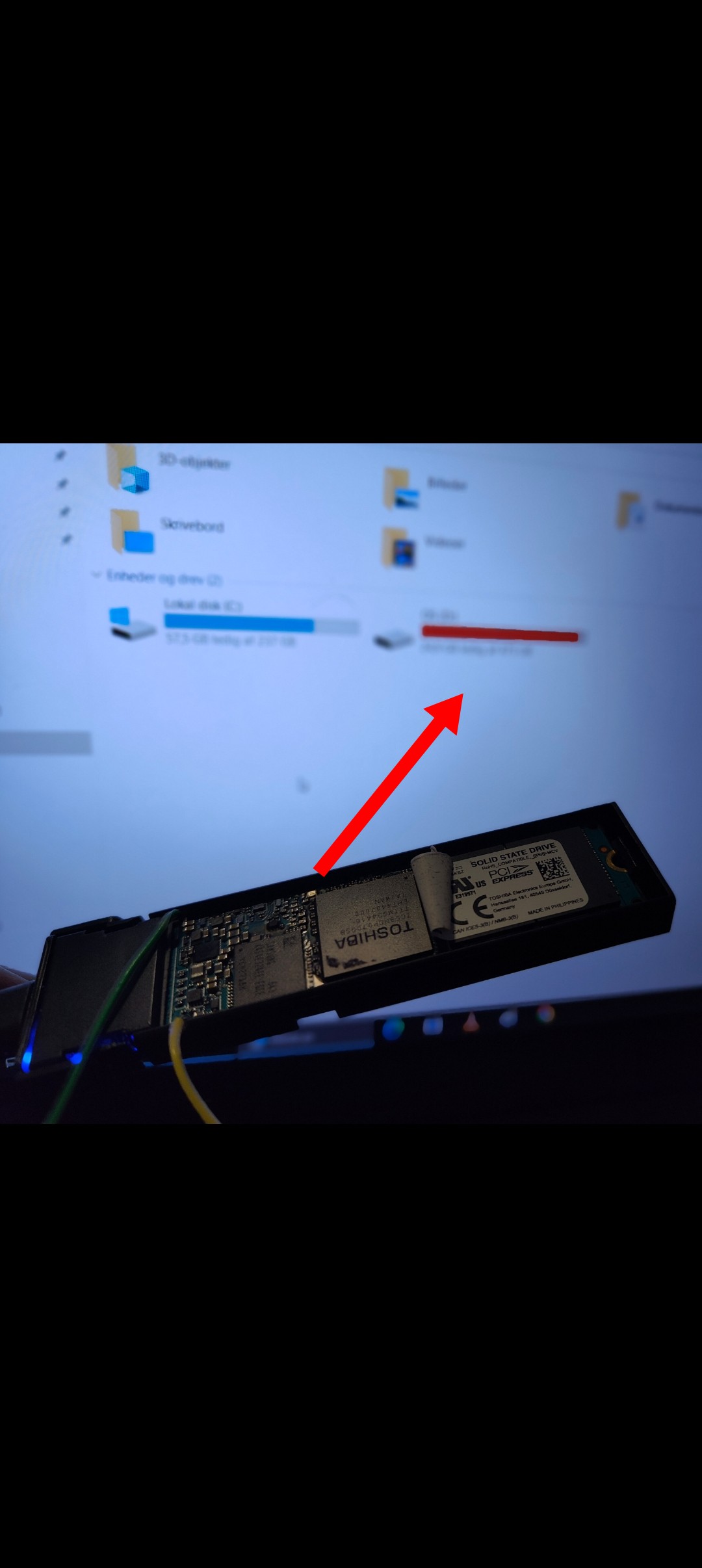

Finally :o :D :oops: :shock: :x :lol:
After shorting the 1.8V ldo, it came a live
What a relief.
Thanks so much for your help and guidance.
Without you, i couldnt do it
