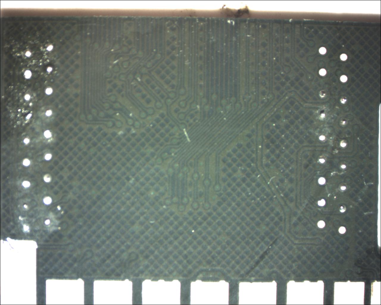

Hello everyone, I found this website by searching around, as I have had a nightmare with my SD card failing at the end of my holiday and not being able to recover my photos. Before I begin, I am a total technology novice so please excuse my ignorance.
I've sent the card of to a number of recovery companies. The first two said that although the data is theoretically still on the card, it is "impossible" to get to the data because the card has suffered an electronics failure and the card is monolithic. However, it is now with another recovery company who say that recovery from monolithic SD cards might be possible if I have the relevant 'pinout diagram'. I don't really know what this, but I'm trying to get it, as I'm desperate to get these photos back. The card manufacturer is PNY, but they have been less than helpful: the only response I got from them is that "it’s not actually possible to have this information because in simple word the components are mixed. So it’s not possible now to have ‘copper layout and pinout diagram’ of our SD cards." I have no idea whether this is true or not?
Do you guys know if there is anyone/any resource that might have a pinout diagram for this card? Does my request even make sense? In case it helps, I'm attaching a photo of the card in question. Thanks so much if anyone can help!

Look here: http://www.odzyskiwanie-danych.com.pl/m ... abase.html
Pinout is similar to SD v2 and v16. I think I can try recover your photos.

Thanks for your reply. Does it matter that my card is a different size (16gb) and perhaps a different brand to those on your database?

Sometimes yes, sometimes no. It could be more banks or just other memory (other flash with bigger size in your case).

+1 for Arvika, if you send your card you have a great chance for recovery. it looks like someone has already at least tried to read the card, judging by the solder on the pads
