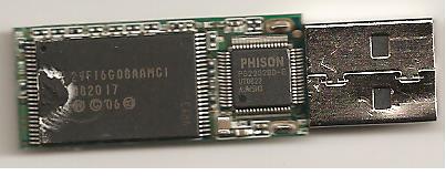

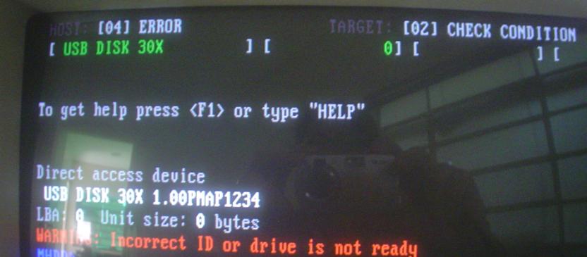

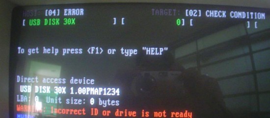

 Post subject: PENDRIVE 2GB
PostPosted: January 13th, 2009, 7:39
Posts: 1060
What problem? :mrgreen:

 Post subject: Re: PENDRIVE 2GB
PostPosted: January 13th, 2009, 13:25
Controller chip is not communicating with the nand chip.
Maybe bad solder connection, but probably bad controller.

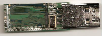

PostPosted: January 13th, 2009, 13:48
Posts: 1060
Look! :mrgreen:
Thanks for reply pcimage!! :D
PostPosted: January 14th, 2009, 1:39
Joined: December 12th, 2008, 17:00
Posts: 181
Location: Cook islands
Very rare case - burnt NAND. Controller is died too. I got about 90-100 damaged flash drives, but I've never seen burnt NAND! :lol: Nothing possibilities to ged back data from this usb stick.

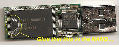

PostPosted: January 14th, 2009, 8:38
Posts: 1060
Hi Creator!
Because it has burnt certainty that NAND? :?:
PostPosted: January 14th, 2009, 9:16
I don't think the nand is burnt, looks like glue marks to me.
Could be wrong though, the pic isn't too clear. (Or is it my eyes that aren't to clear?) ;-)
Creator,
NAND chips not have strong power pins like motor controllers, in this way, it can't be burned on the side. ;)
Only in the middle/center.
PostPosted: January 15th, 2009, 14:04
Posts: 181
N.C. wrote:
Creator,
Regards,
Janos
Really? And what can you say about controllers? It can't be burnt too?
I didn't observe glue, it looks like damage. :D
PostPosted: January 16th, 2009, 6:47
Posts: 1079
Location: canada
that nand is damaged heat outwards.
has taken a good wack for sure.
i would buy another usb pen and swap the flash memory over and see if its works
you might get lucky
