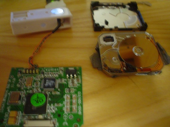

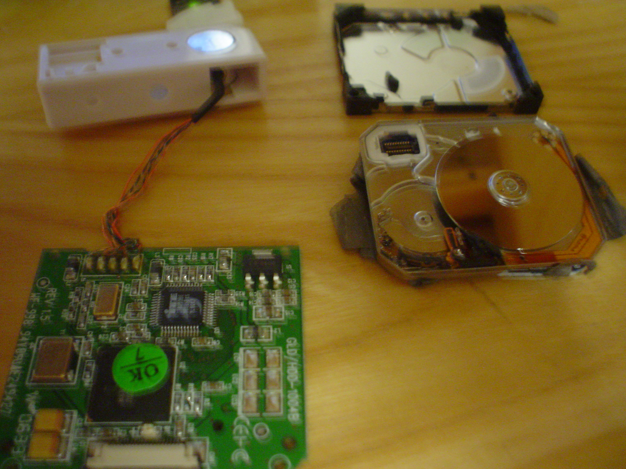

I have had 3 mini drives come across my lab recently. Any help would be appreciated.
Thanks lcoughey, I will have a look at that.
File comment: Head already removed.
 Post subject: Re: MD recovery (Mini Disk)
PostPosted: April 9th, 2009, 22:58
Posts: 3577
Location: Chicago
That's a 1" HDD. IBM/Hitachi also uses MicroDrive term for those
I guess you need to treat them as normal hard drives
There are several manufactures of 1" HDDs but it is hard to say what you got because you didn't show the sticker from the lid. Unlikely it's Hitachi - your drive is "left-headed" and Hitachies are "right-headed"
I see you removed parking ramp, top magnet and HSA.
I can tell you are not a professional DR specialist by looking on how you did that
Those 1" drives need steady and experienced hands. It looks like this work is not for you, sorry
