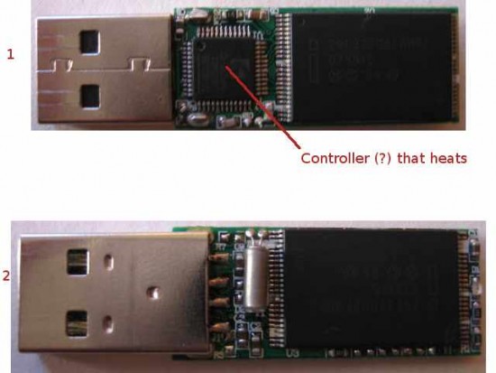

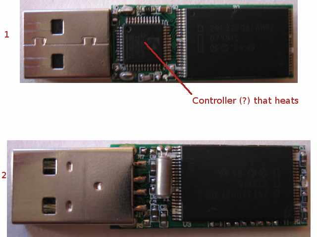

Hello !
First, I need to tell you that I'm french so my english might be strange....
I got a problem with my usb stick since weeks and I can't find good tips/answers on internet, so I'm asking you because this forum seems so be made up for professionals, so your help might be worth !
I have a usb stick (8Go) wich works very well since last year.
But, after a few power cut, due to electrical problems at home, my usb stick doesn't want to work anymore. The only thing I know is that one on those power cut happenned during the boot of my computer.
My USB Stick (informations found after opening the usb stick) :
- The memory = 29f32g08famb2 073815
- The USB controllor = chipsbank cbm2091 887036-22 (A black component way smaller than the memory, I got no idea about the good name)
- Brand = CnMemory Core
- Size = 8Go
- USB 2.0
- File system = FAT (I think)
My computer
I've been using Windows XP since years, and I recently decided to go to Linux (Ubuntu 9.10), but I don't think there's a real link with my problem. I don't think that's because Linux doesn't use exactly the same system of file (something about boot that I found on internet, but I'm not sure). My computer is older tha usb 2.0 (so usb 1.1?).
What's wrong :
My computer doesn't recognize my usb stick. I can't see it anywhere on the computer (even in advanced tools). The light on it doesn't turn on when pluged-in. The thing I previously called usb controllor got warm when pluged-in.
I tried it on several computers, and severals OS.
What I did :
I tried some tools as GetDataBack for FAT and NTFS, and some free too. None worked.
I tried HDHacker (I don't know what that's supposed to do but I read something about it on internet).
I found on internet that the memory and the USB controllor are both from China.
As I would like to try to repair it by my own, I would like some tips/help to fix it. I haven't got any pro tools (only a stupid computer and my brain). It would be so nice I anyone can help me.
Thank you for reading, and maybe helping :D
Keon !

An attachment is supposed to be with this message. It's a picture of my usb stick. I you can try to find the oscillator ;) And which kind of checking can I do on my usb stick?

File comment: A picture of my USB tick - I can't find the oscillator

The oscillator crystal is the small cylinder on the second picture.
You can use an oscilloscope to verify if its still working (but if the controller is dead there's a big chance it will not work, even if its still good).
Thank you ;)
I think I can get an oscilloscope (not at home) to verify if the oscillator is still working. But how would you do this? When the stick is plugged in?
