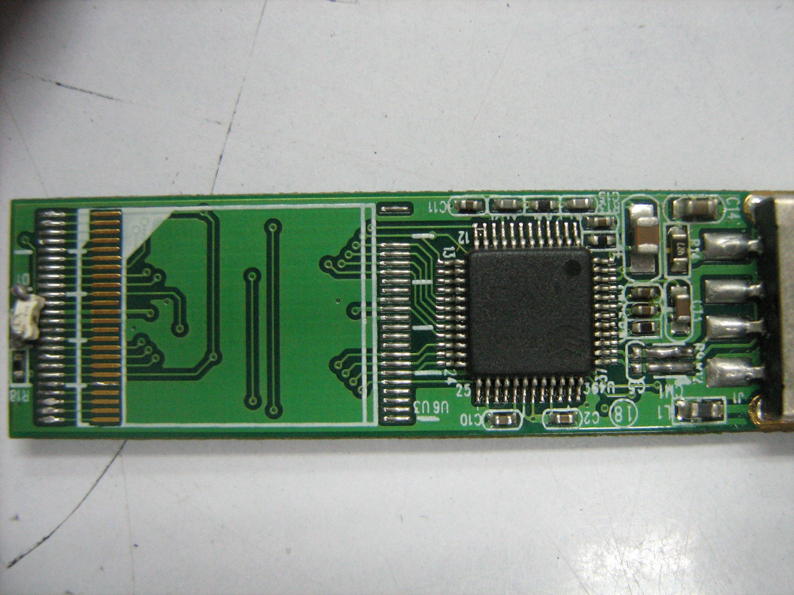

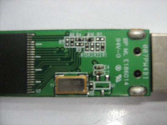

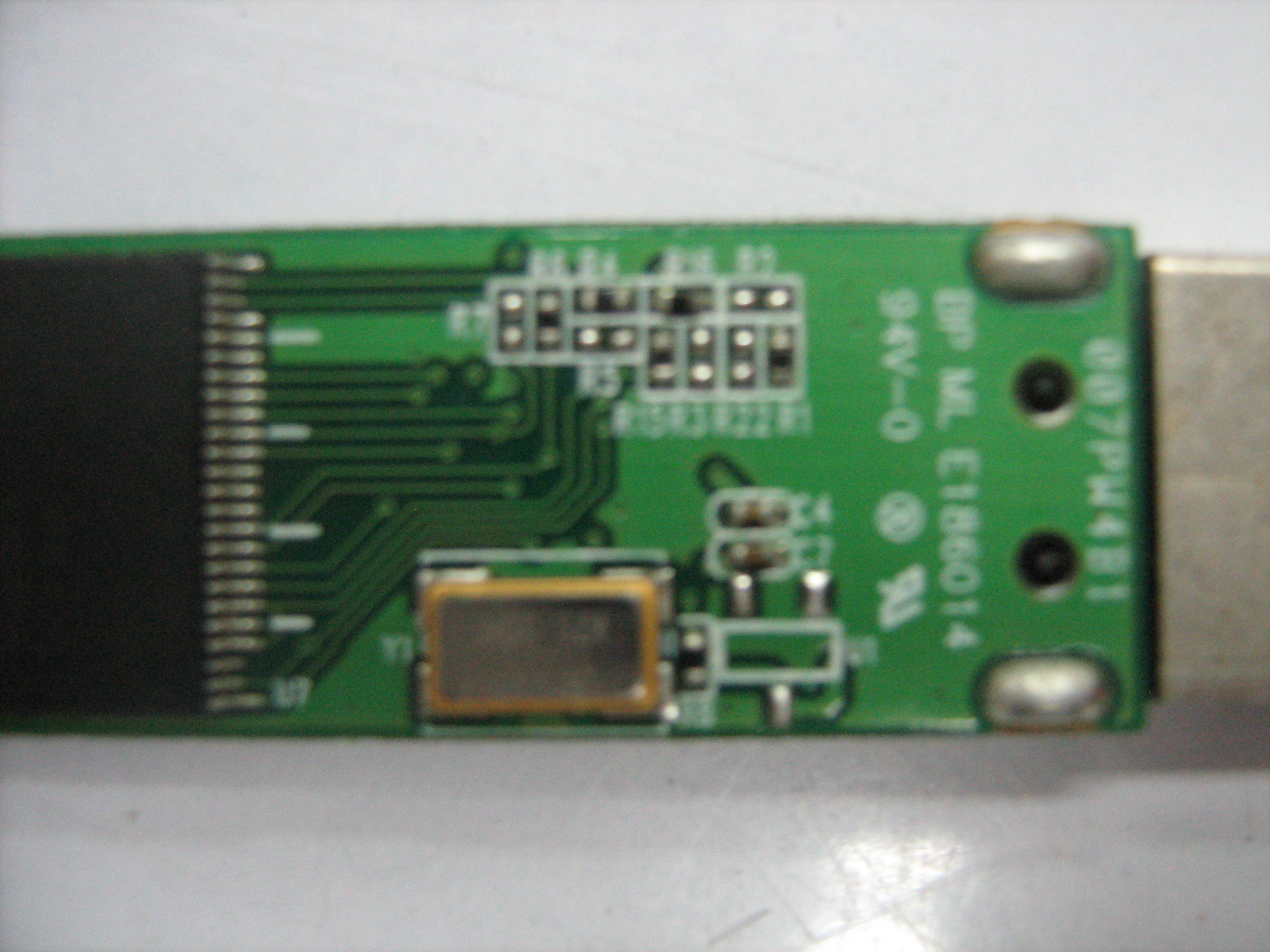

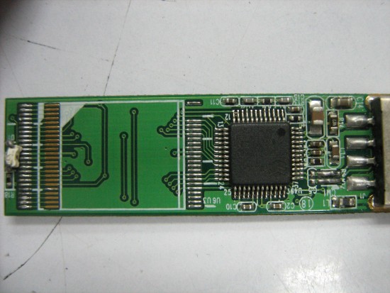

 Post subject: Re: usb did not recognized..
PostPosted: February 10th, 2010, 22:07
Joined: October 27th, 2009, 4:50
Posts: 23
Location: philippines
this is my flash drive..
what part do i have to replace??
