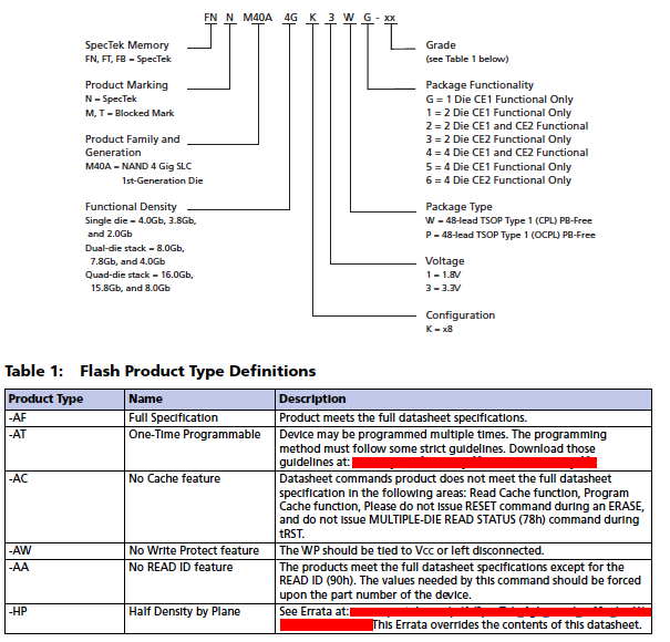

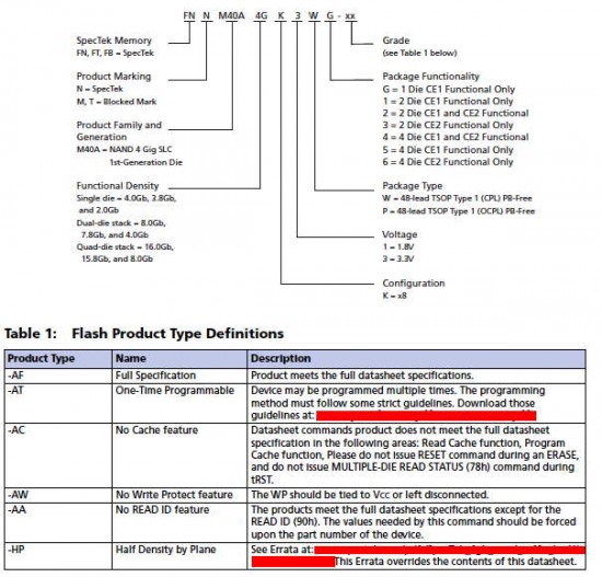

My point is that in many cases they do not have a "real capacity"
The "real capacity" of the nand-flash chip can only be obtained from:
Nand-Flash ID + Manufacturers Bad Block markings+ manufacturers test vectors.
Depending on this data , these devices can range from 0gb, with multiple command defects on the Nand-Flash chips then you have additional problems related to low cost defective controller.
If you mean you want to recover the real storage based on some fantasy about what the chip should contain related to what you paid for it......., then i'm sorry it is not going to happen.
I can possibly supply a manufacturers utility to allow you to fool about but it is not going to correct it.
I need to know the integral controller number, but ultimately you would be playing with fire.
For the cost related to analyzing the Nand-Flash chip, you may as well throw the chip away and solder a good one in its place.
An example to give you an "idea" of what you are up against:
