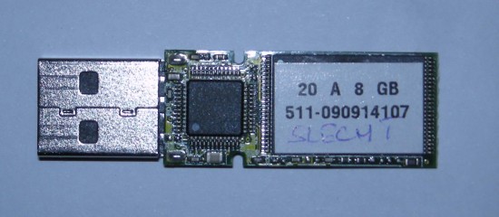

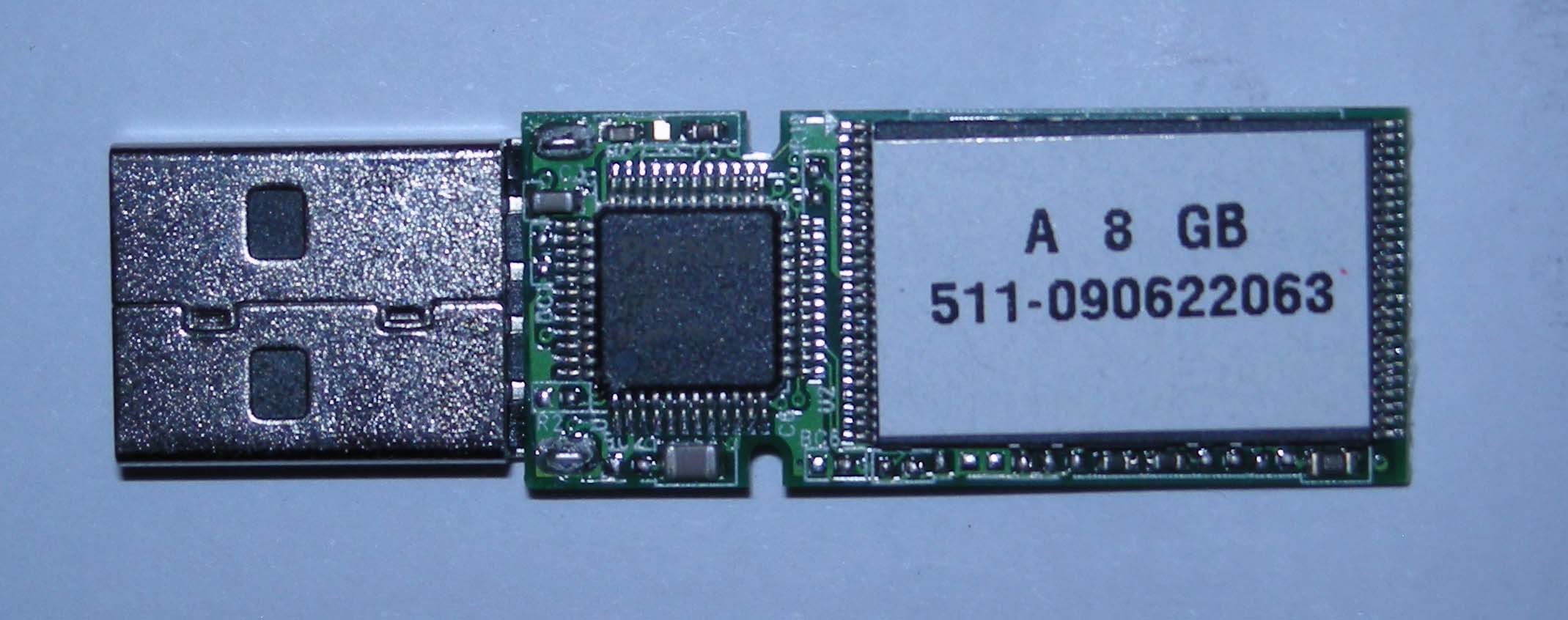

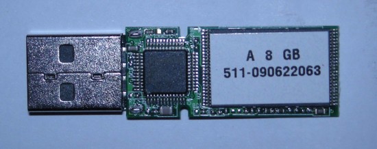

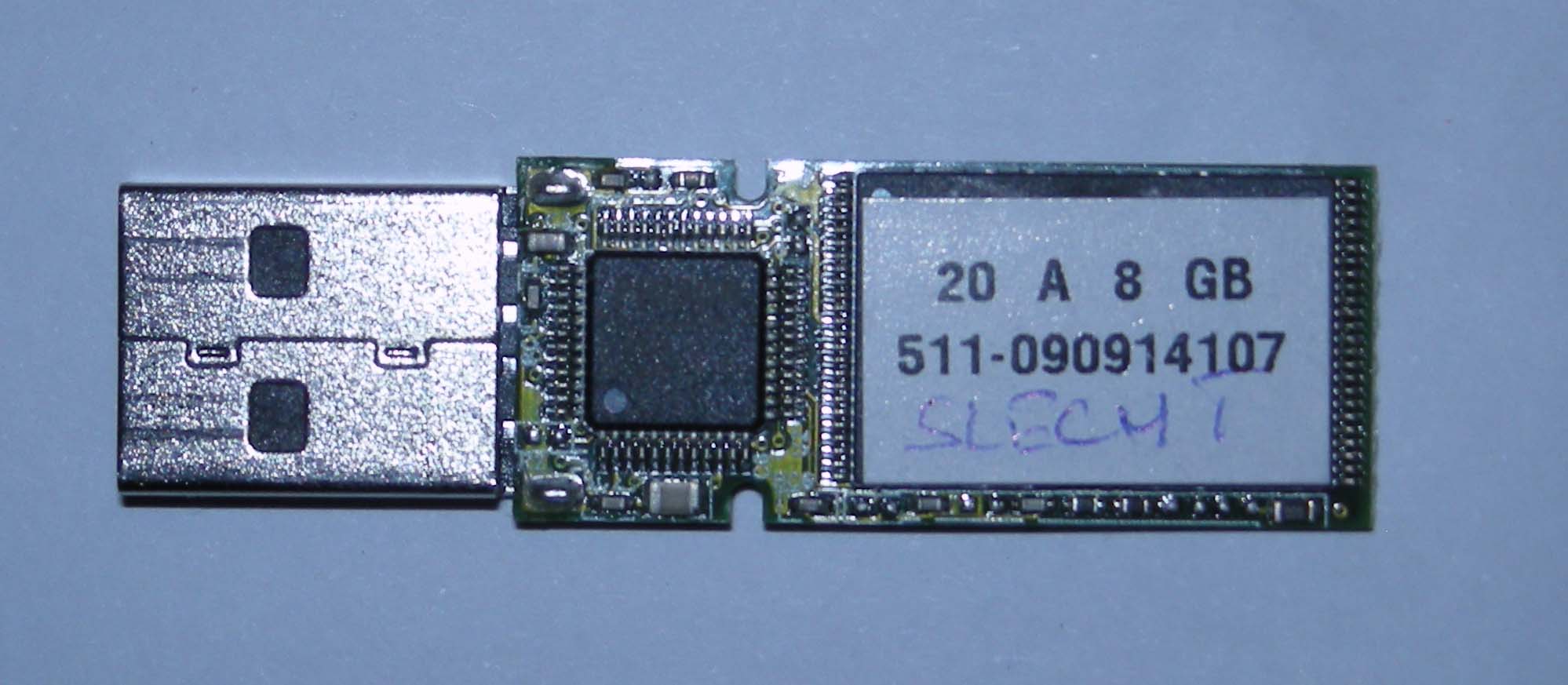

So i have opened the casings and take a picture of both the flash device.
The text on the controller of the bad device is:
PHISON
PS2233-F
UT0924
AKJAF388
The text on the controller of the new device is:
PHISON
PS2251-3388-F
UT0933
AKLAW3
The 2 devices have also different placing of some of the components (capacitors???).
So both devices have a different controller, does this mean that i cannot change the flash memory chips?
If i do change the flash memory chip and i try to acces the data with file recovery software. Could this work?

 Post subject: Re: 8 GB flash memory stick gives 0 Gb memory
PostPosted: July 25th, 2010, 10:13
Swapping the flash chip onto that PCB will not work.
The flash chip needs to be removed, read into file(s) and the raw data decoded into actual data.
All of this requires very special tools, software and knowledge.
We can do this in UK, or dobrevjetser in Belgium, or pepe in Hungary
PostPosted: July 26th, 2010, 9:11
Joined: August 5th, 2008, 7:00
Posts: 111
Location: Hong Kong
O.K,
Your controllers are different, it would be very unwise to attempt a chip swap.
You need to make a decision.
1.If the data is critical and you REALLY want it back, then you will need professional assistance.
OR
2. You want to 'play about', you REALLY DO NOT want the data back, after playing about you CLEARLY understand that a professional recovery house may NEVER be able to get the data back.
