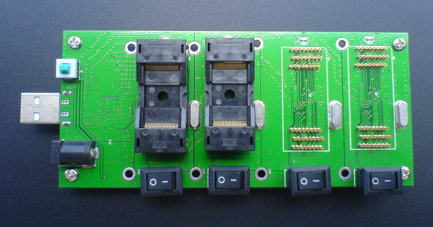

It is far worse than getting scrap from a factory.
This crap has been through so many hands it makes a hooker look like mother Teresa.
The "reliable" companies buy in Nand-Flash chips, which they then screen as ultra reliable, anything outside of that they sell into the local market, basically they are "good" chips within the Silicon manufacturers spec. (What happens next is the problem)
These chips then get to a second factory and are screened again, and so on, until the absolute dregs end up in this "production area".
On top of that , the shear cost and volume of manufacturing these drives(nand-flash,SSd), usually precludes "repair", so this "scrap" is sold out in job lots to other factories , who can finance repairs working on the margins they work on.
This then continues.
The absolute DREGGS end up on Ebay, because a factory/ individual buys in the scrap and then uses one of the tools on the market to re-program the controller. (I have a couple of these "programmer kits" for evaluation , part of a forensic research project).
These kits allow programming of upto 16- 32 of the nand-flash controller "parameter" areas at a time.
I have posted a picture of a "4" way harness used to "test" chips , but actually it allows you to manipulate the Nand-Flash controller configuration area via the manufacturers utilities for the chips.
