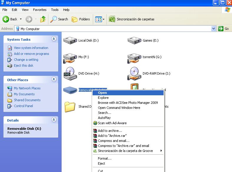

Hello everyone.I have a big problem with my crucial gizmo 8gb pendrive.
After using a unetbootin alike software my pendrive wont work.
I've tryied almost everything linux software,windows software,but with no result.

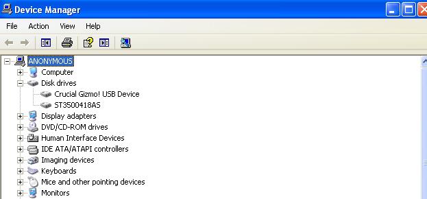

The driver in windows seems to be fine,but when i click it into My computer says :insert cdrom or something

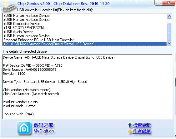

i`ve tried something with the chipgenius and fashboot.ru but i cant manage to find the software for my pendrive.
Theres no important data on the stick.Thanks in advance.
