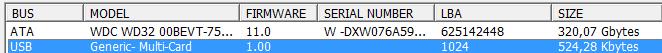

I have a micro sd 4 gb of which does not recognize ... I have pictures recovery is possible some kind of recovery that this card is not recognized?

Hi to all! :mrgreen:
LOOK!

anyone here can solve this problem?

This is a Monolith chip and will expensive to get the data from but yes it is possible.

U$??

it is possible and you could be expecting above 500 bucks for a recovery if possible.

Probably double that to be real :-(
