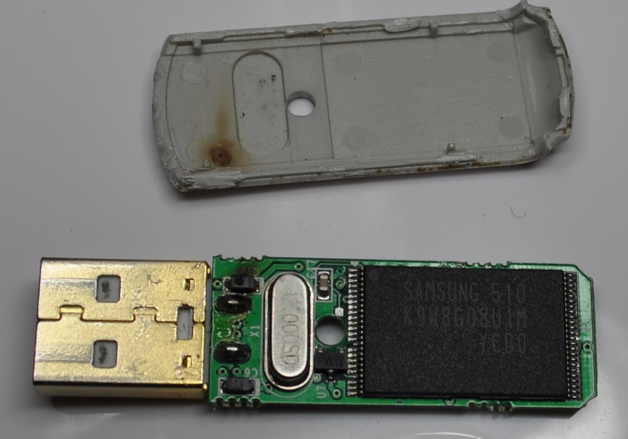

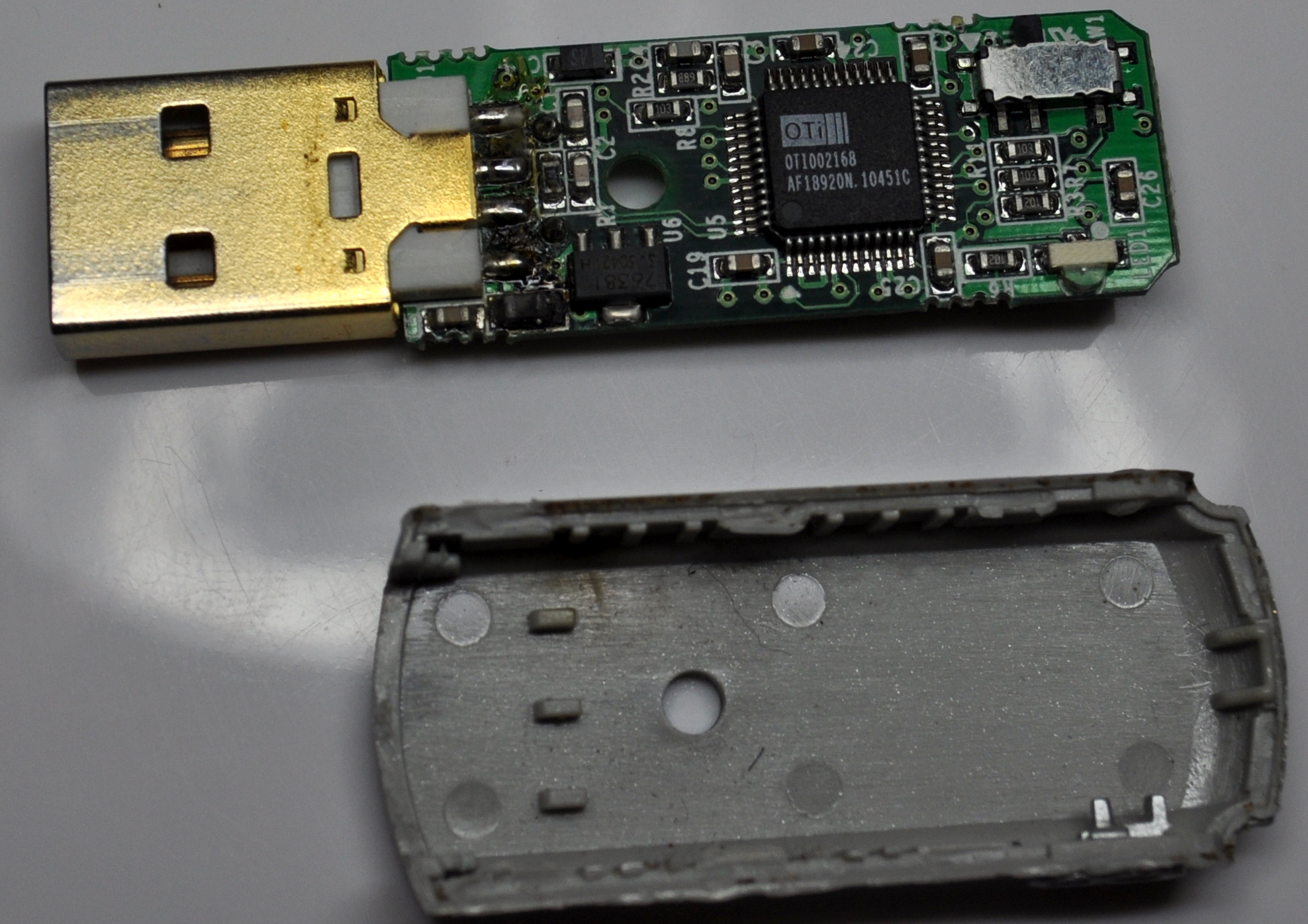

from this 1 gb pen drive there was a burnt strong smell.
i opened and i found the (diode?) burnt
a) C14
b) no text but it's possible to see from the pictures.
Any idea if both are simple diode?
a) C14
Hint - a diode PCB marking would not start with "C" :)
I would trace the PCB tracks to identify the likely function of that component - but it looks the same type as "C14".
Not diodes - at least not "C14"; I would need to spend more time tracing the PCB to check the other burned component. Do NOT short-circuit them, as you suggest later.
What does the customer say was the cause - was there a possible overvoltage?
 Post subject: Re: 2 diode burnt?
PostPosted: May 31st, 2011, 23:19
Posts: 17328
I agree with Vulcan regarding the circuit tracing.
Usually when an electrolytic capacitor fails catastrophically, the cause is an overvoltage, or reverse polarity. There appears to be a 3.3V linear regulator (U6) between the USB port and the controller and flash memory. Hopefully it will have limited the damage. I can't read its markings, but a typical pinout would be Input (+5V) - Ground - Output (+3.3V). I would clean the affected area with a toothbrush and isopropyl alcohol.
