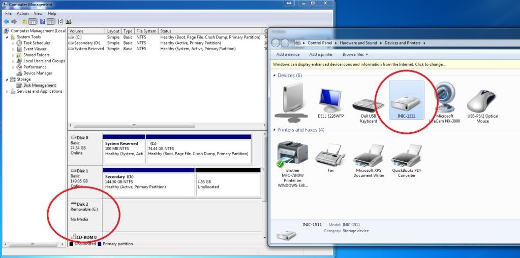

Hey everyone. New here
I have a sony handycam that all of the sudden will not power on. I was able to remove the 1.8' Zif drive and hook it up to my PC using a USB enclosure. My only problem is my PC and Mac see the drive but i cannot see the info on it to copy it off..
My PC will show the drive in disk management and in device/printers but nowhere else. The Mac shows it in Disk utility but again nowere else and i cannot open it to view/edit the files..
Any suggestions? Thanks

You're not seeing the drive, just the enclosure

If the data is important, then inquire professionals about data recovery maybe? Need to get a solid diagnostic on the drive to determine what is wrong with it.

if its a zif drive caddy, the connectors are probably not pushed in correct or upside down. have a fiddle, you will get it eventually
does it spin up?
