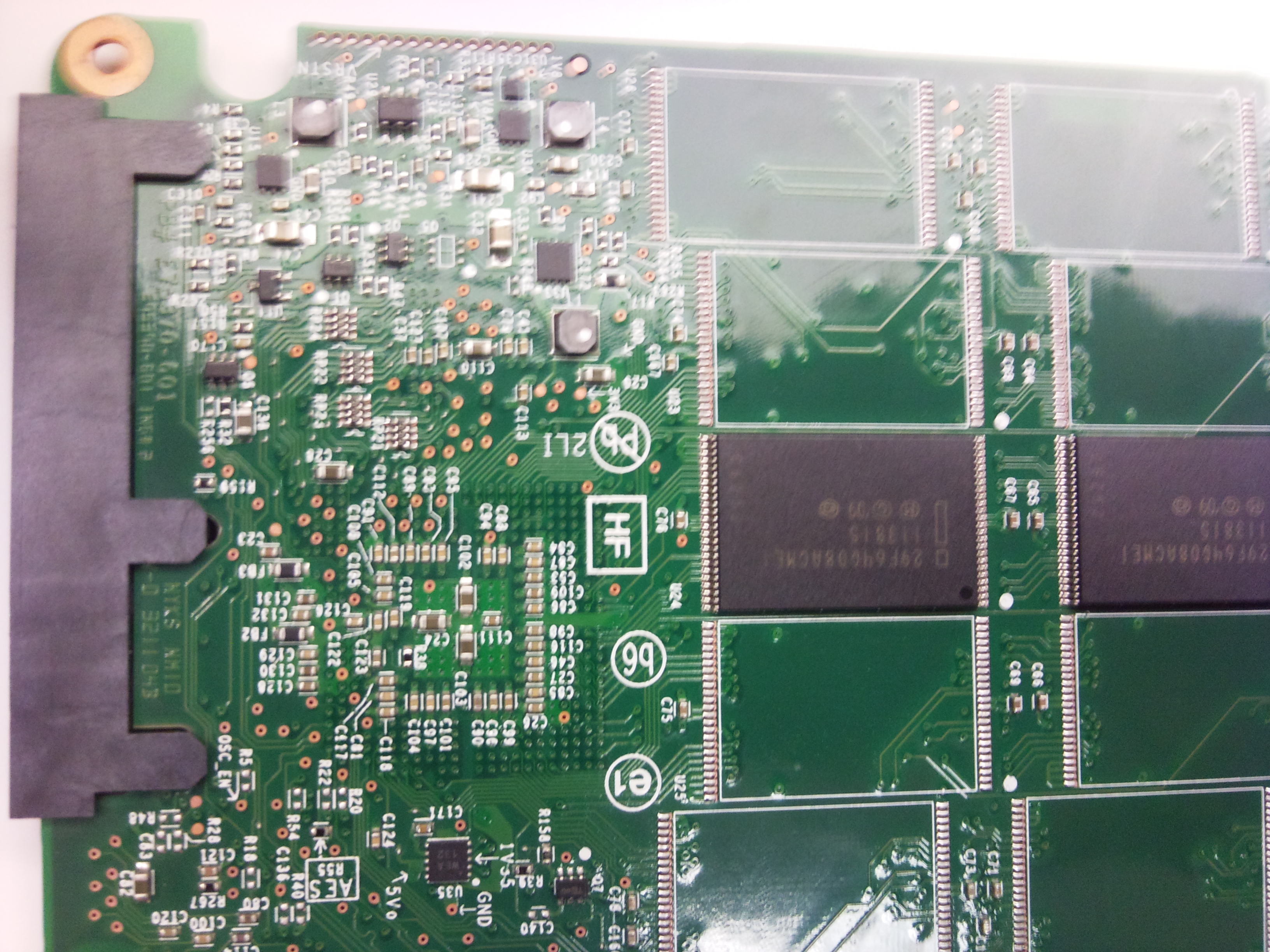

OKay, please find some pictures of my drive.
Thanks for your reply
Cheers
Raja

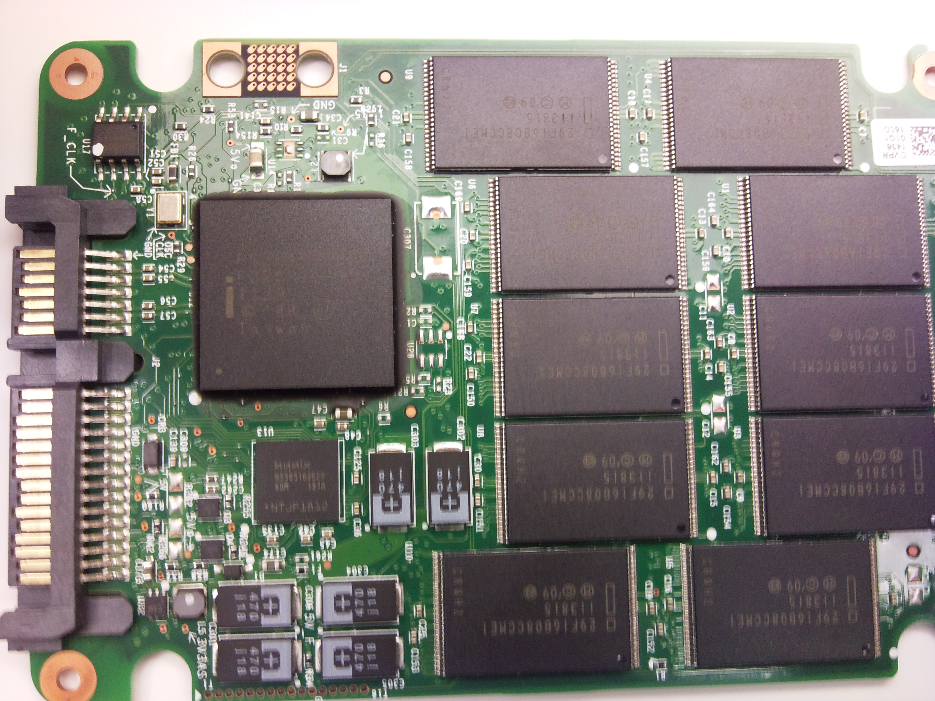

another one

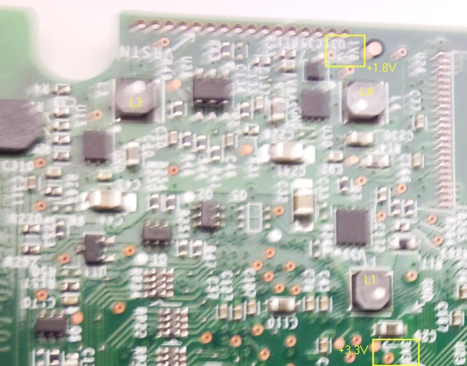

Your photos are too blurry, but I was able to make out the following test points. There should be a supply voltage on the output side of L3, but I can't see any.

Thanks a lot! it would help me, i have general knowledge in electronics but not an expert.
Bye for now, i will let you know
 Post subject: Re: Intel SSD 320 Series not detected
PostPosted: October 7th, 2013, 9:31
Joined: September 6th, 2013, 3:38
Posts: 14
Location: Paris
First i removed the diode of Protection and checked all the points you had suggest me and it is OK. For the voltage epected 5 V , i'm getting 4.82V is it a problem?
If everything is OK, i don't know where is located the problem!
PostPosted: October 7th, 2013, 17:11
Posts: 17333
1) If CR3 measured OK, then there was no need to remove it.
2) I don't know the range of supply voltages that the SSD will tolerate, but I would think that +4.8V should be OK.
3) You didn't say what voltage you measured at L3.
4) Do any of the chips (flash controller, NAND flash array) feel hot?
5) AFAIK, most, if not all, SSDs have a diagnostic console. Some have a serial TTL RS232 port. If you can locate such a port and communicate with the SSD, then this will prove that the flash controller is at least partially functional.
If the hardware is OK, then the SSD may have a firmware fault. I can't help you with that.

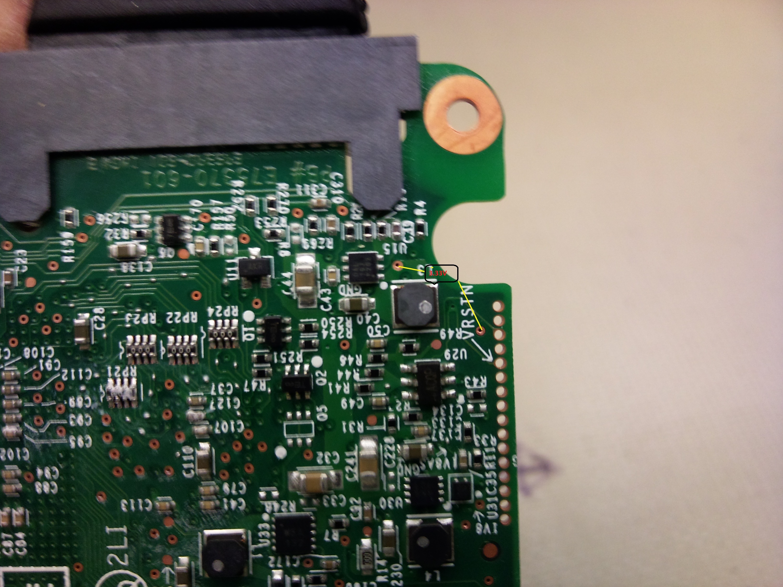

CR3 = OL while the board powered on, i guess now that i had to measure CR3 without power on!
2) Within L3 i'm getting 3.3V please take a look on the picture.
Thank you
PostPosted: October 8th, 2013, 17:42
Posts: 17333
The voltages seem OK. I don't think there is anything I can do for you. Sorry. :-(
