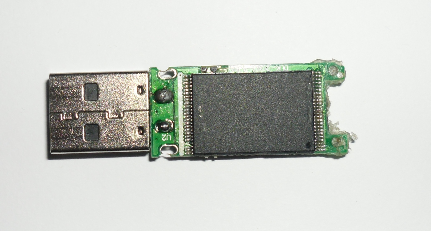

I got this flash drive from a client to get the files out. It's a no brand flash drive (I don't know where he bought it).
The drive is detected but as 8MB. After reading in this section and by watching the flash memory (as you can see in the picture), can this be a fake?
Does the 2 legs not solder, be the cause?
IMHO no - the pins which I think you mean (pins 45 & 46 - in your picture, the ones 3rd & 4th up from the bottom on the left side) are unused on typical byte-wide (8-bit) NAND flash in 48-pin TSOP packages.

Thanks Vulcan
What about the complete lack of info of the chip??
Weird....
Weird....
In my limited experience, such chips are often the rejects which did not meet full spec after testing. Therefore I expect this is low quality flash, but some parts of the chip might work OK. Other people with more experience may have extra info about this.
If you have a programming tool which can issue the NAND "Read ID" command, then the "original" NAND type might be found e.g. byte 0 of the Read ID response = maker (0x29 is Micron, for example), then byte 1 of that response = device ID given by the manufacturer.
Good luck!
(Edited to add: P.S. This type of behaviour (reported as 8MB) can sometimes be a controller fault e.g. can't detect flash. I expect the easiest way to attempt recovery is to remove the flash and then try to read it in a suitable reader.)

8MB is probably size of cache.
What markings do you see on the controller? This will give a better idea of the likelihood of a recovery with specialist tools like Soft Center. When you have an idea about how recovery chance you can make better decision about how to deal with it :)

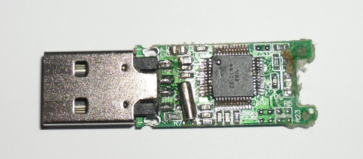

Hi Hddguy
Here's the controller picture.
ACELab partner
 Post subject: Re: Flash drive detected as 8MB
PostPosted: July 7th, 2011, 14:54
Posts: 2984
This is rebranded Chipsbank controller. Should not be too much problem to assemble the data from a dump of the NAND.
Lack of markings on NAND and Controller is common with cheap unbranded models.
Did you try to repair electrically ? Do you have access to Flash recovery tools?

PostPosted: July 7th, 2011, 15:38
hddguy is correct, rebranded Chipsbank controller (CBM2090 from memory) which uses Bank tables.
Common in cheap Chinese USB sticks, or promotional "giveaway" sticks.
Little trickier than normal, but should be recoverable
