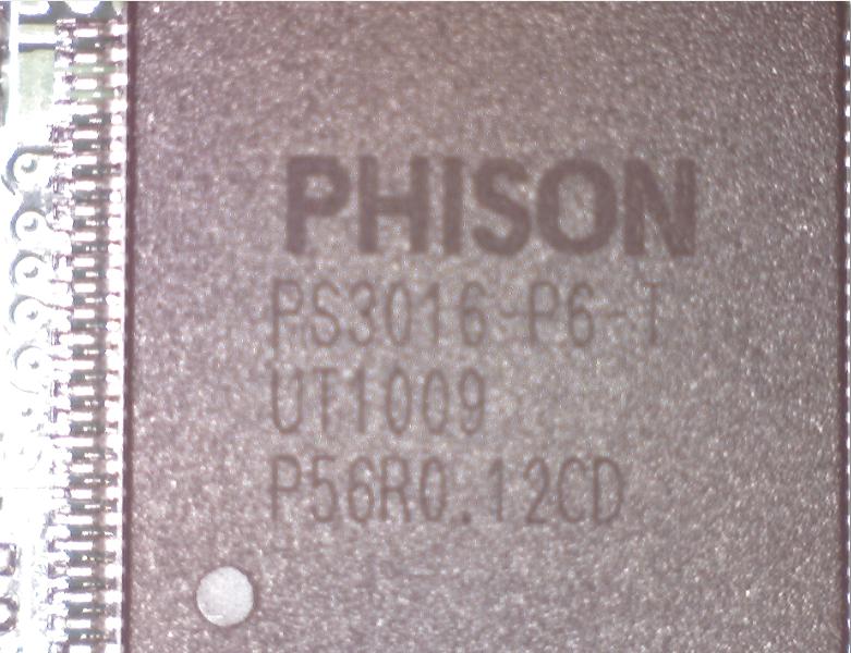

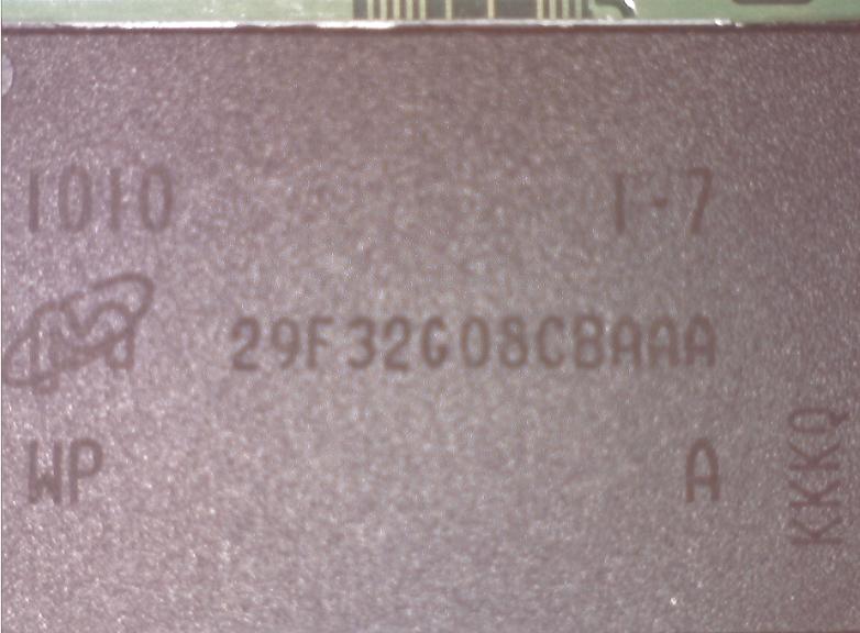

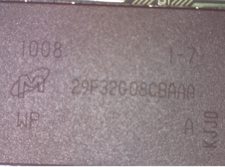

Hi to all!!
Please help!
I clone the two chips file.dmp pcflash ace.
This file. Dmp can be used in other tools to recover jpg files?

Have used pc3k flash files with SC before, but that was with old core.
Probably still possible, just have to manually make the chip.txt file that the SC NAND reader makes, and rename the files to SC format.
Assuming of course that pc3k flash has read the chips properly with the right page size etc.
Happy to take a look if you send the dumps over.

This file can be used in any specialized program. Just to make sure that the config parameters used to each other. These options - is the page size, capacity chips, the number of planes, the size of the planes, the actual size of the block.

With PC3000 flash, you can try "building image based on data analysis" to recover jpg.
