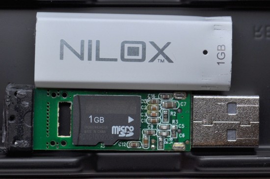

 Post subject: i wanted recovery a pendrive but i found a microSD
PostPosted: April 19th, 2012, 12:30
Posts: 441
Location: italy

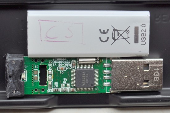

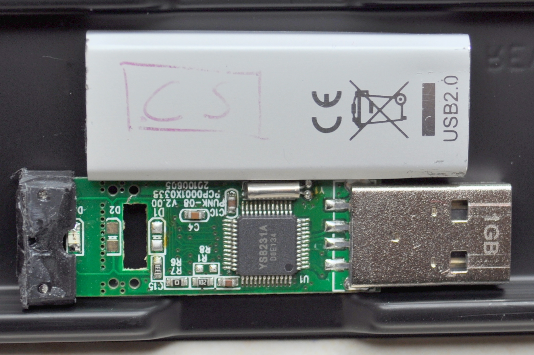

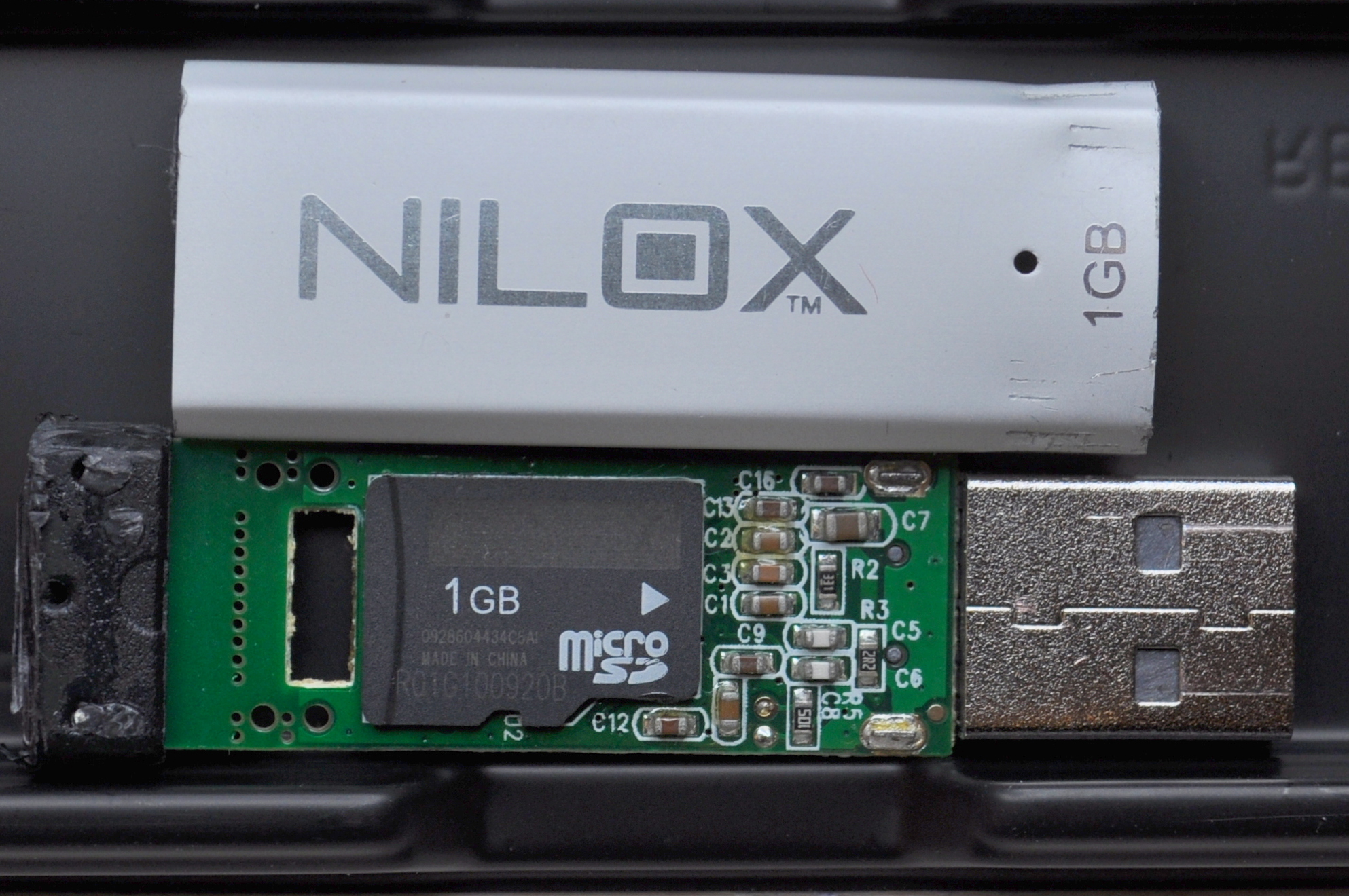

This is first time i open a pen-drive and i found a microSD, so before to judge it unrecoverable to customer i wanted to ask here if somebody have faced this before..

 Post subject: Re: i wanted recovery a pendrive but i found a microSD
PostPosted: April 19th, 2012, 15:15
Posts: 511
Location: Austin, TX
that is new to me. I would try and and unsolder the Microsd and see if it will read in a microsd reader. you may get lucky, but that is definitely odd
PostPosted: April 19th, 2012, 15:17
Posts: 511
in addition, if you do unsolder it, can you take a pick of how ti was soldered to the board, i am curious. Micro Sd has its own built in controller, plus there is the controller chip on the circuit board... soooo odd
PostPosted: April 19th, 2012, 15:59
Joined: April 18th, 2012, 21:00
Posts: 9
Location: Slovenia
Hot air + looots of IR preheat from bottom is the way to go. Just check if it is superglued or epoxied there first
I guess it was soldered as any other SMD component - other guess is - it was bridged with wires, then bent down and glued - the third one is with push-up pins that got soldered to both sides.
PostPosted: April 19th, 2012, 16:01
Posts: 441
Location: italy
sure it is superglued or epoxied from all sides.
PostPosted: April 19th, 2012, 16:39
Posts: 9
Location: Slovenia
Well - some SMD components are glued there by heat resistant compound - that is to prevent them from falling off during pre-heat and re-flow. That can be pain if you find it out when you are applying more heat to the chip, thinking it is an issue of too low-temperature to melt the solder and instead you are just burning the chip.

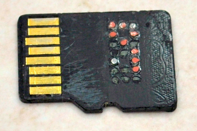

PostPosted: April 20th, 2012, 6:10
Posts: 441
Location: italy

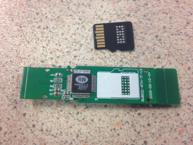

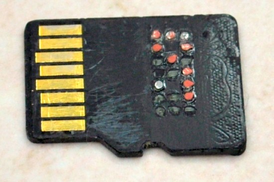

i removed the micro SD cleaned contacts but it's not recognized. also i noticed on pcb this microSD was soldered not by normal contacts as far see in picture.
PostPosted: April 20th, 2012, 11:17
Posts: 3551
Could you take a pic of the pcb with the microSD unsoldered?
Just curious.
Thanks!
PostPosted: April 20th, 2012, 12:37

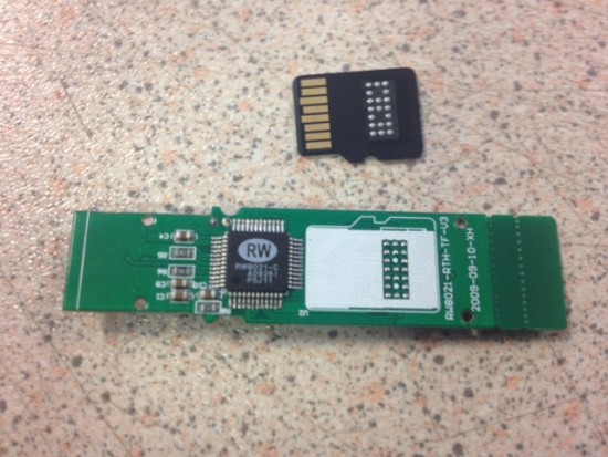

Here's a pic of one we had in a while ago...
PostPosted: April 20th, 2012, 12:57
Posts: 3551
Sean, do you unsolder these the usual way?
PostPosted: April 20th, 2012, 13:48
Yeah.
Infrared preheater and a little hot air.
PostPosted: April 20th, 2012, 13:50
Posts: 441
Location: italy
did u read microSD & get data back? mine microSD is not readable, sad.
PostPosted: April 21st, 2012, 4:01
Nope, micro SD is dead.
Could possibly use wire adaptor with Soft Center reader to connect to those contact points on the back (once the pinouts are found) but clients budget didn't stretch to that.
PostPosted: April 21st, 2012, 5:15
Posts: 441
Location: italy
same situation here, after my quote for a wire adaptor recovery, customer gave up.
