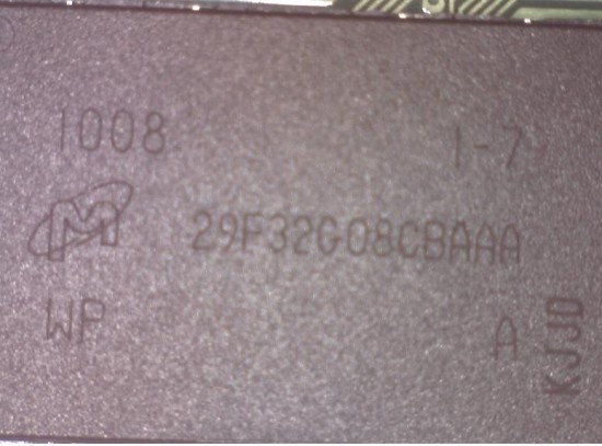

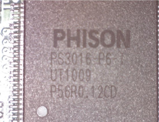

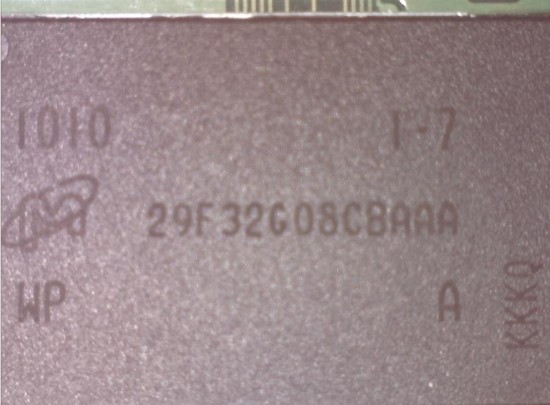

Hi to all!!
Please help!
I clone the two chips file.dmp pcflash ace.
This file. Dmp can be used in other tools to recover jpg files?

sempre wrote:
Hi to all!!
Please help!
i dont think so my friend, you will need to export the FINAL Image to file then use it in any recovery App.
this is based on SC, i dono much about 3k but i assume SHOULD be the same
many issues involved, Mixes and other.
good luck
 Post subject: Re: CF 8 GB 2 CHIPS
PostPosted: May 31st, 2012, 15:49
Have used pc3k flash files with SC before, but that was with old core.
Probably still possible, just have to manually make the chip.txt file that the SC NAND reader makes, and rename the files to SC format.
Assuming of course that pc3k flash has read the chips properly with the right page size etc.
Happy to take a look if you send the dumps over.
PostPosted: June 1st, 2012, 6:20
Joined: March 15th, 2005, 12:49
Posts: 36
Location: Владивосток
This file can be used in any specialized program. Just to make sure that the config parameters used to each other. These options - is the page size, capacity chips, the number of planes, the size of the planes, the actual size of the block.
PostPosted: June 4th, 2012, 5:33
Joined: May 3rd, 2011, 9:52
Posts: 177
Location: France
With PC3000 flash, you can try "building image based on data analysis" to recover jpg.
