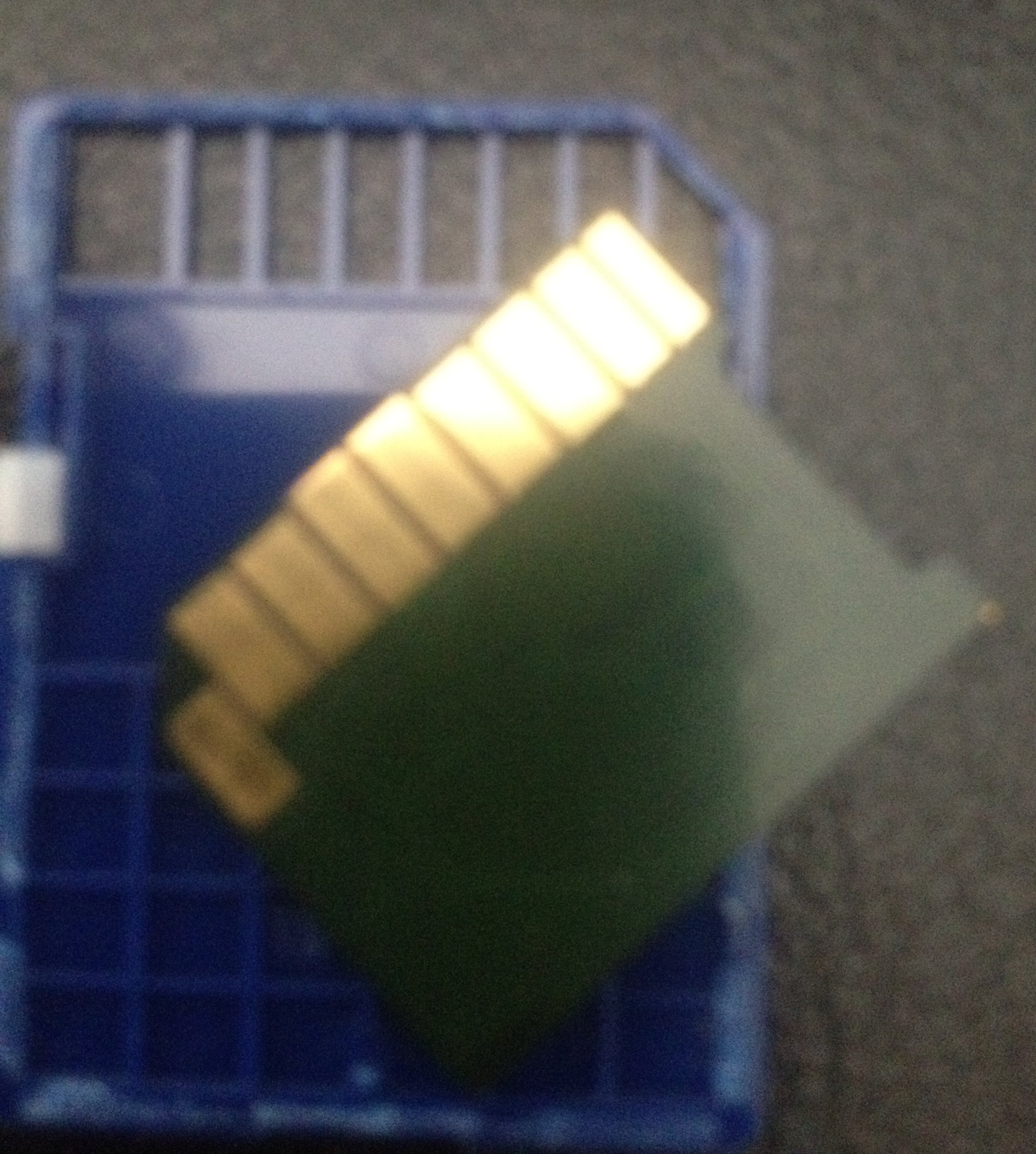

This is the card, photo isn't very good but I have only this one. What special connection is needed if pinout is unknown?

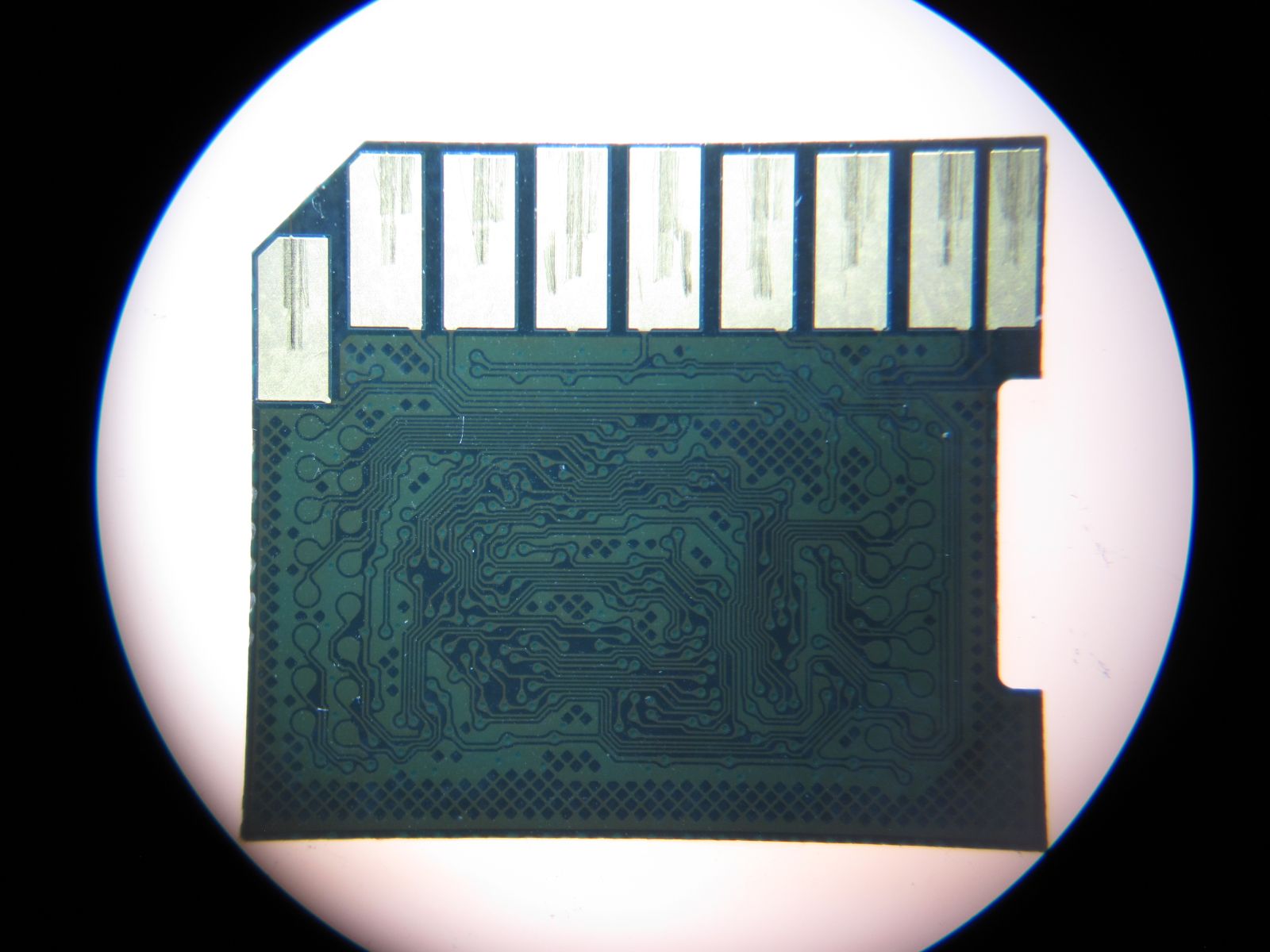

I can't see anything on this photo. Show sharp photo and good resolution, something like that:

arvika, thanks for your help but I have already returned the card

Looks like my case from here:
http://flash-extractor.com/forum_old/vi ... php?t=4937
Pin-out is known..
Pin-out is known..
You have pin out for this? Did you recover such case before?

hddguy wrote:
Pin-out is known..
i got many cases like this, and 99% of them are dead-end with me here
since flashes DR is not really my priority concern here
good luck with this hddguy
Vlad. might help on this.
Thanks, but I dont need one recovered, I was wondering if pinout was available. I have many pinouts but not this specific one.
 Post subject: Re: sdhc card not recognized
PostPosted: August 21st, 2012, 13:34
Posts: 2854
if am not mistaken here hddguy, i guess (not sure) once i asked Vlad. and he told me SOME people sell those pinouts - not sure
it may or may not.
:wink:
