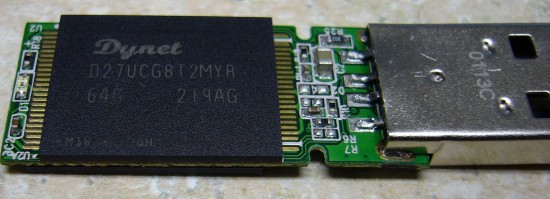

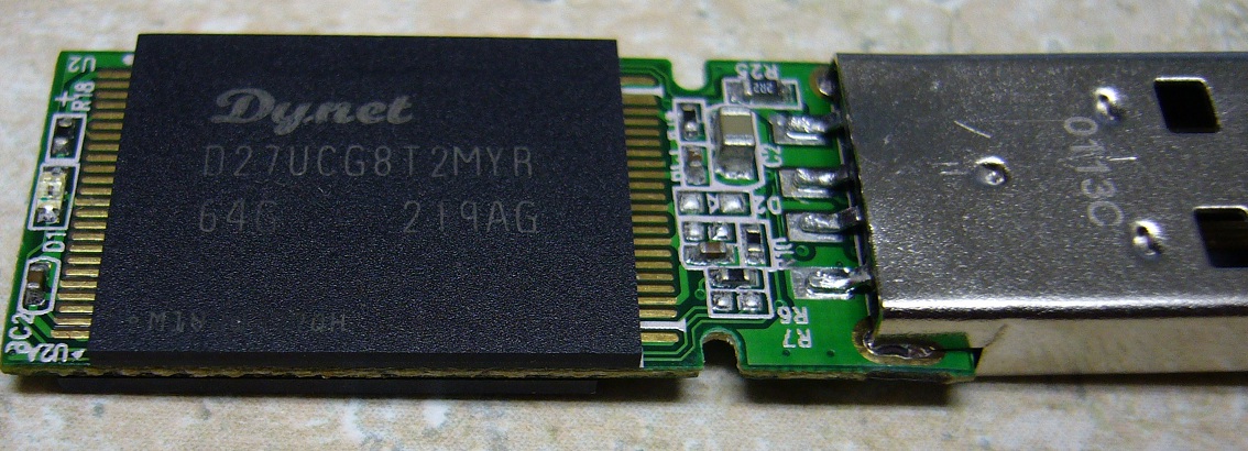

I have a 16GB Data Stick Pro by Centon. Looking for a working parts drive, but must contain same flash config and controller. Trying to avoid buying 100 of these and hoping for a good match. Attached is a picture of the drive.
Controller: SM3257L AA
Flash x2: Dynet D27UCG8T2MYR

Flash extractor and PC3000 do not read this chip correctly. FE support said they have had luck changing chips to a matching device.

Have a lot of this memory on my lab. It is really pain in the ass :/ I think swap nand to other is not so good solution.
We are working on solution to read it better.

I don't think moving flash to another device will help.
I would expect the problem with the stick is that the memory has degraded to a level that the onboard controller cannot ECC properly, so moving it will not help.

From their post, I took it that the FE hardware was having the issue reading the chip. Not that there was a problem with the chips themselves. Why else would it be listed in the problem chips section?
If I cannot read the chips with either reader then I think it is at least worth the attempt.
