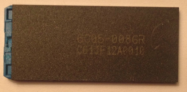

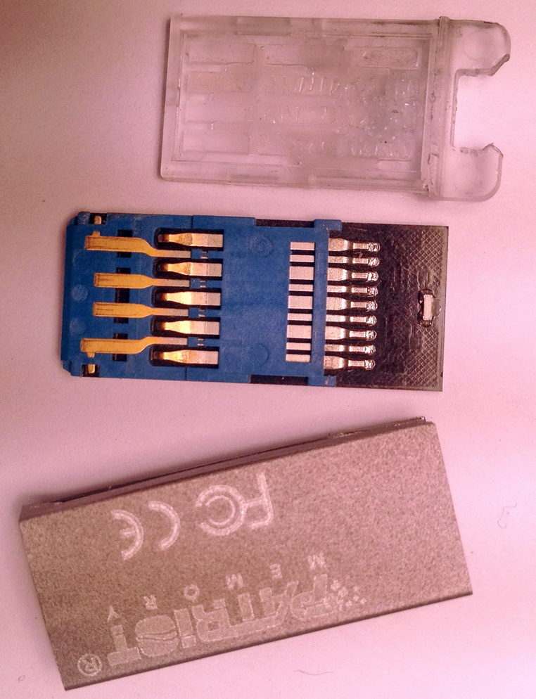

Has anyone seen anything like this around? I am not sure of the reason for the extra contacts soldered to it. It was quite hard to pull apart, glued or melted together. can anyone tell me what the actual name of this type of memory is? I see everyone says Monolith, but I don't see that term on the manufacturers sites. What do the manufacturers call these things so I can try to find documentation...
This was in a Patriot Lifestyle Element USB3 Drive.
cheers
HaQue
Those extra 5 contacts carry the USB 3.0 signals.

Ok, ha.. I've never taken the time to look at USB3 connectors or ports and assumed they were same as 2.0, just faster! Seems I am focussing too much on whats inside and not enough on the other general details. I'll slink off into the shadows now and hide ;-(
Thanks for the info!

It is classical monolith UFD. No documentation for it - I'm sure. Do you need data from it?

For data recovery from this type monolith need use Logic analyzer for recognized pin outs. After that use PC 3000 or Sort-center tools for data recovery.
we use logic analyzer - "HP" and "Lecroy"
for data recovery use soft and tools -
http://www.acelaboratory.com
http://www.soft-center.ru
