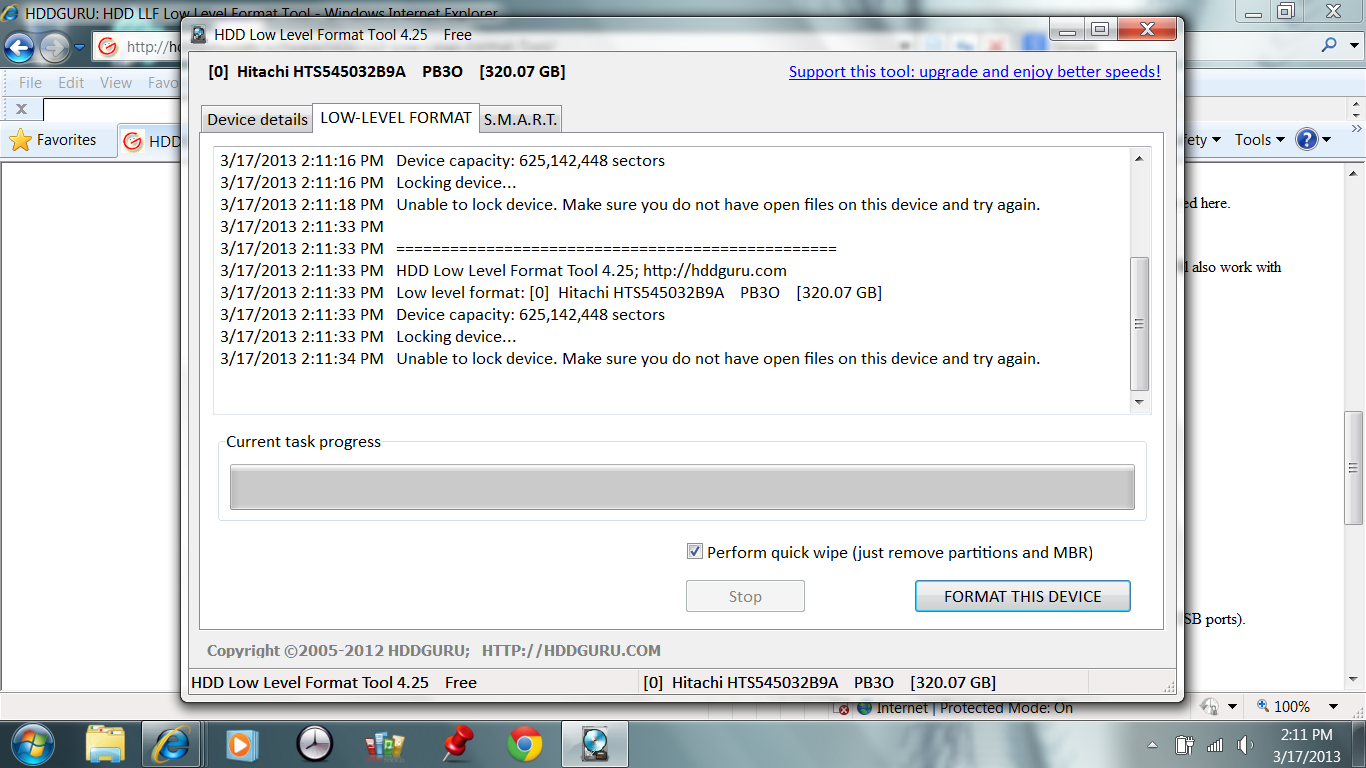

I tried to format my unreadable hitachi USB flash drive (320 GB) using HDD low level format tool. However, I got 'unable to lock device' error (see attached). Please help.
Thank you very much.
Jenny
Unless you have diagnosed the specific cause of your drive being unreadable (and FYI in your case it isn't a flash drive - it's a USB-attached hard drive), then your attempt to use the LLF tool may not be successful. There are various possible causes for a drive being "unreadable", which a software utility couldn't fix... If you haven't done it already, you could look at the full SMART data from the drive, to see if that gives clues about any underlying hardware problem. Also I assume you don't need the data from this drive, as you are trying to completely erase it.
That is a Windows-related issue. Windows is not allowing the LLF tool to exclusively lock that drive. That message means that other software has already got an open file handle on that Hitachi drive. Some anti-virus programs can cause this, so can some backup programs, but finding the specific cause on your PC would need you to find & run an "open files" utility. I've seen one in the past, but don't have the time to search for you now. Alternatively, you might find that shutting-down background programs on your PC, and then retrying the LLF tool may be successful. Or move that Hitachi drive to a different PC and try again.
Hope that gives you ideas about some of your options. There are alternative approaches possible too (e.g. use a different tool or different OS to attempt to erase your drive), but I suggest diagnosing the real problem first, otherwise you could waste lots of time if that drive has a serious underlying hardware problem.

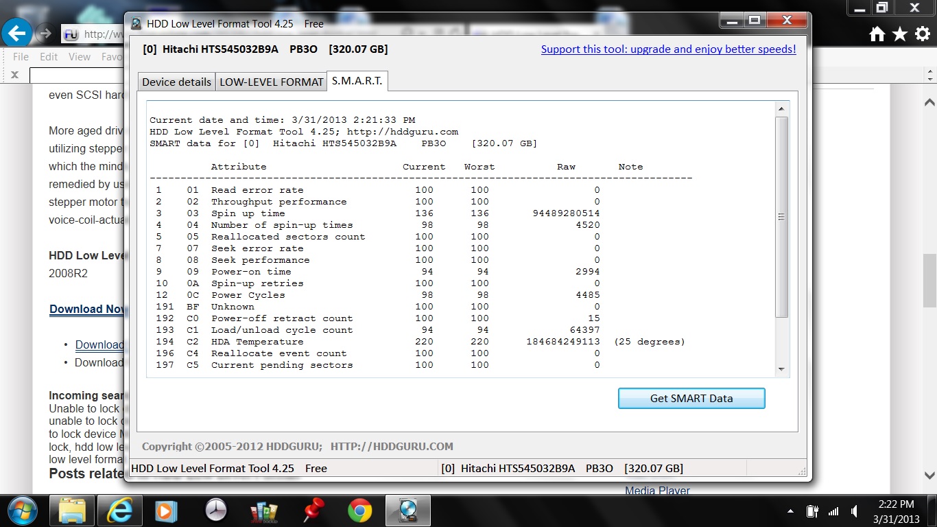

Hi, Expert:
Attached is the SMART data for my flash drive. What is the problem. Please advise.
Jenny
FYI as I explained before, this is not a flash drive. It is a hard disk drive :)
meimei2005 wrote:
What is the problem
I don't see an obvious problem in that SMART data - not all problems show there, but it was worth checking which is why I recommended it.
