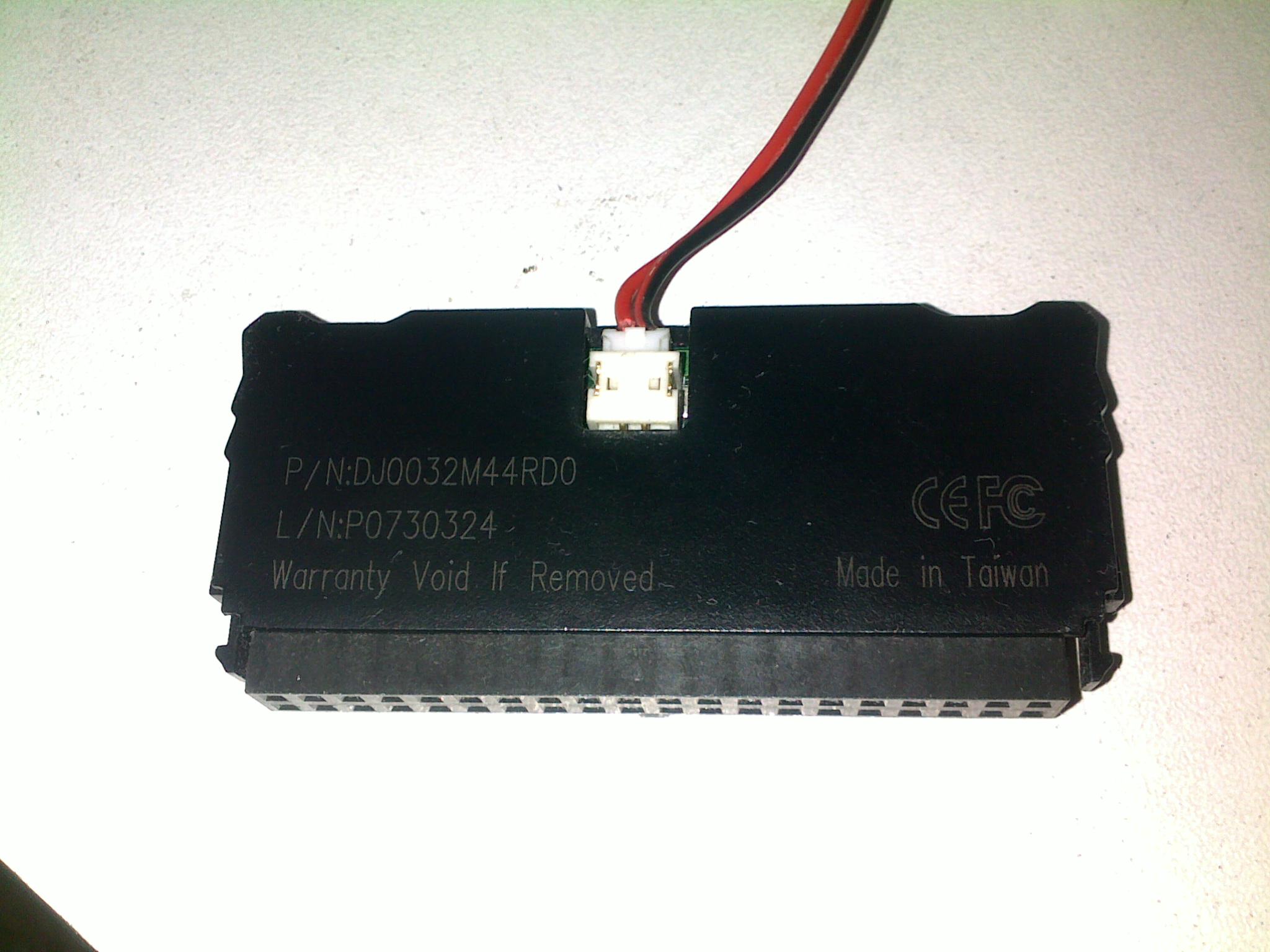

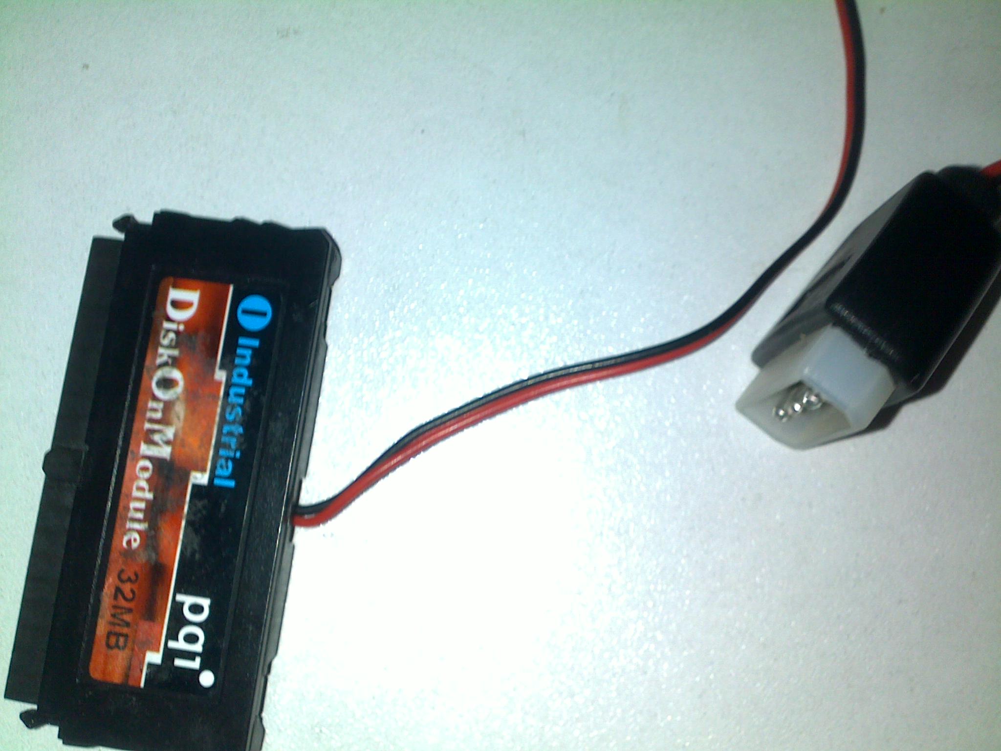

the printer called
z450 printer
http://www.zcorp.com/en/Products/3D-Pri ... spage.aspx
i used ddrescue to get the image , tried several flags and options with no luck at all
am attaching a photo of the disk..
thank you

Are you able to send your disk in to get them to reimage it? I Think it is ludicrous to ask a customer of this type of equipment that much for what is in essence a firmware upgrade, or an OS re-install. Especially as I am guessing it is REALLY expensive.
Actually, do you have access to the community?
Customer and Partner Support
Login to our 3DSCentral-Support site to get the latest software downloads, user manuals, application tech notes and best practices, order supplies, and much more.
you may be able to get some help there.
otherwise, do you have warranty?
If there is no warranty, then you may consider CAREFULLY opening the Module and taking some high res photos so we can see what is inside. I am guessing it is a standard NAND and some kind of controller, and alot of embedded devices dont use a great deal of security/complexity so you may be able to use standard Flash drive recovery options by taking it to a DR Lab.
You can get plenty of DiskOnModule Cards for around $50 - Google search for "DiskOnModule price" and you just need to get the software. And I would be harassing the vendor for this.
By the way, the reason I am not pushing the DR option is because I would not totally trust an Operating system or executable files that were recovered.. MUCH better to re-install or image.
Look forward to pictures :)

 Post subject: Re: printer bootable flash disk with bad sectors ?
PostPosted: July 6th, 2013, 4:59
Posts: 17256
Do these drives support the ATA Read Long command? If so, then you may be able to read the raw data plus ECC bytes. If you do this several times, and compare the various attempts, then perhaps you will see which bit(s) are at fault. BTW, that's what SpinRite claims to do.
Could you upload the 32MB image file (off-site, if necessary)?
If you could upload some photos of the internals, perhaps there may be a way to play with the power supply voltage, assuming it is reduced to +3.3V. FWIW, I have sometimes managed to recover flaky EEPROMs using this technique.
