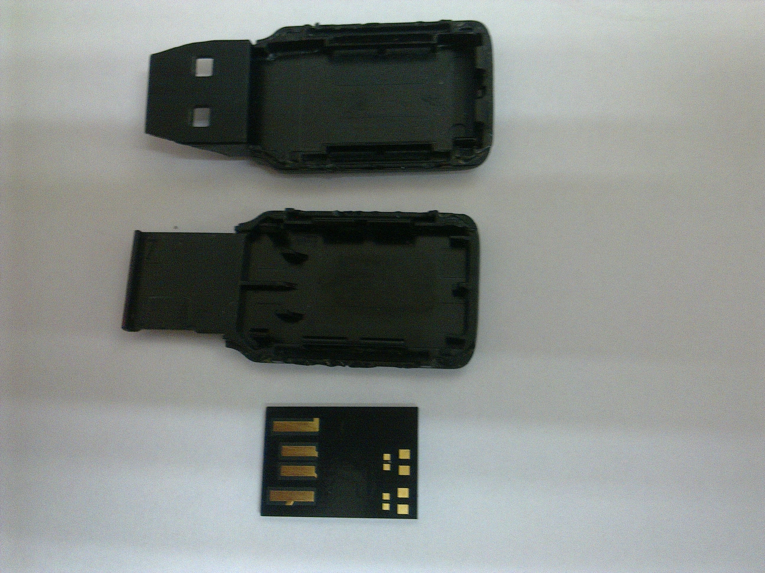

hi,
i have cruzer switch flash drive from client and i have a flash reader. i tried to take the nand chip out but i didn't see it. i don't know where it is. i also attach a picture after removing the case. could anybody advise me how to do data recovery from this drive?
regards,

Does the traces under top layer look like this:
http://www.odzyskiwanie-danych.com.pl/i ... arvika.jpg

you had to remove black cover and soldering wire from USB drive PCB to flash reader.
http://www.rflashdata.com/2461f7010074- ... r-pop-16g/

What they said. And also, if you want to see where the NAND chip is, for a look at exactly how these are made, with good pics, you should search for the links I posted in one of my recent posts, I think in Lounge or flash.
It will show you exactly what you have there.
