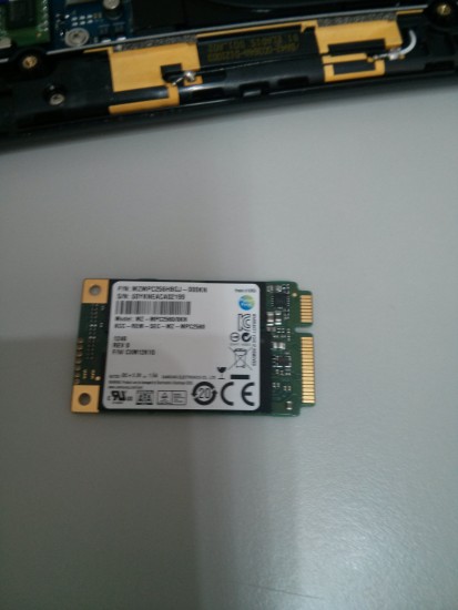

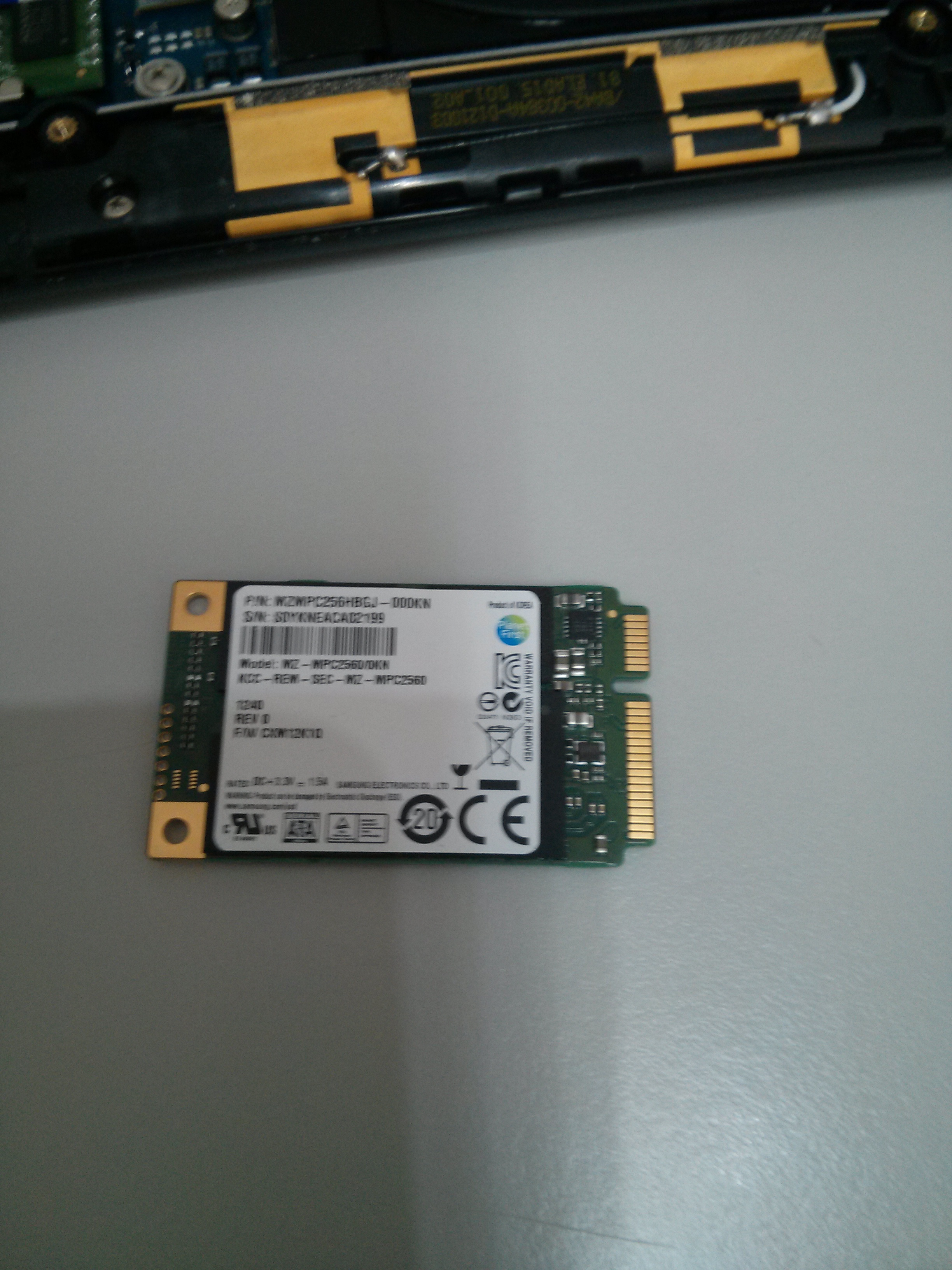

I have this SSD from a Samsung laptop. The OS is corrupted and I can't boot from a CD/DVD to check if data is there.
Is there any way to connect this to a PC to check the files?
Sorry for the quality of the photo, but is still "readable" ehheeh

This should work:
Available there or in eBay

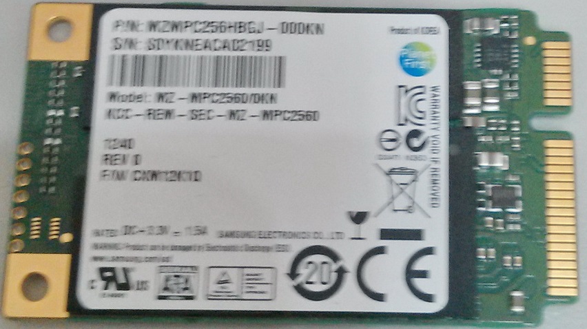

mate, sorry, but I'm in a nit-picky mood, lack of sleep and frustration of a day full of Active Directory and Group Policy hell after driving 10 hours. First thing is 1.8Mb for a picture is a bit extreme, next time could you please crop it and resize? Yes it is hard to read, but a solution would have been to retake the picture, and/or type the text out. Here is what I might have posted as an example:
Would have also have been beneficial to see under the sticker as well.
http://www.pc-3000flash.com/solbase/task.php?group_id=194&lang=eng
http://flash-extractor.com/library/Samsung/
seems possible easy enough to recover same methods as flash drives with ACE tool and SC tool
did you do any research?
cheers buddy

mSATA is electrically SATA.
See pages 12 and 13 of the following document:
http://www.intel.com/content/dam/www/pu ... cation.pdf
According to Wikipedia (http://en.wikipedia.org/wiki/MSATA) ...
"The [mSATA] connector is similar in appearance to a PCI Express Mini Card interface, and is electrically compatible; however, the data signals (TX±/RX± SATA, PETn0 PETp0 PERn0 PERp0 PCI-express) need connection to the SATA host controller instead of the PCI-express host controller."
PCI Express Mini Card (Mini PCIe) pinout:
http://pinoutsguide.com/Slots/mini_pcie_pinout.shtml
Therefore ISTM that a simple passive adapter (except for a +3.3V regulator) is all that you need (as falther has already pointed out).
http://www.addonics.com/products/admsahdd.php
