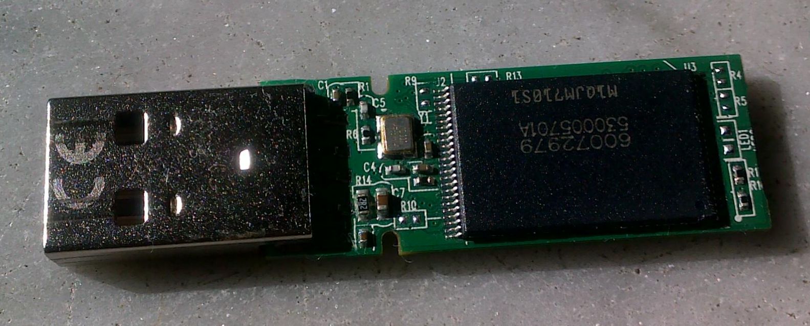

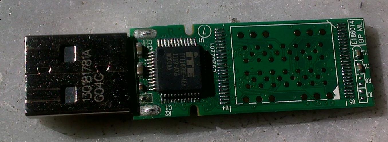

good morning again ,
am attaching photos of the drive ..
i allready tried to image the drive , but i got I/O error ...

Posts: 922
You need read nand flash and recover data directly from dump.

Posts: 3936
+1 Arvika.
This controller is many times used with crappy no-name flash, or intel or Toshiba copies. You may see bit errors and corrupted FAT, but sc tool seems to support it and ACEs probably would.

Posts: 17134
raven4d wrote:
[ 776.672989] scsi 8:0:0:0: Direct-Access XXXXXXXX U167CONTROLLER 0.00 PQ: 0 ANSI: 2
The following thread suggests that the "U167CONTROLLER" string is how the ITE1167BE controller identifies itself when there is a problem. The chip natively reports VID = 048d (ITE Tech. Inc.) and PID = 1167. (The thread discusses how to recover the drive by low level formatting, so ignore this part of it)
http://unix.stackexchange.com/questions ... lash-drive
The following page suggests that a working Adata C003 flash drive should ID with VID = 125f and PID = c03a:
http://usbspeed.nirsoft.net/?pdesc=mama ... &pid=49210
This suggests that the controller is functioning but that the memory has a problem.
